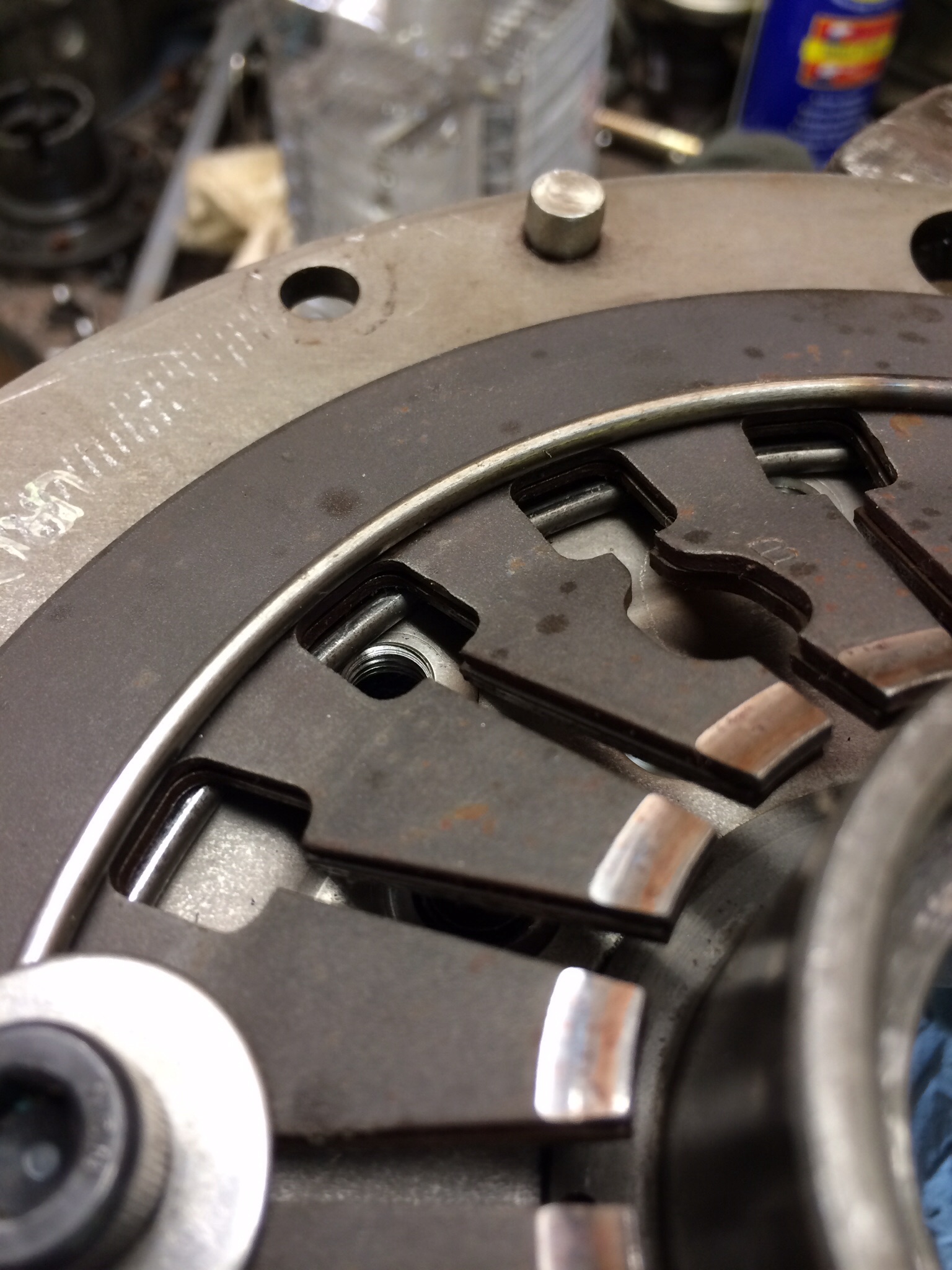

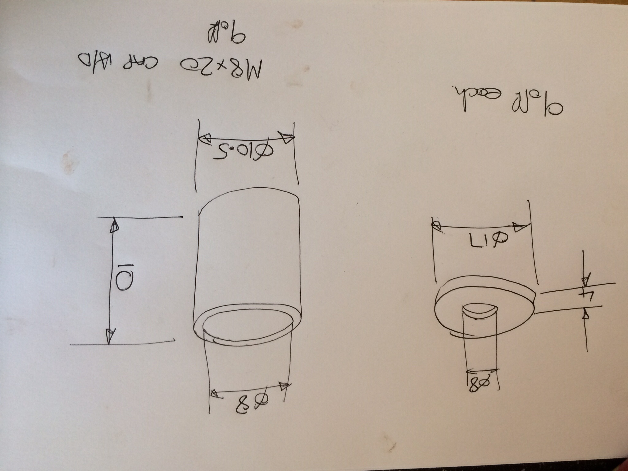

Jonny, here's some pics, as you can see I used Valeo pressure plates (used ones) and as Joe said the holes are bigger than the tapping size for M8, the one I used was 7mm, only 0.2mm bigger than it should be for M8 so I used high strength loctite too, the upsidedown drawing shows the spacers (length equals the total of the two spring plates and the two pivot rings (double check yours before manufacture)) and washers that replace the removed rivets, the washers replace the triangular shaped rivet heads, When I made the bits I made sure the spacers were all exactly the same length just to make sure the pressure release was equal all the way around ( as you can imagine the rivet, now bolt with washer and spacer, is at the pivot point of the movement. And the box is the new friction disc I used from mini spares 190mm. It is a brilliant mod, the grip is amazing, my original clutch started slipping once I pushed past 12psi, I've ran up to 17psi so far and the clutch is spot on. For science per purposes, the old pressure plate measured only 1 mm thinner than the new one and was no way near worn out. The flywheel and pressure plate surfaces are the same ones before and after the mod, although both in good condition.

I use 1/4" NAS bolts which have a low head. Depending on the clutch parts used, it is sometimes just a matter of running the pressure plate in the lathe to give the bolt heads a little clearance.
the best way to check whether the bolt heads are fouling the pressure plate is to assemble it all toghether on the flywheel as you would to install it on the engine and then using the flywheel puller, tophat sleave, some flat bar and a DTI gauge, set the throw out to 6.5mm. The posts of the pressure plate should still be touching the springs and the friction plate should have about 2mm clearance.
