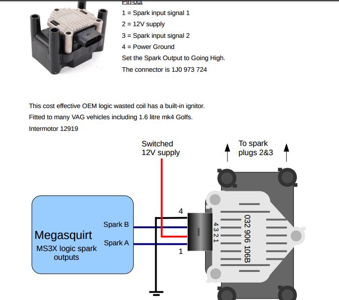

Also I have a coil pack as per attached
On 26th Mar, 2016 Barrieri said:
In particular, what spark and injector channels should I be using on the ms3x ? Is there a particular two channels which I should use ?
Simplest setup to get it running is to use injector channels A & C. Use twice the engine capacity for the REQ_FUEL calculation as you are only using two of the four injector outputs.
With the logic level coil pack pictured you will need to wire it up for wasted spark as shown in the diagram.
In Tuner Studio select MS3X outputs and wasted spark.

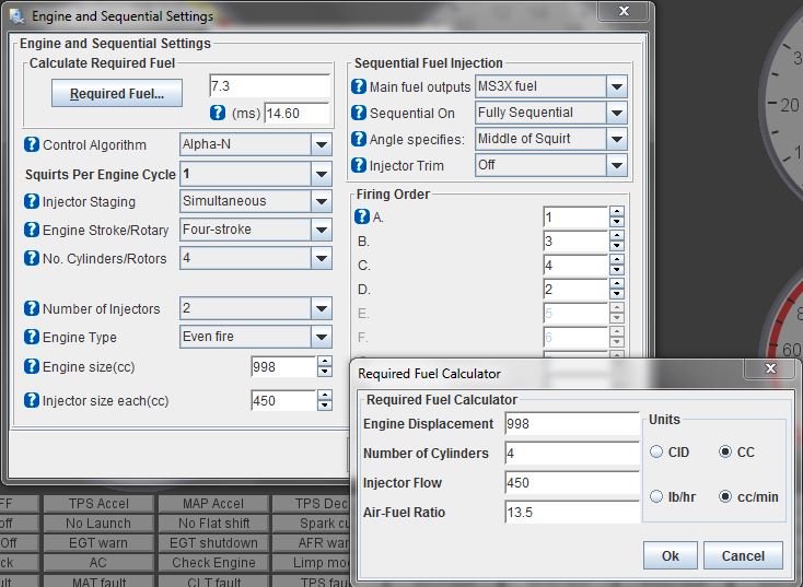

So then I must be doing something wrong. Attached is my setup. My required fuel is 16.2ms if I put 998cc as engine size. If I double it, it comes even larger. The car is running very rich, almost 10AFR.
I guess I need to change to 2 squirts per engine cycle and leave staging as simultaneous ?
You should be using Speed-Density not Alpha-N.
Injectors should be 4, although you are only using 2, the ecu needs to think there are 4.

Once you told me that in sequential mode, you can do with making the ECU squirt one long pulse instead of spraying twice the same injector consecutively. Do you impose that to the ECU in the above tab by "1 squirt per engine cycle" and "simultaneous" ?
This is the method to apply one single squirt to fill 2 cylinders.
The next stage would be to connect channels B&D to the injectors and fire the same injector twice. But for now, whilst you get all the other settings sorted, this would be the best method to try.
Once you have set the ecu to fully sequential, it ignores the "simulatneous" setting.
