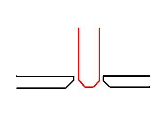

No you need to do the plate and the casing really. Done properly you shouldn't need to weld on the inside.
2 min I will do a sketch - black is casing, red is new plate. Prep allows a root run which will give penetration to the inside. Then capping runs to build up to the surface.
Edited by Tom Fenton on 2nd Feb, 2012.
I agree with Tom, you should be able todo this your self, I'd make the root face around 3mm, and go in with about 120 amps, which should give you good root penertation. Then bang the amps of the the next run, then finally big amps again for the capping runs.
