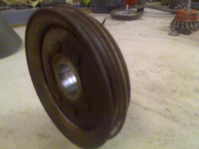

clubminiflip
1840 Posts
Member #: 54
nr coventry
this is the pully on my 998, what method of trigger wheel should i take?
Jay#2
2500 Posts
Member #: 648
Northern Ireland (ex AUS)
I have had those come apart as they are only riveted together and not the strongest things in the world. It would be a shame to set everything up with one of those and have it fail (I'm not saying it will). I know Minispares sells new 1275 ones that are what most use for MJ etc.

RogerM
2514 Posts
Member #: 1217
I like nice quiet girly Minis
Cheltenham, Gloucestershire
I think you'll be better off with a 1275 type pulley to. Second hand one maybe???
998 Metros use a pulley with a damper that can be machined. I'm using one on mine.

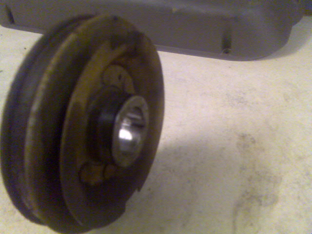

clubminiflip
1840 Posts
Member #: 54
nr coventry
now i know this does'nt seem to be the done thing but i think i'm gonna take the option of a bolt on/tack weld on trigger wheel like the pic below, plz advise, what are the benefits of the dampered pulley?
danboy
715 Posts
Member #: 1381
Can you get a socket on the crank bolt?
