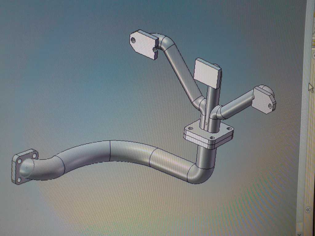

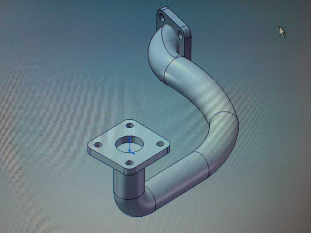

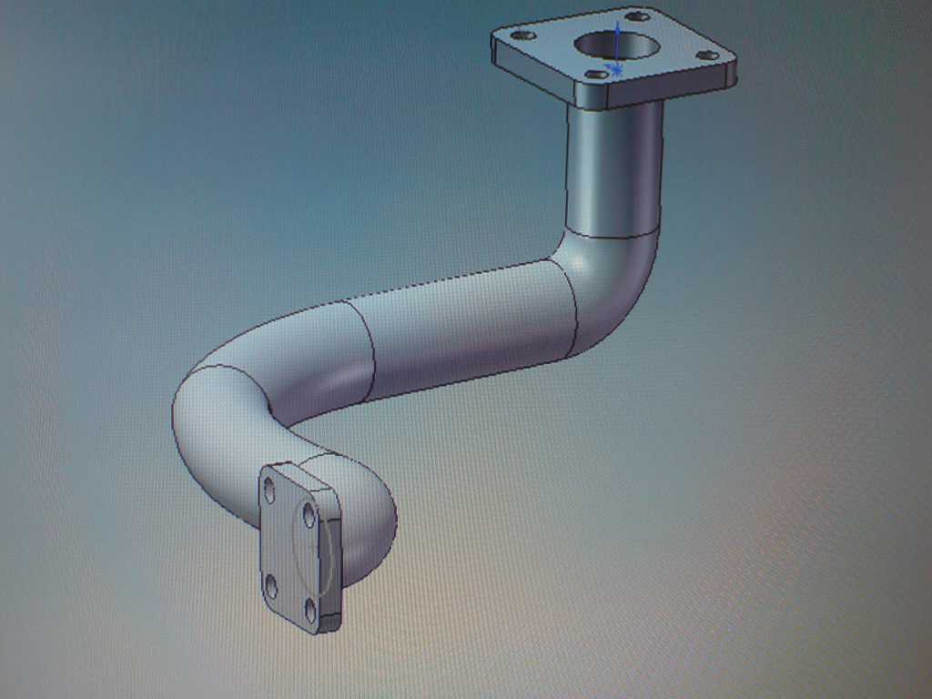

Was dicking around on solidworks today, and came up with my design for the joining pipe between manifold and turbo for a clutch housing mounted turbo.
Guessed a little with the manifold flange, as i still not sure what i'll be using as i can't find a std turbo one on ebay.
but the turbo flange is for a little IHI turbo from a charade GTti.
998 turbo in progress.... DONE..........KNACKERED LOL

Yeah was looking at the Mpi ex manifold, but was really holding out for a turbo one with a neater flange, has anyone got any pics of one?
The pipe just requires a different turbo flange to mate any turbo i suppose, so T2 or T3 or whatever......
I was going to send the exhaust pipe from the turbo through the brace bar and into a little bike can behind the a panel exiting just behind the front wheel.

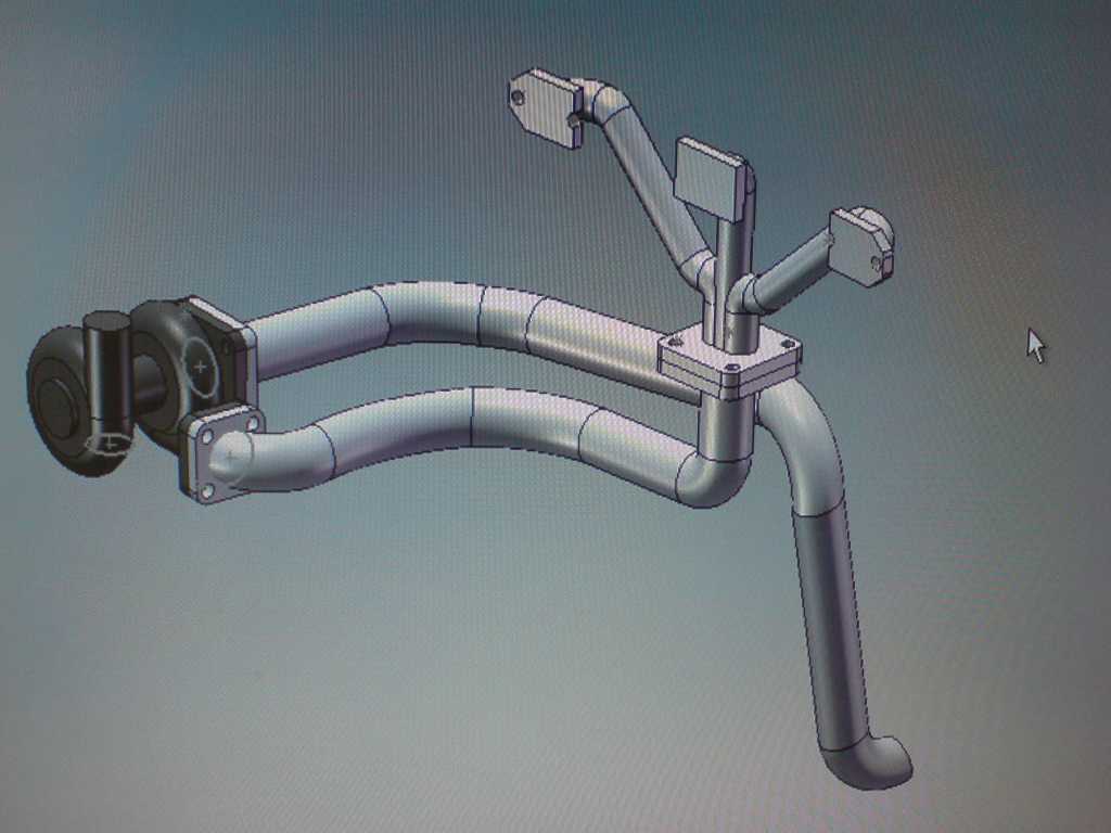

just added a mock up manifold to see what it would look like attached. I'll try to do a basic turbo to stick on the other end.

Chappers, don't want to piss on your Bonfire but that manifold will not fit on any Mini. The turbo would be situated right at the end of the crank / engine mount area.
To fit where you suggest it will the pipe would need to sweep upwards by a considerable amount.

cheers for your suggestions guys,
danboy, yeah i see what you mean, the manifold is just a rough drawing at the moment, not took any proper measurements yet, but that the beauty of CAD, when i do take some i'll just edit the dimensions and the drawing will change itself.
RogerM, yeah i was unsure where to route the exhaust, thanks for the advice, think i'll route it down the normal route under the car then.

added a mock up turbo and a down pipe. still not dimensioned correctly yet sorry.
