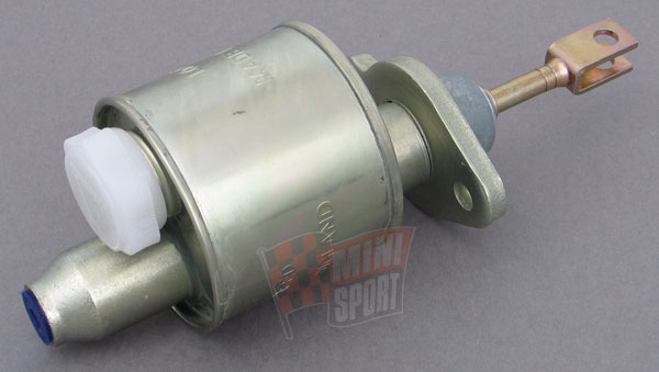

yeah they look like you have spacers in front. by the way will my master cylinder do the job? its the one like a baked beans can. (see attachment)

yes mate - will tone your legs up too lol. tbh wish i had one for mine, but knee problems mean i need a servo

there's 2 different sized bean can's.
one i think doesnt contain enough fluid to operate the brakes correctly, the other is a bit bigger and is fine.

mine slike the one in the attachment

Either size work fine, the taller one is a cooper S type, internally exactly the same, only difference is it holds more fluid, so that if the pads are worn right the way down without the fluid being checked, there is enough capacity so that the master cylinder will not introduce air into the brake hydraulics.
If you use the shorter type with disc brakes (even more so 4 pots) just ensure you check the brake fluid periodically and top up if reqd.
