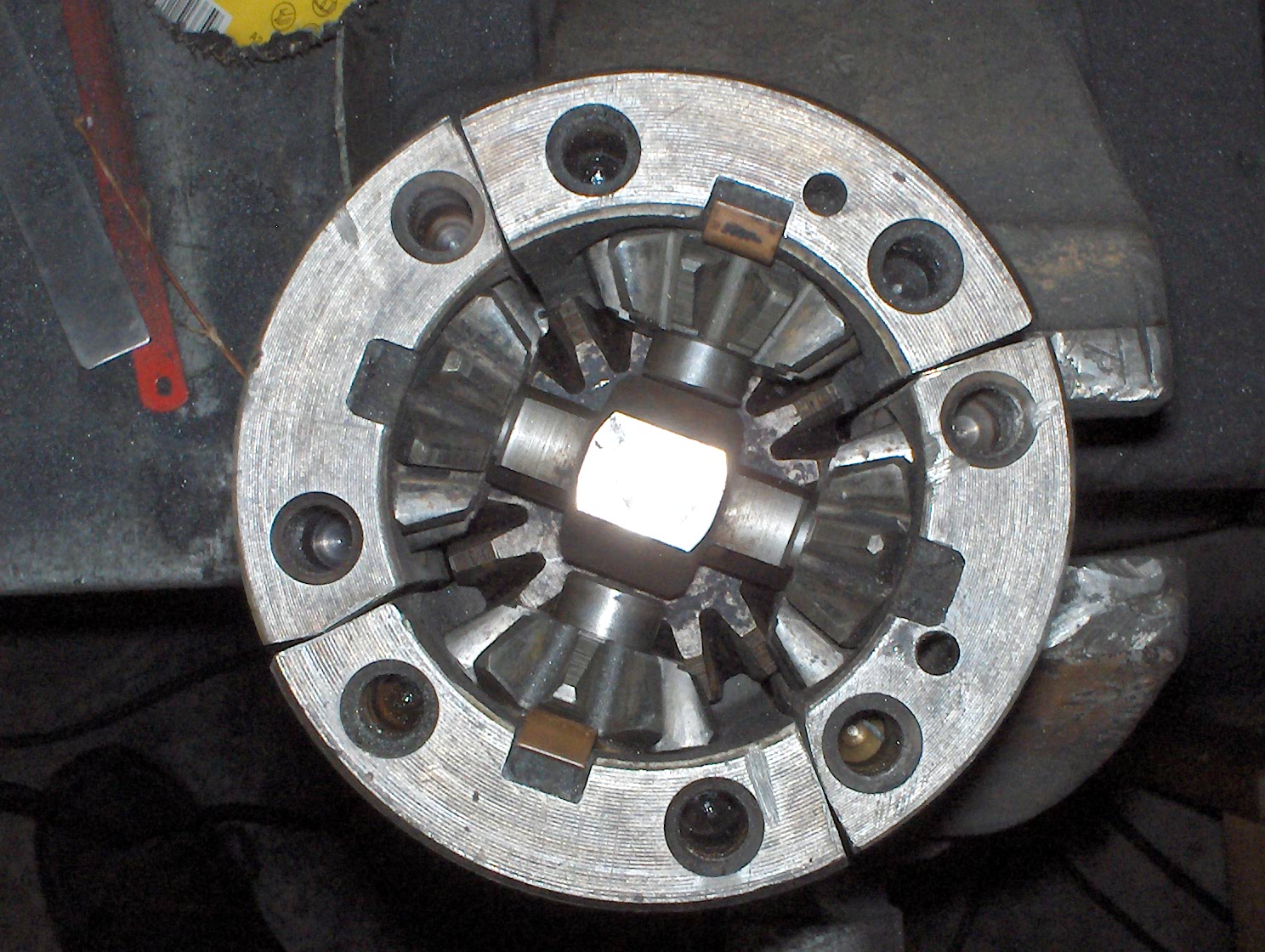

er....look what happened*blush**blush**laughing*:

WTF! How/what did you do to that?

Love it.
Another new creation from Robert.
Do you think you can weld it up OK?

Interesting.
Are these NLA once again or somet?
90-degree on the planet pins is not the best solution however - reference the latest generation of cross-pin diffs.

thanks axel ,
um time will tell welding wize , im thinking of old school arc with a special rod ,it seems to grind like forged steel and the marks on it support that ,as long as its not cast iron ithink itll be ok !!!:)

dave it was more oh dear short of money what can i do for nothing lets try a new idea sort of thing!
i can move the piece to be welded around the circumference till its at the angle of the new diffs , i think its 5.5 degrees do you know for sure ?
I would count the number of teeth on the output shaft, divide that into 360 then divide by 4.

im going to run the planets round till they run smoothly axel ,and are not at 90 degr ,that will mimic the later evo ones i feel ,its very obvious when they arent runnig smoothly cos they arent meshing properly ,then weld them there .

I might be over thinking things again but would you not need to pin the two stubby pinion shafts to the cross shaft to gain enough rigidity to make a real difference?

, i know there are a certain nos of places where all the gears will mesh ok ,and one of them is at 90 degrees ,so ill just move it round the clock one segment till its smoothly running again ,and that ll be where it welded !

well roberd you will mhasve most certainlty created an LSD by the time you weld that lot up, there will be so much distorsion that the planet gears will either struggle to ,or refuse to rotate on there shafts, thus creating the lincoln diff scenario,[planet gears wedged up tight together , creating friction .]
but top marks as dave says for thinking.

definately true roger ,this stage in the proceedings was simply the result of idea at lunchtime ,angle grinder for an hour after lunch ,
my plan is to tig a big support on each side of the planet spacer ,and i mean big as i can ,with a lot of tig .this part is vital

yes that could well be true carl ,,time will tell , im thinking that ,with it all bolted tight to the ring gear ,it will maybe could be stay straight ,
still thats what research is all about ,finding out what doesnt work !

hmmm i think this may be a dead end .if you have to buy all the pins ,planets and washers etc ,it works out at around 75 to 90 quid ,so you save 80 quid ...but....its not a dead cert .. i was thinking i can get some good planets from stuff down the yard etc . I DONT THINK SO !!
now taken 3 diffs apart ,all the planets are sad sick or on thier way there so its not looking too viable from a cost /worry quotient !
see what i mean .*frown**oh well*
