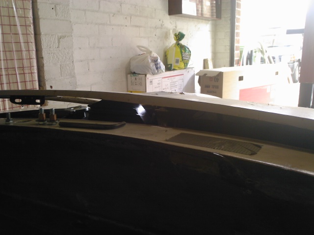

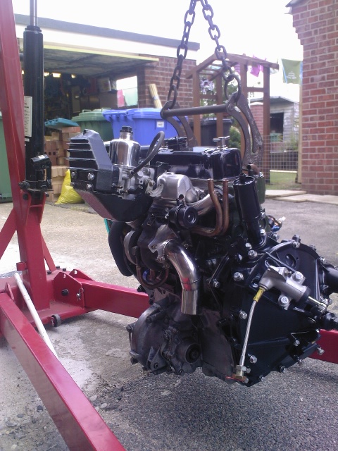

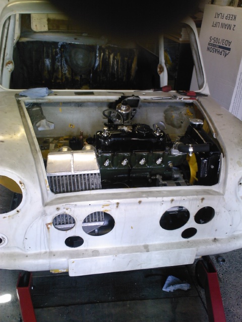

Right, after months and months of banging on about it, and picking your brains with my probs and queeries, and after a productive day in the garage I thought I would reward you gents with some pics.

Looks good, post some more pictures.. :) what you planning on doing with the bonnet. Always loved the Minus look.
28th Jul, 2007 at 05:20:45pm
re the bonnet, you could...
2646 Posts Member #: 1246 Post Whore Lowestoft, Suffolk. |
28th Jul, 2007 at 05:21:18pm

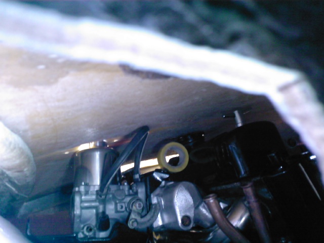

I was planning to cut a grp bonnet 2" in to the bonnet along (parrell) the bonnet to wing pannel line from the start of the rounded section at the front to the rear, lift the now created "flap" so I clears everything it fouls, then fit a fibre glass patch at the rear and flush it all smooth, the idea being hav a not too obtrusive bulge, the smaller the better as its a mk1 cooper theme, want it as period as possible!

Unfortunatly its not just the plenum, its the carb, radiator and cap, and my intercooler piping will also foul, hence my idea to raise the main surface area of the bonnet and get to meet with the wings as normal, therfore achieving a little more room. Hope that makes sence.

Have a go with a cossie 2wd intercooler, seam to fit perfect. Keep us posted on the progress ,looking good. |

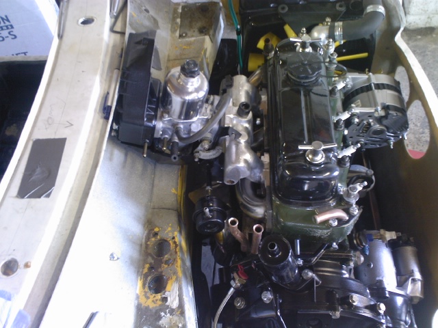

didnt they used to use stromburg carbs in minus's as they werent so tall? could one of those be sealed for turbo use?

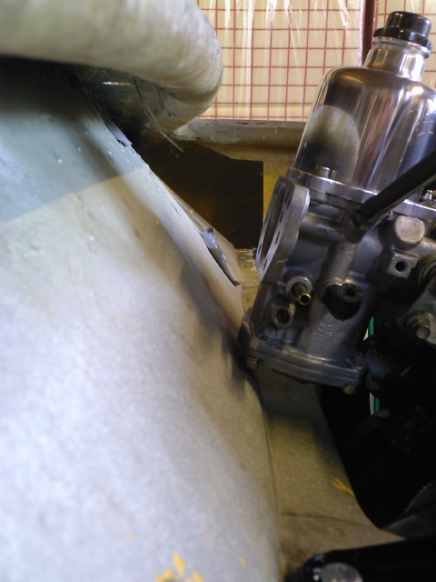

All good sugestions, thanks lads, if I was to use the n/a inlet i would then end up fouling the bulkhead as it is very close to the fibreglass heat shield fitted to the carb. I really would like to hide everything under the bonnet with no bulges, but not sure if its too much to ask!?

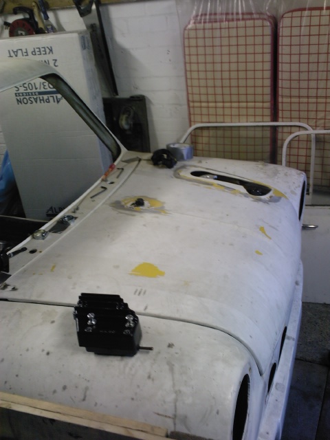

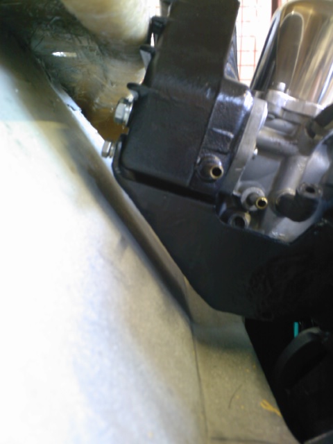

Right, been in the garage again tonight, trying to think of a solution so I dont have to have a huge bonett bulge.

The minus's dimensions are vey odd compared to a steel mini, eg I have seen steel minis fitted with a mirrage manifold and the t2 sits close to the bulkhead, but with the minus I have the mirrage manifold and T2 on and I have enough room for a family of badgers to nest down the back of the engine, but inturn the space at the front of the bay is greatly less! Shane. Some subframes are different to others, i think spi/mpi subframed have the engine mounts about an inch forward of their usual position for all the injection gubbins etc. "Turbo's make torque, and torque makes fun"
30th Jul, 2007 at 11:04:28pm
Been there already fella, my minus uses the mk1 dry subby, I did look into an auto subby to see if it sat lower, ended up using the one I have and adopting the Ill worry about it later attidue.

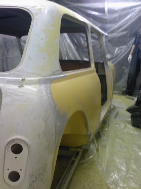

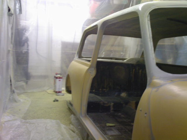

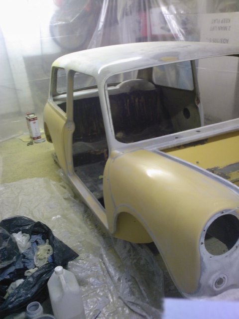

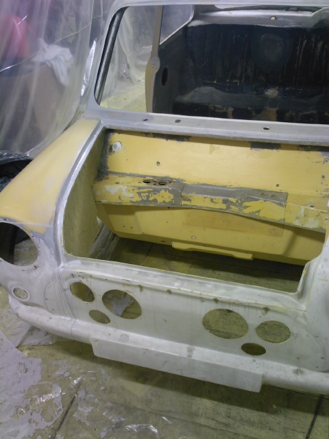

Have managed to get a few hours out in the garage in the last two weeks (much to the missis dissaproval) and have seemingly made very little progress, well I have made progress, but it just doesnt look like I have!

I don't envy your task, bodywork prep is bad enough with steel, fibreglass is about 20 times worse, as I found out the day I helped a mate doing some work on an old TVR..........
17th Aug, 2007 at 12:48:44am
Lol, ONLY 20 times?? I cant wait for it to be painted, a milestone I cant wait to reach, I honestly dont know how Mark did it for a living for so long? Its been ok working on it thiss week as ther has been two of use, plenty of chat and brews aplenty! but last week when tinkering on my own, IT WAS BLOODY TORTURE!! We have broken the back of it now tho, (well thats what we keep tellin ourselves)

Nic is on the case re my plenum problem, and Im planning to raise the back edge of the bonnet to allow a little heat out, with this I should get away with a std grp bonnet.
On 18th of Aug, 2007 at 03:16pm mini13 said:
How about relocating the carb? also, you could chop the rad neck off the radiator and solder it up/ solder in a hose adaptor and have a header tank somwhere else? |

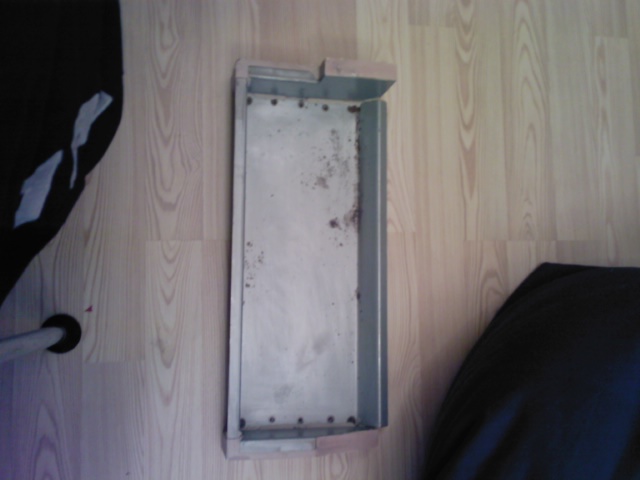

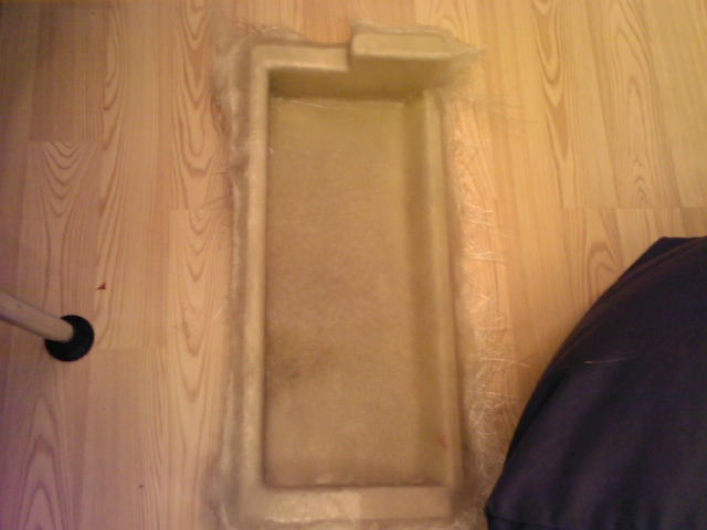

I got fed up of fibre glass so I moved onto paint removal, now fed up of that so now back onto fibre galss, got my bulkhead box layed up, the avon bar box was used as amould, now hoping to fit before the weekend, lol yeah right as if thats going to happen!
