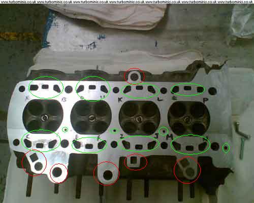

Excuse the noob questions, but in the picture I have attached, I'm sure all green galleries are water, so I asume the red are oil? You seem to have made a few mods to the cyl deck, what have you done there? How you planning on routing the the oil feeds to and from the head? Will be investing in the SC build guide soon.

Im a noob myself, just learning as I go..lol
Blue is the water
Red oil feed
Green oil return
You can see a faint outline where the 2 oil drain holes (green) have been plugged and drilled. The right hand side of the pic you can also see a faint line where the blanking plate has been welded in to seal the head to the end plate.
Edited by matty on 2nd Aug, 2007.
