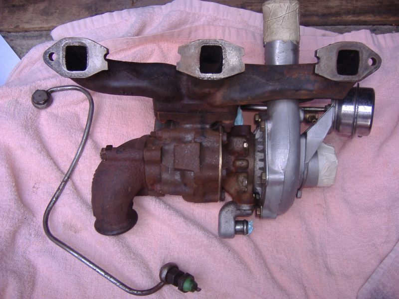

Am I correct in thinking the part on the left is an oil feed for the turbo?
13th Aug, 2007 at 09:34:42pm
Yes it's the oil feed. It should reach the oil pressure takeoff with ease if routed correctly. Fastest 998 mini in the world? 13.05 1/4 mile 106mph

hmmm, i ordered a turbo oil supply from minipart.co.uk, the kit came missing bits, and the threads for the block and turbo banjos were wrong. Ended up having to buy the missing/incorrect bits from avonbar.

Oil return is about £15 ish from Avonbar. (thats only the silicon hose) you'll also need the fiting on the block! https://www.facebook.com/pages/Fusion-Fabri..._homepage_panel

most use the std metro turbo item i guess, but making one from a fuel pump blanking plate should prove easy enough, its only a pipe sticking out of a plate
249 Posts Member #: 513 Senior Member Sheffield |
13th Aug, 2007 at 11:26:04pm
Ahh so really I just need to get a T-piece fabbed up for the block and same for the feed on the turbo and blanking plate for the return.

get the stuff from Avonbar.

I plumbed mine in like that and found that the more air I bleed off the less boost it showed on the gauge (but I was actually running more boost) Edited by matty on 14th Aug, 2007. https://www.facebook.com/pages/Fusion-Fabri..._homepage_panel
14th Aug, 2007 at 01:33:57pm
Bosst gauge shoud be fed from the manifold Fastest 998 mini in the world? 13.05 1/4 mile 106mph
![]() 1566 Posts Member #: 36 Post Whore Basingstoke |
14th Aug, 2007 at 02:11:54pm
yeah, you'll only see boost no vac if it's before the throttle butterfly. Like matt says, use one outlet for actuator and the other for bleed valve. |

Whilst on the subject of oil feeds what size do we reckon is needed for a turbo? would -3 be big enough bore?

I had Hose solutions make a feed hose up, as i'm using a IHI RHB5 turbo, i found them on ebay
