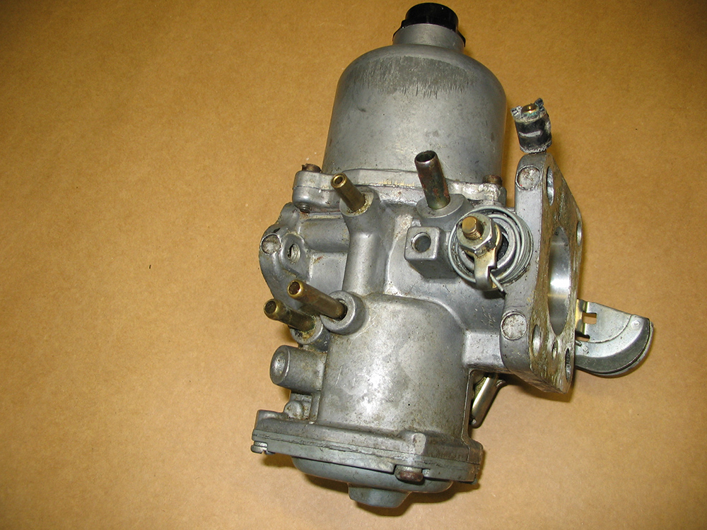

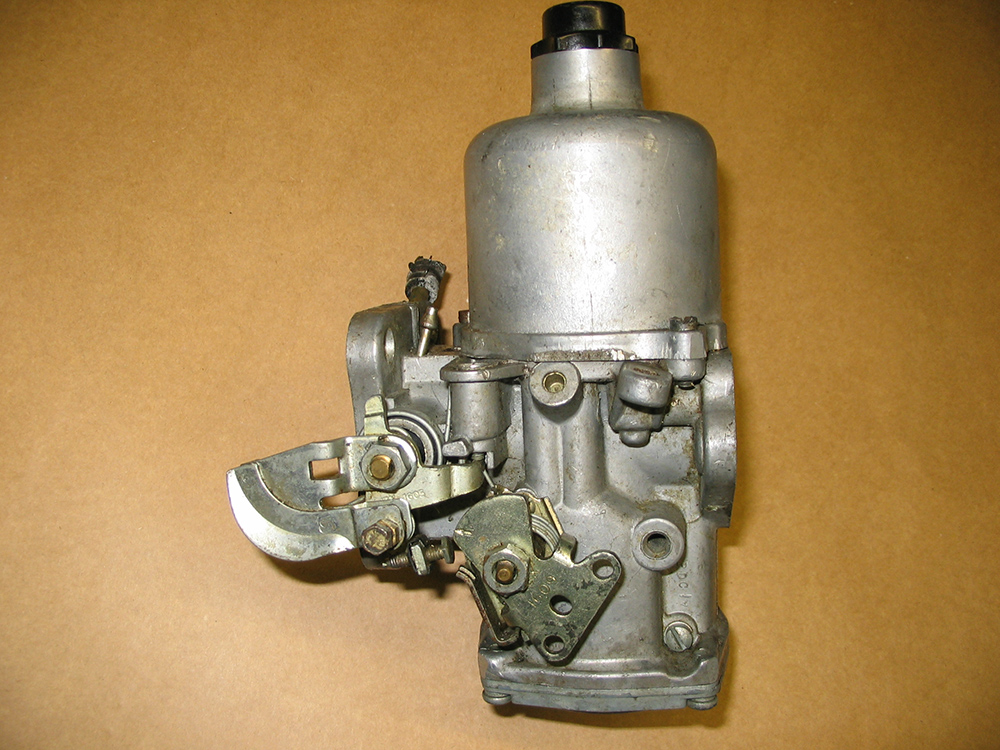

Thanks, Ive got a carb im going to list on Ebay and just making sure its a turbo one. Would you say this is a turbo carb ?
Thats most definately NOT a turbo carb.
Oh well thanks anyway, I was told it was because of the extra pipe on the side but thought i better check first *oh well*

Nope, not a turbo carb.
Turbo carbs usually have a clamp around the dashpot plastic screw top with a matching groove to secure it.
Dashpot screws are usually a domed nut type thing, not straight head screws as per normal carbs....Although any I had, I changed to Normal screws for ease of removal.
