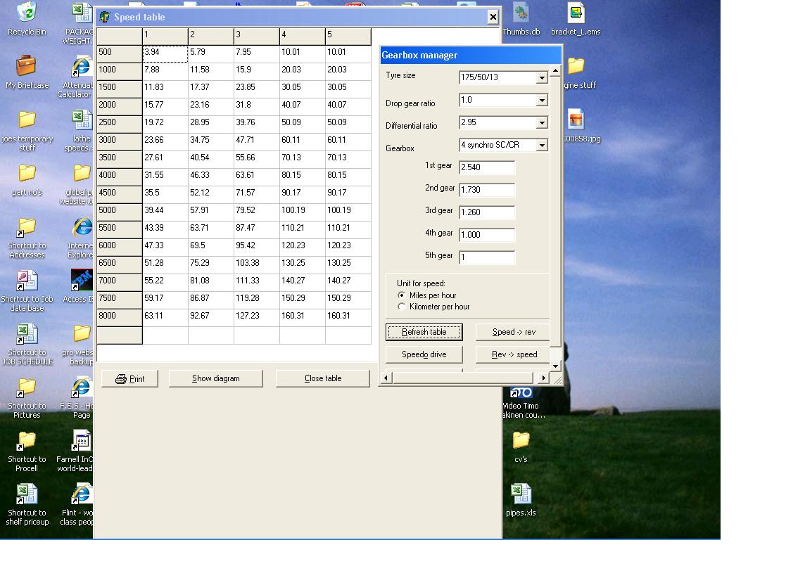

maybe this will help...

9th Oct, 2007 at 07:48:02pm
2.95 is goof for a road going turbo'd car.
