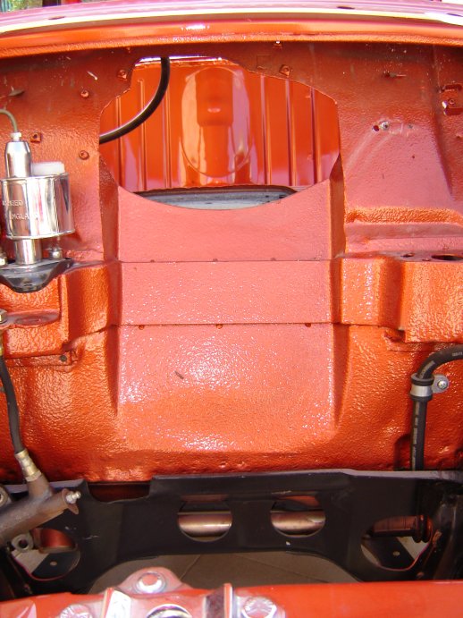

Well this is how I did mine and I dont think it'll be any worse than it was before the mod. Certainly worth spending a bit of time to get right.
redwing
