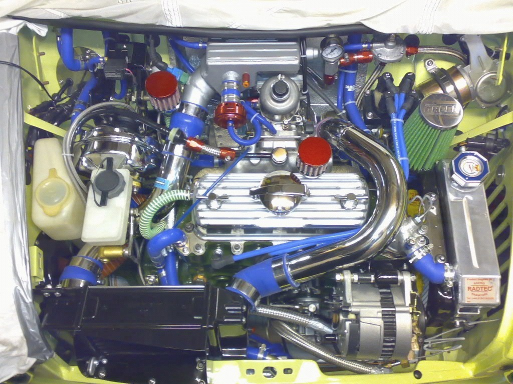

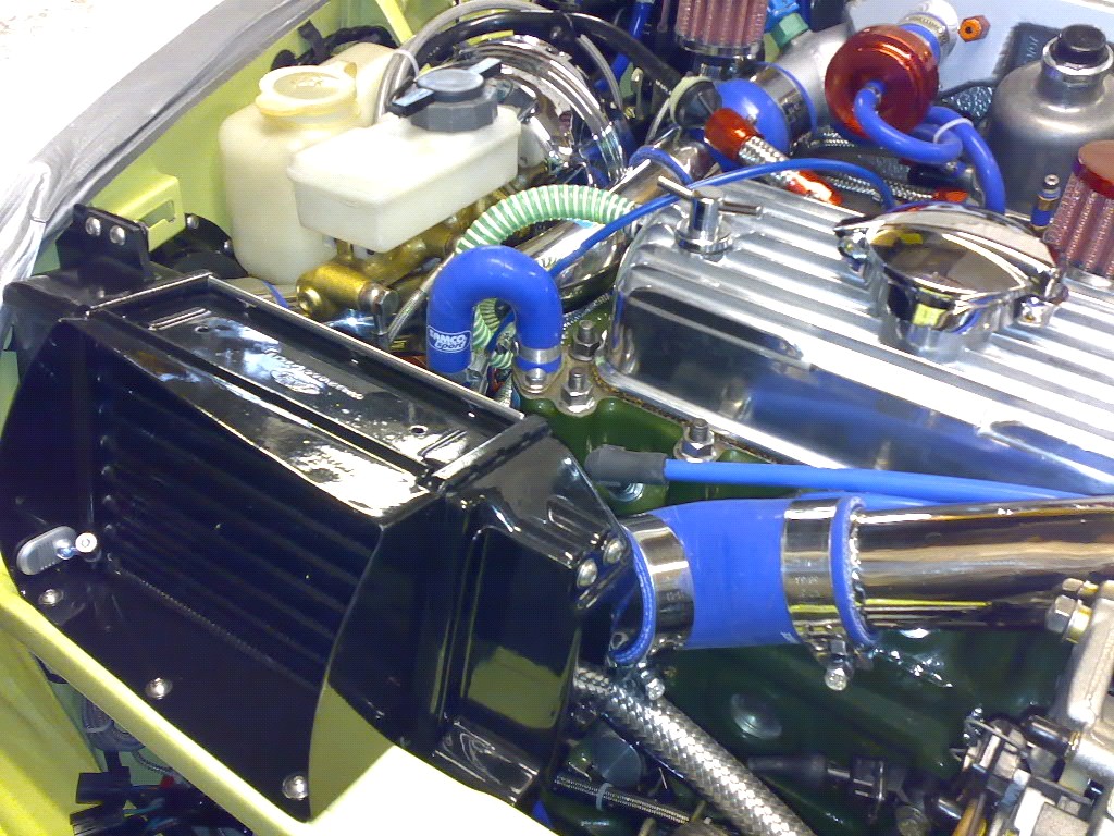

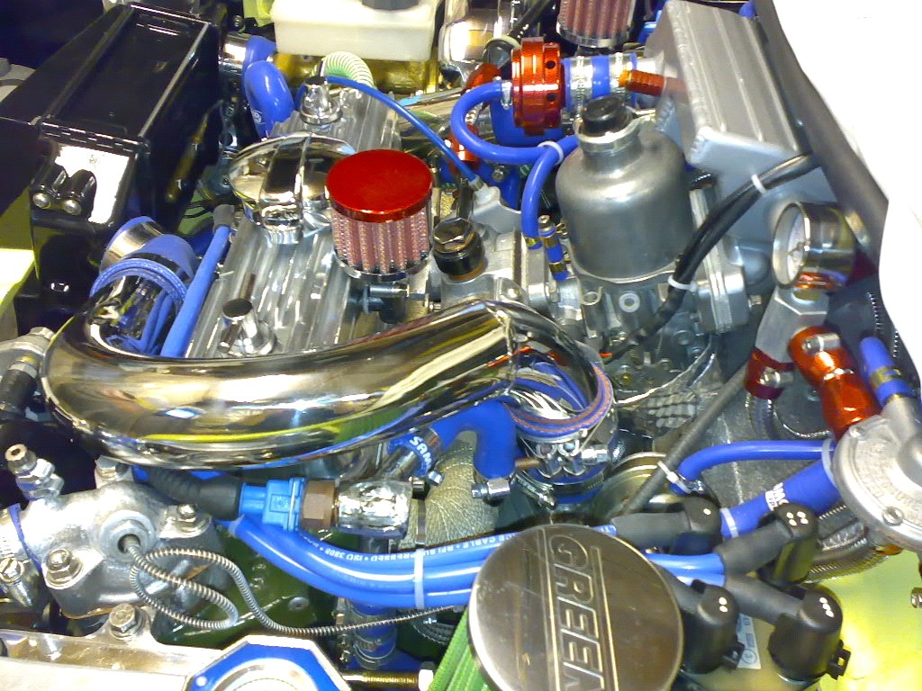

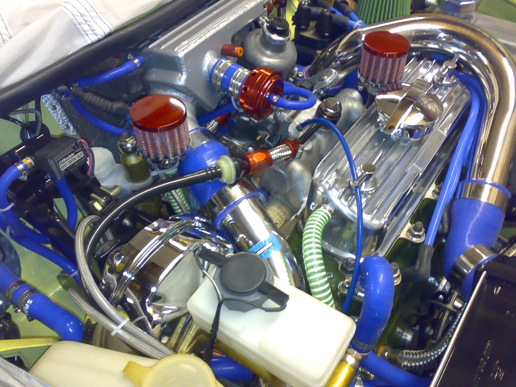

If they're of any use, I've attached pics of my cossie intercooler installation.
I haven't needed to remove the i/c headers but have used some Stainless 2 inch exhaust pipe bends to make up custom delivery and return pipes which use smooth radius curves for lower flow losses and hopefully reduced turbo lag. The i/c is mounted on a couple of sturdy brackets and there's a temperature bulb on the back which sends a signal to a gauge on the dash.
Should be ready for first light in a week or so.
Richard.
Nice installation, that's not a 2wd cossie intercooler though, its a series 2 Escort RS one.

is that a cossie or an rs turbo intercooler?
beat me to it *laughing*

That's one seriously nice looking engine bay!
But that intercooler is an Escort RS Turbo one, a Cossie intercooler is twice the size of that!

Yeah ok, well spotted.
You're right, the cossie one is really long isn't it..
Sorry guys.
