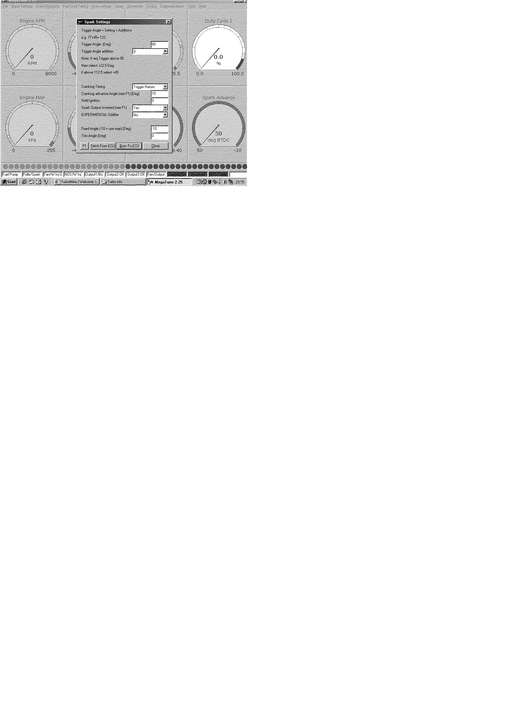

Phil set my ECU up for a 60 degree trigger angle with a 0 degree additional angle and a 10 degree cranking advance angle.
Is this correct for my sensor and trigger wheel setup at 90 degrees ?
The other idea I had was to temporarily disconnect MS and the coilpack and install a dizzy and amp to get it running then I can at least prove the thing fires on standard settings.
If there's anyone with a MS wasted spark setup near Bath I could visit or call for a chat, I'd welcome the opportunity. My mobile numer is 077 1971 4999.

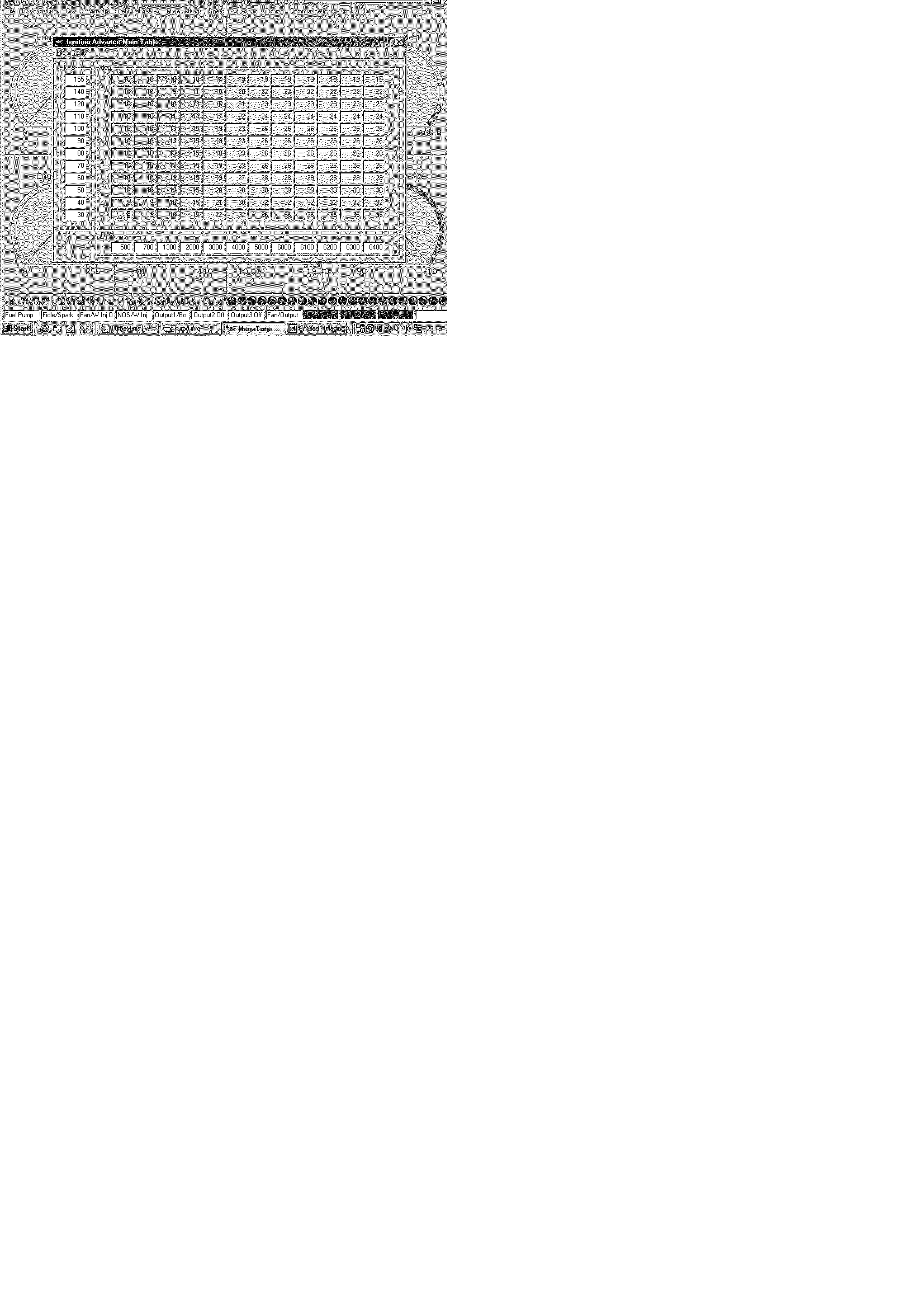

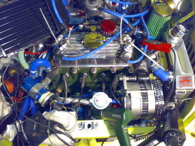

I've attached my Spark Setting and Spark Table screenshots along with an engine bay phot.

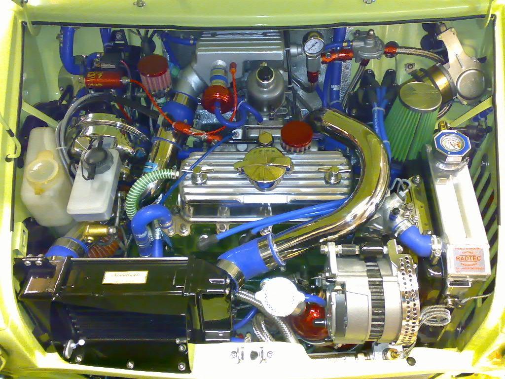

So much f.....g time wasted having got my build finished already (see attached phot) then having to take everything apart again.

Oh and i forgot, thats a cracking looking engine bay!! whre did you get the rad cap? I want one!
blimey ,thats just toooo shiny ,
i think it would be totally unfair to have an engine bay that looks that good ,and have it actually run as well !!!
having said that , have you done the test with one wheel in the air ,and seen where on the crank pulley the sparks occur with the edis ?

In the first screen shot it has the ignition output inverted, is that right for your setup?

If you are running MS1/Extra with a directy connected VR sensor and coils, then you need to get your head around this:
http://www.msextra.com/manuals/MS_Extra_So...al.htm#Sparkset
I think that the 90 degree setting may be incorrect with MS1/extra.
In MS2/extra, I have to set the trigger angle to 80 degrees with the sensor at 90 degrees BTDC. Something to do with how it reads the teeth.
I would get the engine running on the dizzy, with the MS, VR sensor and wasted spark coil connected and operating. Check that the MS is reading rpm with Megatune. Then get a HT lead and a spare spark plug, ground the plug and fit the timing light. The timing light will then show you exactly what is going on.
My guess is that you are running 10 degrees too much advance.

I'd also go with 5 degrees cranking advance, once you've got it working :)

Long and short of it was that the Trigger Angle, despite having a 90 degree physical relationship between the VR sensor and TDC/TDC missing tooth, was about 30 degrees too retarded. The engine was trying to fire at 20 degrees ATDC on the power stroke !
Although early days, I really only managed to discover this once the engine was started on the dizzy with a spare set of plugs being operated by the MS ECU grounded out against the rocker cover - worked a treat (hopefully photo attached showing the second set of plug leads strapped to the rocker cover).
There's still some fine tuning to do before proper running but I had to run at a Trigger Angle of 60 degrees rather than 90 in order to give me a firing setting of 10 deg BTDC.
Firstly, got the engine firing on a std Mk1 MT Dizzy setup and set the timing by strobe to exactly 10 deg BTDC advance. Ran really sweet for a good 10-15 minutes at 2000 rpm (recognising I've got some more running to do yet to bed the cam in).
With a second set of plugs connected up and grounded out on the top of the rocker cover with MS running effectively in diagnostic mode, I used a second strobe lamp to verify the difference in the dizzy timing marks and the MS timing marks. There was a bloody great difference which I had previously not been able to spot at cranking speed - there's the crux of the issue really - not being able to see this effect at starter crank speed, even with a 595 Amp fresh battery !
Once the dizzy HT leads were replaced by the MS plug leads and I'd added some advance to the MS Trigger Angle along with taking the crank width setting from 10 to 5 degrees, she started first turn and then ran for 5 minutes without a beat until one of the coolant hose clips disappeared across the workshop in a cloud of steam. Dooohhhhh !
