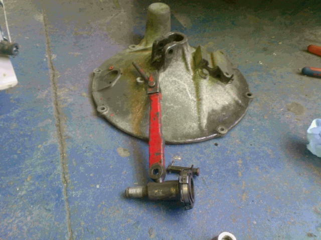

Just managed to dig out a wok with pre verto arm etc, removed the plunger but am unsure if its correct, also the release bearing looks like a verto. What do you think?

Looks like a verto bearing to me.

I'd say it was pre verto from the pics.
The verto bearing is usually smaller in diameter.

You can tell by the length of the spiggot on which the bearing sits
A long spiggot is pre verto and shortish one is verto. That one looks quite short i thought

I thought it looked the same as the verto bearing, im now headed over to te workshop so will take a camera and get some better pics.

Took a verto wok with me to compare, and the plunger and bearing look the same, what do you think? Would the clutch of opperated with a pre verto arm on a verto plunger? No idea if the engine it came off was running this wok with a verto or pre set up under it?

Better pic of the one im trying to identify
Verto wok
Verto release bearing
Both side by side.

Thats a verto - looks identical to the one I took out of my wok to replace with my pre-verto setup.
