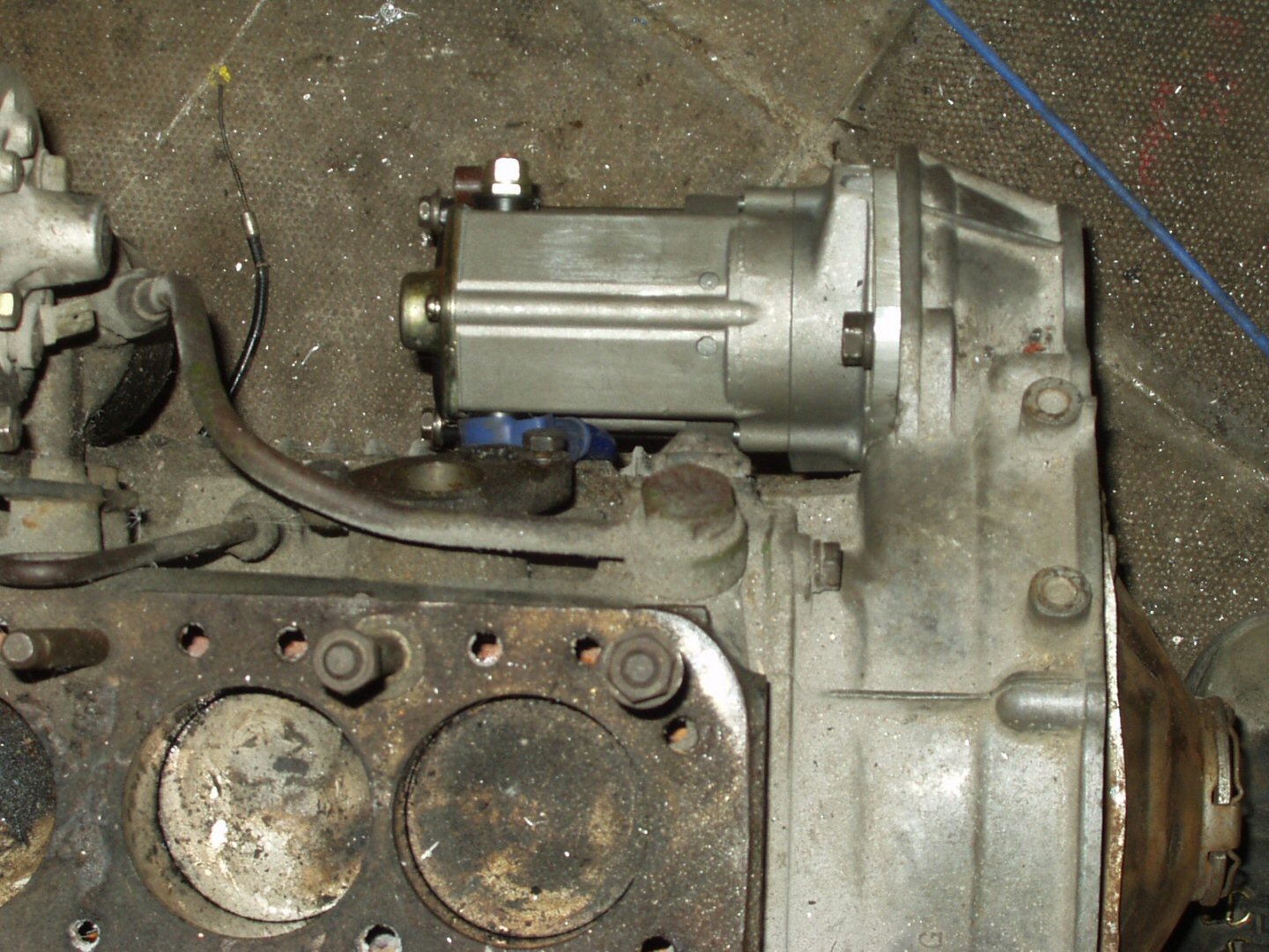

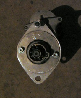

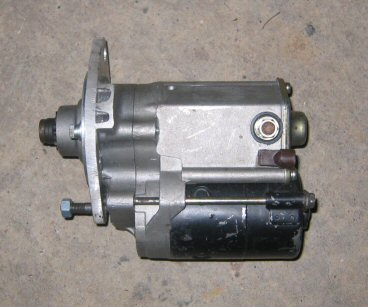

1st Apr, 2008 at 08:19:30pm
Some photos. You can see that a stud has been put in so it can be bolted up from the other side, this stud will fit straight through the existing threaded hole.

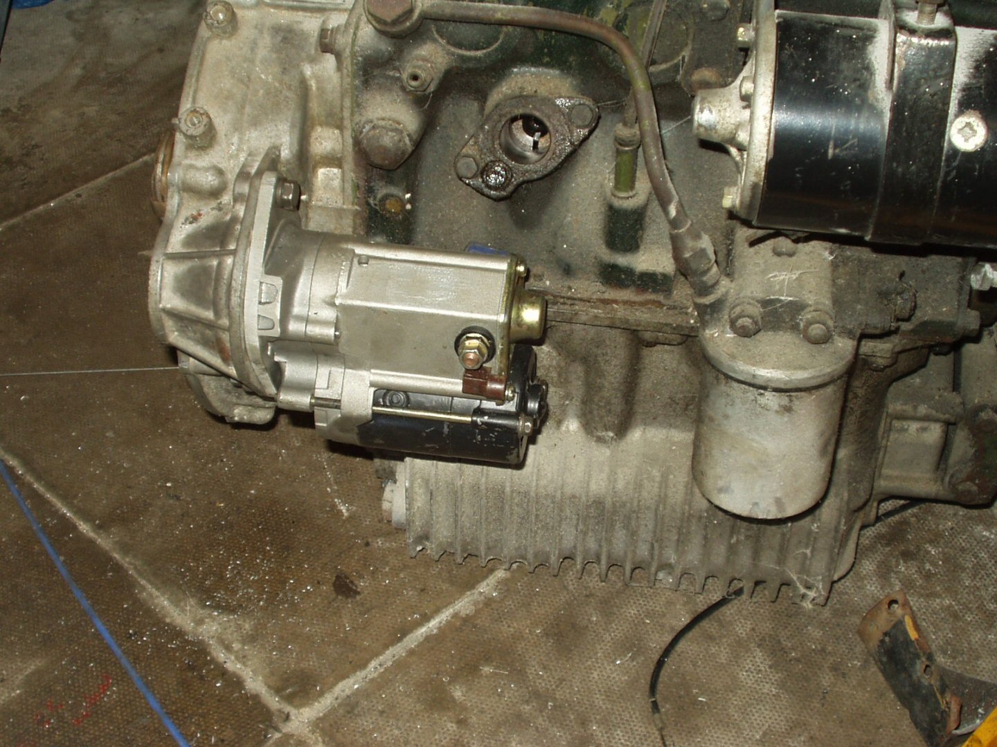

2nd Apr, 2008 at 06:36:53pm
A few pictures of the starter on an engine

3rd Apr, 2008 at 04:39:31pm
Blooming heck Ben that's small, any idea how much it weighs? Isambard Kingdom Brunel said:
