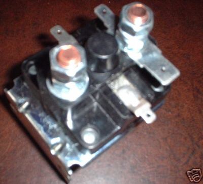

Bodge Job
455 Posts
Member #: 953
London
Hi Gavin
Sorry I dont have any pictures but I fitted it the way I was told.
1,2,3,4 fitted to terminal A, and a thick cable from A to the new starter.
A new cable from terminal B to the big spade connector on the starter.
5 was connected back to C.
But it didnt work this way, so I removed 5 from C and placed it on B and it started. Is this safe ?
Thanks
At first it sounded like your wing solenoid isn't working....
BUT, looking closer at your photo, I think the wing solenoid is physically broken, ie, there is a tag missing.....
USUALLY, the operating coil tag (where the red/white should connect) is at the top right of your photo (opposite your "C") and is a male tag. The one you have marked "C" and is female in your photo so is normally the ballast start bypass connector.
So the "instructions" are still right but the "C" you show is not "C"
So look dead opposite the tag you have as "C" and see if there is a rivet (or anything else) that looks as if it might have once had a male tag in that position.
Running "5" (ie, the red/white) direct to the pre-engaged solenoid will work... for a while... just look at the tag size on the pre-engaged starter compared to the tag on the end of your red/white cable. The current taken by the pre-engaged solenoid is much higher than your ignition switch contacts were designed for.
Rod.
Right, look at this.
Standard wing solenoid with the extra (female) tag for ballast start.
All battery and power cables on big right lug.
Power to starter from big left lug.
Solenoid operating (red/white) from ignition switch to small tag on top.
THIS IS THE ONE I CAN'T SEE IN YOUR PHOTO
Bottom small female tag is bypass to ballast coil.
If you connect red/white there to the bottom female tag it will do... nothing..
The basic way of using the standard wing solenoid as a relay for the higher current pre-engaged starter is to have everything as in my photo but move the big starter cable over from the left lug and add it on top of the big battery cable on the right lug and then run a medium sized wire from the left lug down to the large lucas tag on the back of the pre-engaged starter.
Rod.

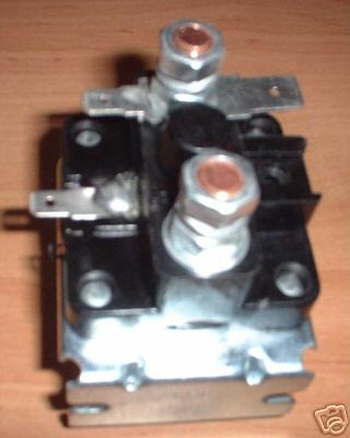

Bodge Job
455 Posts
Member #: 953
London
Hi Rod
So I need a new solenoid ?
These are the ones I have seen on eBay. Which one will I need ?
Right,
FIRST make sure my thoughts are right, ie, you have a broken/missing tag from your solenoid.
The important question is whether you have a broken/missing tag from your own solenoid.
The two big lugs and associated tags are obvious on any application (battery in and out to the rest of the car on one lug and starter motor only on the other lug).
The two (or one) smaller Lucas tags simply say if it is a three or four terminal solenoid.
There has to be one tag, to energise the solenoid coil, but the later ones had the "fourth" tag to provide the ballast coil bypass supply.
If you have ballast ignition you need the one on the left (two posts,two tags).
If you have standard (early) ignition you only need the one on the right (two posts, one tag).
Personally I would always buy the one with the extra tag even if I wasn't going to use it, just in case I wanted ballast ignition in the future. But then you need to make sure you know which tag energises the solenoid and which is the extra ballast out connector.
Rod.
