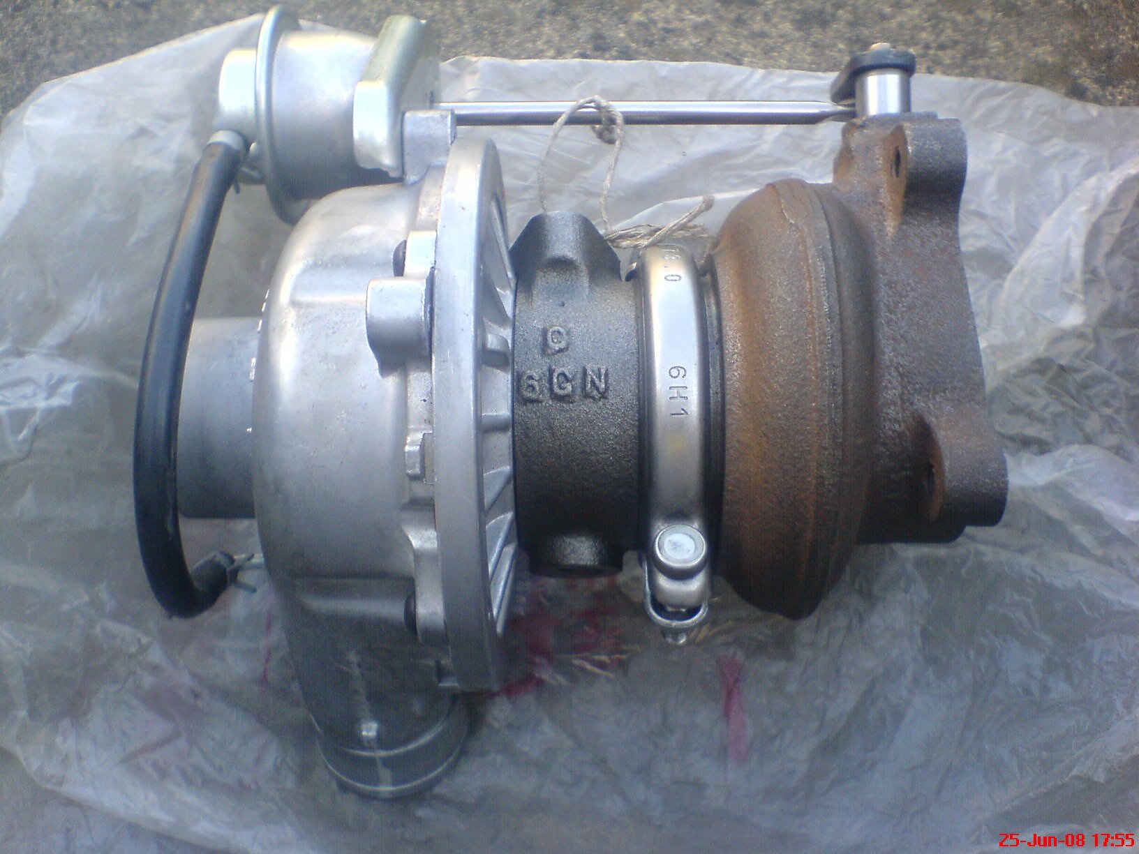

On 25th Jun, 2008 just_jack said:
1- inlet 2- the little ID thing it says, spec- as12 0608 rhf4- 22 306d parts- 135756180 3- its says ihi turbo (on the inlet side) 4- exhaust side Jack Jones |

26th Jun, 2008 at 12:06:13pm
right, here is the turbo

On 26th Jun, 2008 wil_h said:
right, here is the turbo From my calcs, for a small bore running 15psi it looks to be ok from a compressor side. the map to look at is the pink one. thanks alot for doing this wil but to be honest if anything it has confused me quite a bit, i dont really know much about turbos themselfs or the conversion really will it be good enough for the job, how much boost will that max at and any idea of price of them??? Jack Jones |
26th Jun, 2008 at 03:21:45pm
No idea of cost, you'll need to reserch that yourself.
