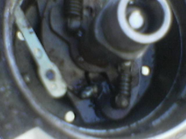

as per title

why are you welding the dissy
To give a fixed ignition timing i presume ?

From the pic it looks right as long as you've done the same 180 degrees opposite?

Looks ok to me. As long as the weights don't move, then the timing is fixed.
I presume Bat is thinking about the thing being balanced?

ok cheers will. yeh well it not movin at all so yurrr..

now what do i do, put it back togetha and install in, motor. set timing to 24deg
I would install the dizzy in the motor. Strangely enough there is room for it.

hahah yes i have intercooler piping quite close though... and shud i run vacumm advance

How are you going to get any vacuum advance when you've welded the advance mechanism solid ?

The vacuum advance will still work if the base plate is free to move *wink*
I was concerned about the fact that one of the weights wasn't secure and could move and break the weld off the other one...
Think about what you just said for a minute, bearing in mind that you're planning on running a turbo, what do you think is going to happen to the vacuum?

yes right i ssee, im new so i can get off this time...
