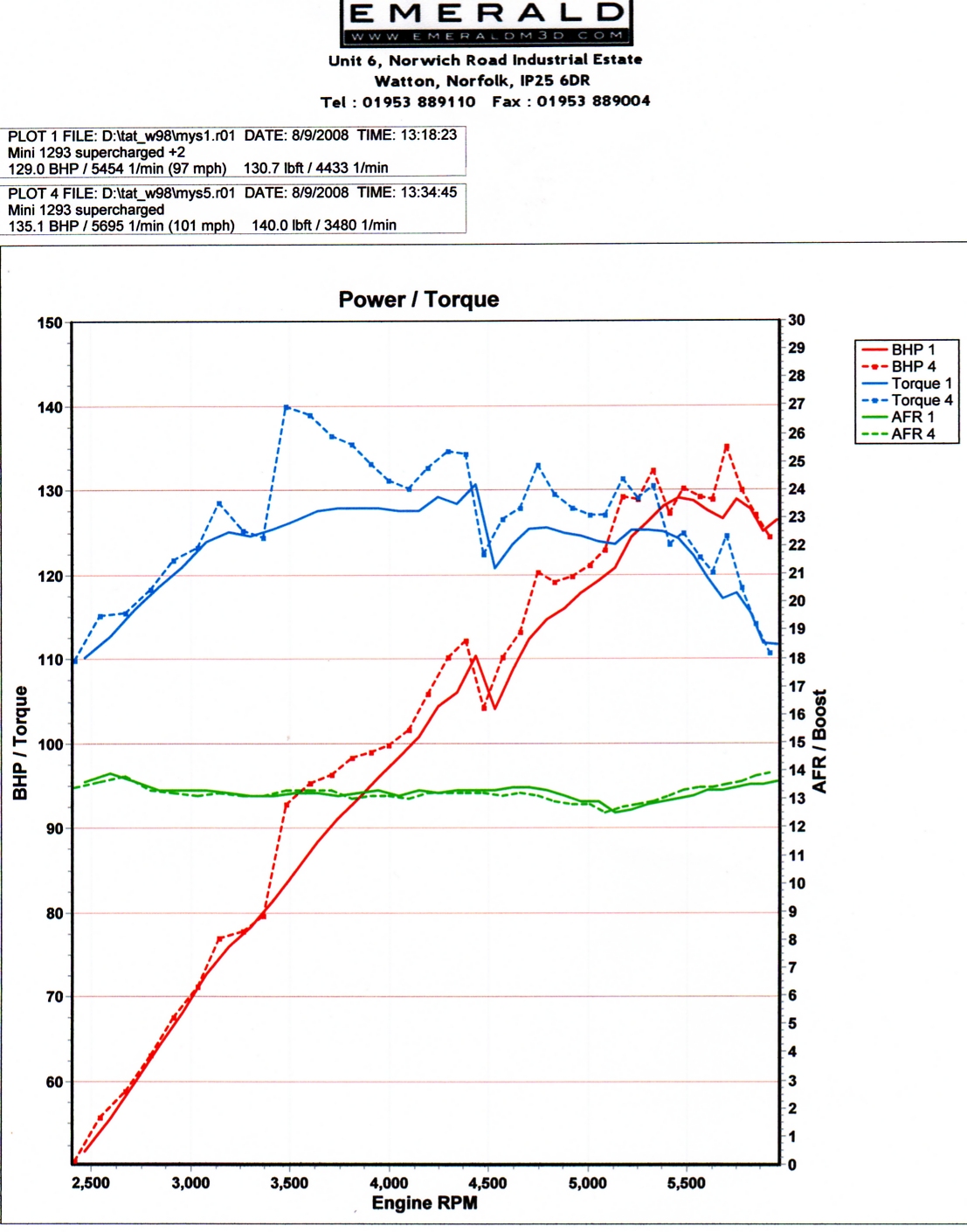

Hi Paul, When i looked at my plugs they are all identical in colour and have a very light brownish dusting on them like yours which indicates they are all running around stoich.
There was however as you noted quite a difference in the build up on the top of the pistons with pots 2 and 3having quite a bit more on them.
From my RR printout you can see that AFR remains between 12.5 and 14 through the rev range. It starts to lean off when held at consistantly high revs (around 6k) as the fuel pump doesnt seem to be able to deliver the capacity.
