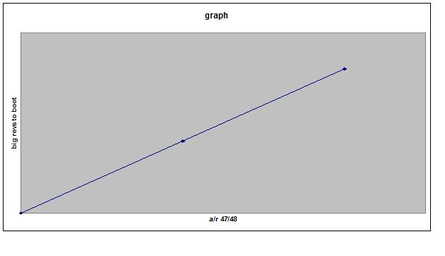

Well ive readed alot, and seems that AR 47 / 48 is on the large side, big bhp, but needs big revs to boot.
Any1 have like a graph to show these kinda figures?
crizd
36 Posts
Member #: 4335
Hull / Scunthorpe
LMAO, common, really how long did that take. *one point to joeybaby83*
it took me 3 attempts lol
ha ha ha!
Fucking Genius!
That made me laugh Joe. Cheers. :)
