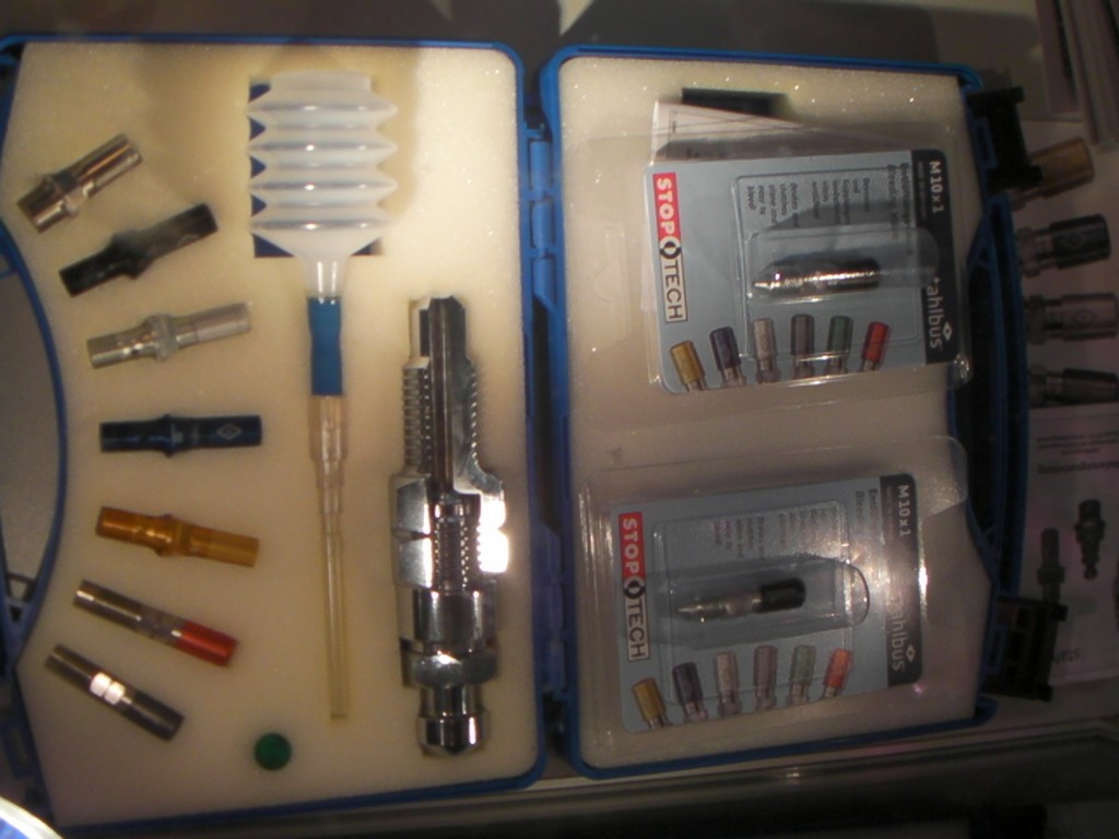

bit o/t but i saw some rather sweet 2 piece bleed nipples at the motor show, with a 1 way valve in for single handed bleeding, got a pic somewhere...
theyre a brand new product from stoptech, and not available in the shops yet, if you want some Ive got the guys contact details
