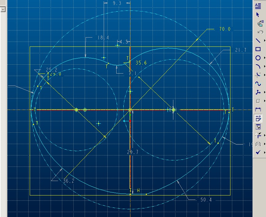

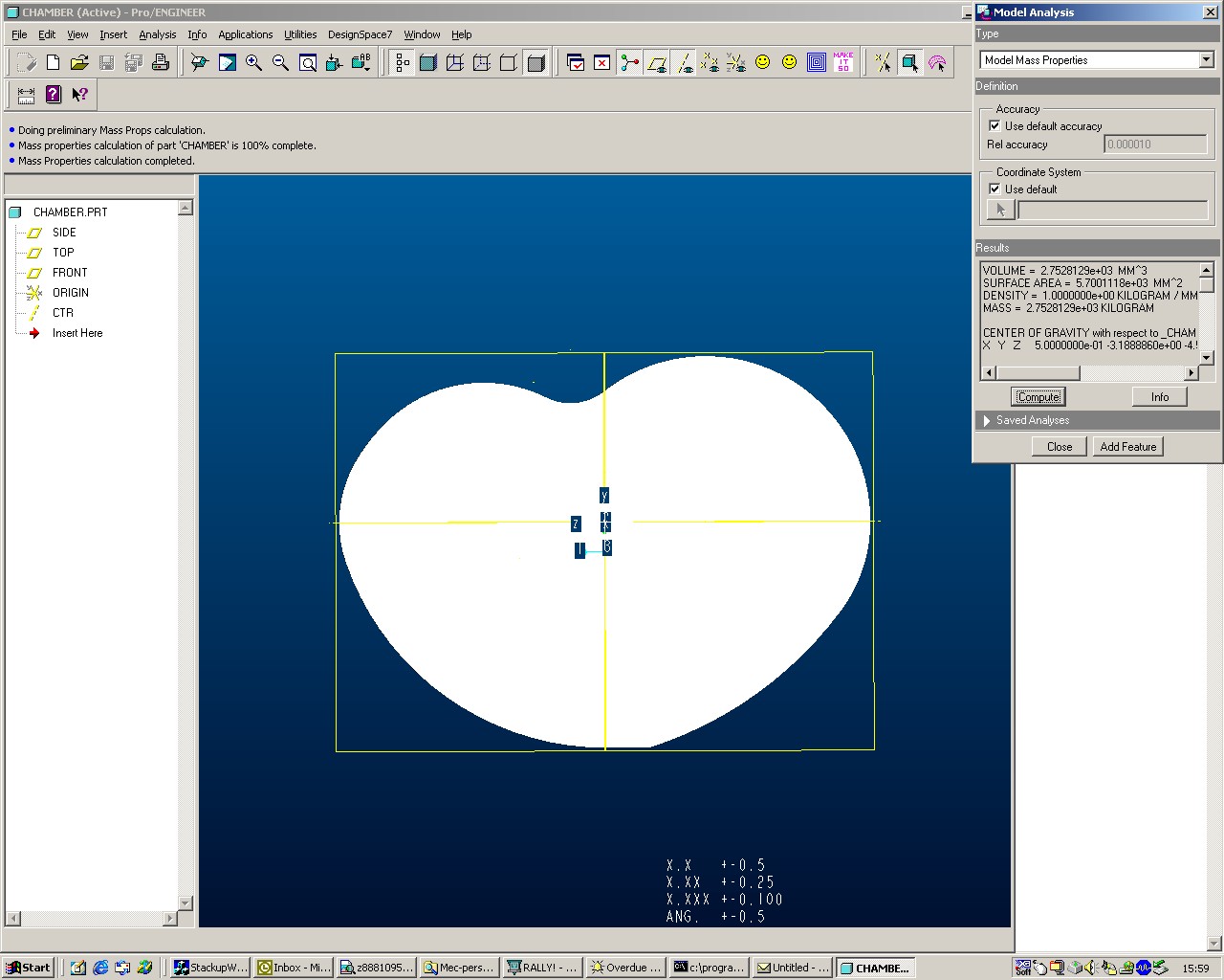

Below is copied from an email I sent MiniMark 5 years ago when he asked me this same question. Sure, the model is not 100% accurate, but it's better than anyone else had done back then - and clearly no-one really knows the answer still today...
It'll at least get you in the ball-park.
XXXXXXXXXXXXXXXXXXXXXXXXXXXXXXXXXX
These dims are for a chamber shape i roughed out. As you can see, for 1mm thick, the shape you see is 2.7cc.
We know that using the formula [ pi*(Diameter^2) ] / 4
that 7cm diameter circle, 1mm thick is 3.8mm thick. Hence, the difference is 1.1cc / mm in the remaining section, of which i reckon 0.9cc is the 'beak'
hence if the beak is 7mm high, it = 6.3cc if removed totally...

Still think that if you divide the depth of the chamber in mm, by the chamber volume, then multiply that by the cc you want, will give as acurate a figure as you would need.
So 7mm divided by 21.4 = 0.327mm per CC if you are looking for 1.5CC simply multiply 0.327 by 1.5 = 0.491
So yes, 0.5mm will get you close to where you want to be.
Calculating compression ratio is never an exact science unless you have the calibrated measuring equipment to do it to the nth of a CC *happy*
Going off Daves figures, its not far off right too
