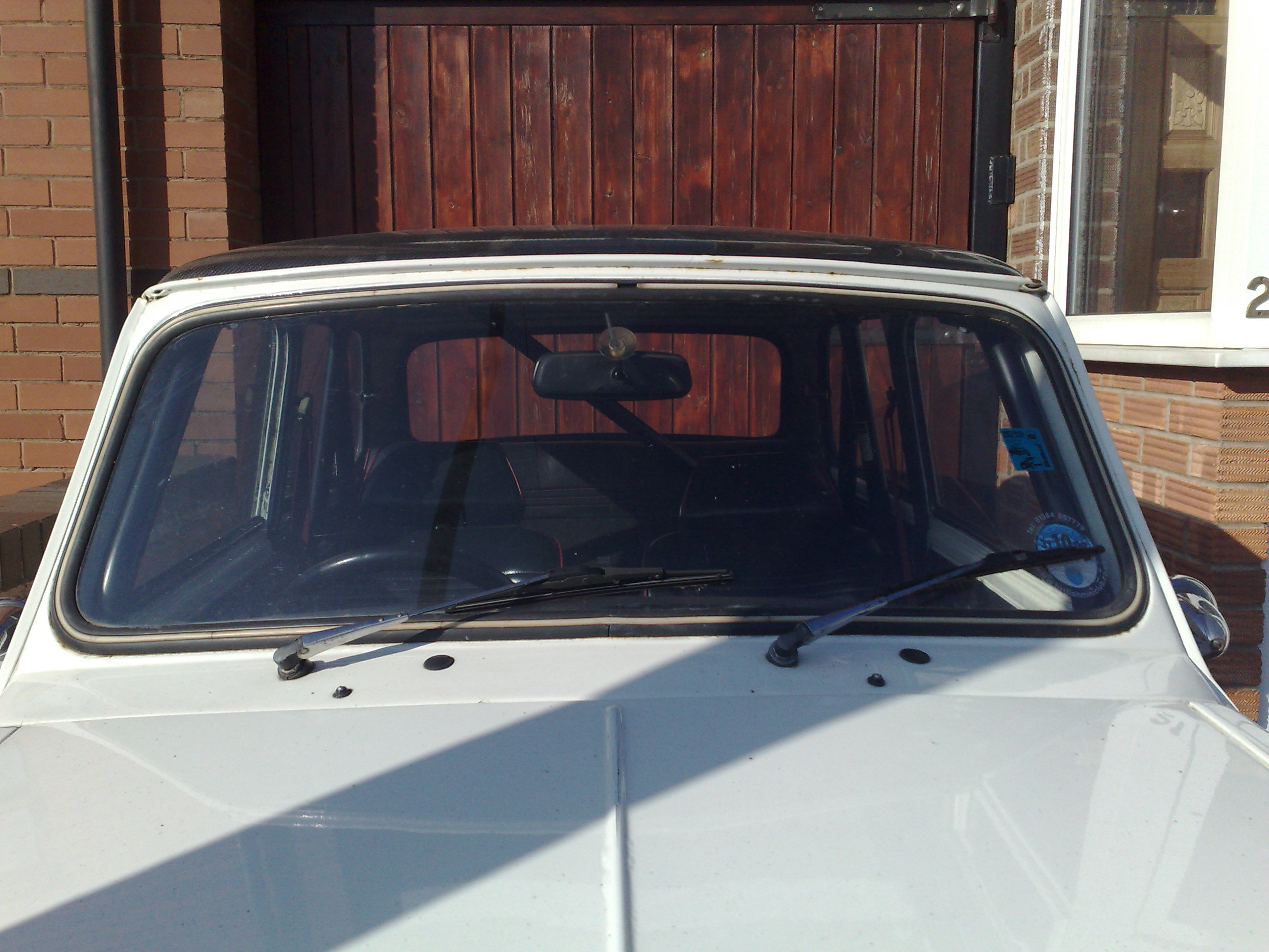

heres a few pics
and a pic with my alley cats on which should be back on within a few month once i get some miglia arches.
