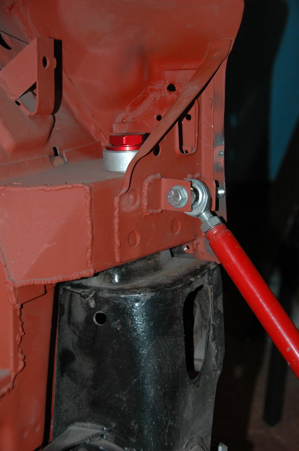

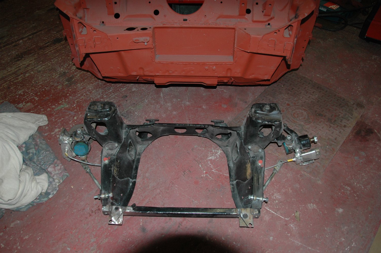

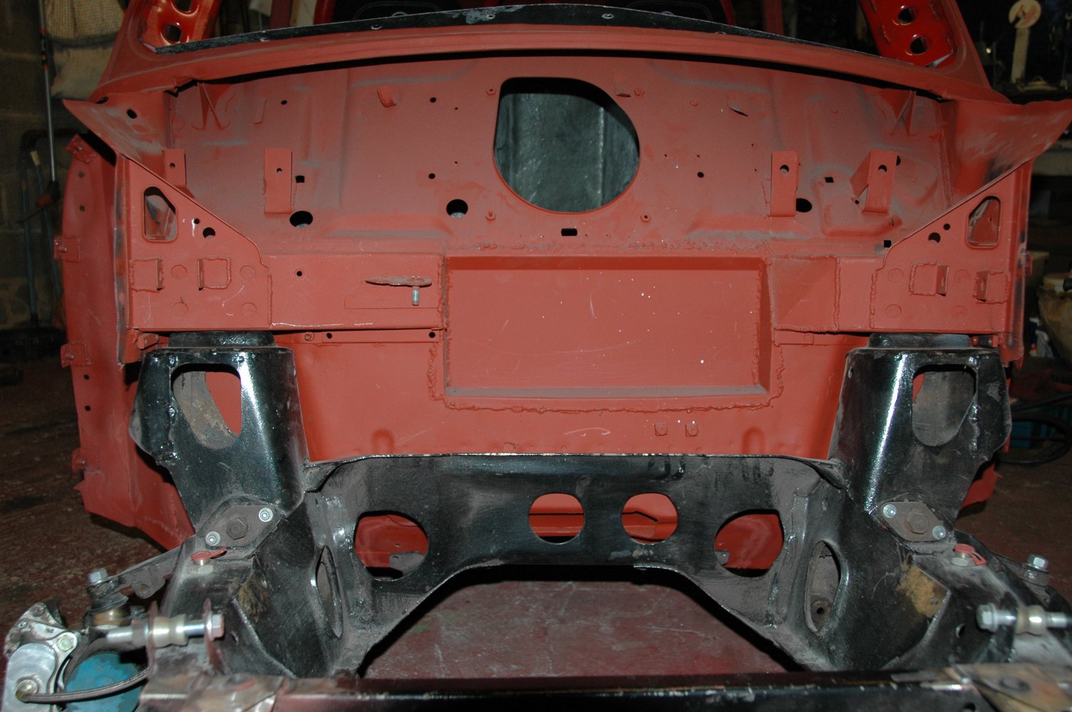

First off you don't need to do any mods to the subframe or the shell come to think off it, Jim cut the locating rings off his subframe but you don't have to.
Just remove the rubber, poly, ally or steel mount that normally goes between the subframe & the shell and offer the subframe straight up.
Due to the length of the shank on the tower bolts you will need to put a spacer (load of washers if you're a cheapskate pikey) on top of the top mount or alternatively make up some thicker top mounts.
Finally you will need to tweak the lower mounts for them to line up correctly.
Simples
Note for this mod to work properly you have to use alloy tower bolts as steel one are too heavy and look pooh.

Blooming heck that subframe was heavy, if only I hadn't wrecked my last hole saw notching that blooming cage this morning.
Edited by Rob H on 12th Apr, 2009.

i can't understsnd why in those links above folk have removed the locating lip for the rubber/poly/alu spacer,its not just a spacer it locates the tower to into the crossmsmber without the lip and somekind of locating ring the frame is putting a shear moment into the bolts
Carl, I see your point, but the OD of the ring on the subframe is much smaller than the ID of the ring on the cross member so without a spacer it's useless. And you of all people know that weight is evil.
What you will find running that low, even if you move the subframe is that your spring rate is reduced as the top arm is at such an angle.
I have cut the bumpstop area of the subframe out completly.
To run that low at the back you'll either need super stiff poly springs or an ARB IMO. Running too low at the back could potentially ruin the handling.
