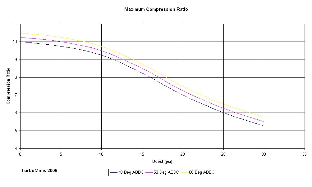

i robbed this from tm ages ago, if its of any help

looking at that is the t3 and the size of the Ic will limit max boost if every thing is ok but what type of pistons are you using also.
but 16 psi will do for now
if thats what seems to be a 7.7:1 cr then a lot of boost ,20 psi odd sohuld be safe on good fuel ,eg v power .dont know what the new bore is so i assumed 1293cc ...plus 20 overbore .

Just looking at the spec,
14-16 sounds fine and would safe and fast enough.
you can always go for more later.
Did you fit a centre main strap?

As robert says it looks like the compression is going to be around 7.7:1 (i also seem to remember a fig of around this from when it was being built)
at 7.7 your not likley to run into det issues due to too much boost untill the boost starts getting very hot, which is also unlikely with that intercooler.
probably the weakest link is the pistons (Which are still pretty sturdy!)
I think i would be setting the boost controller to give a wide rnge of settings, from a nice docile 5 psi to 22psi in steps, with them a bit together at the top end so you can edge it up a psi at a time on the rollers.
somthing like 5,7,10 12, 15, 18,19 20,21,22
