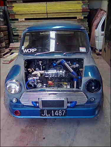

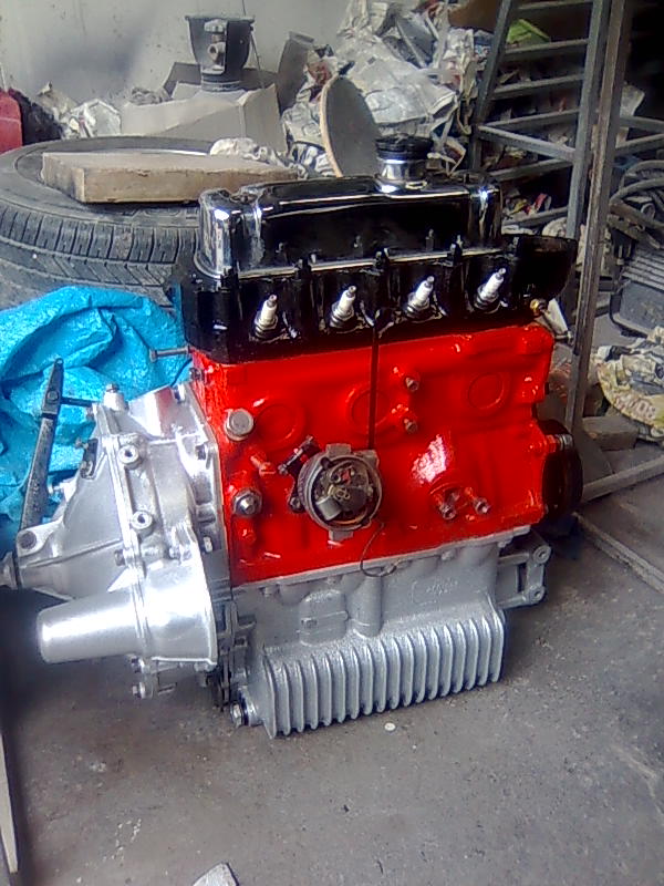

the engine in pic is the na 1100cc clubman motor that i am running boost on until m.e.d engine ready. at 4psi it made 87hp at 8psi it made 101hp ...running 4 spd sc cr gbox...

GaryOS
1424 Posts
Member #: 2810
Formally spanner181187
Dublin, Ireland
I assume it is one of the short stroke 1275s and not a long stroke 998 by the power figures?
That's an odd statement Gary.
Benjamin has 140hp from his 1098.
Yes but I thought 87hp at 4 psi and 101hp at 8 psi sounded a little high for an engine so uninclined to rev
On 30th Apr, 2010 Rod S said:
Gary's description is best
I would tend to agree that 87 at 4psi is maybe optermistic, but this is why be say bananas rather than bhp on this forum.
I'm sure it's fun whatever it has.

CR#
140 Posts
Member #: 1367
Cape Town, South Africa
This was the car trying to run boost with no plenum a while back was it not? pipe straight into the carb? With what looks like a n/a carb which hasnt at liest been boxed in?
NZMED1293
45 Posts
Member #: 8924
New Zealand
this is the car and it works fine without the plenum. have only just stripped it down after 6 months road/weekend use at 4-8psi. went fine. na carb yes, modified to suit boost. bdd needle profiled, hifturbo jet, pressurized float bowl.

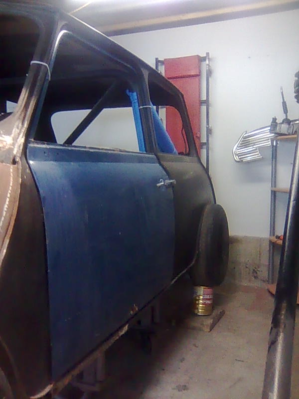

NZMED1293
45 Posts
Member #: 8924
New Zealand

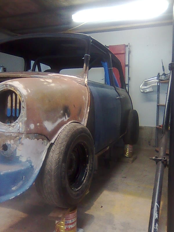

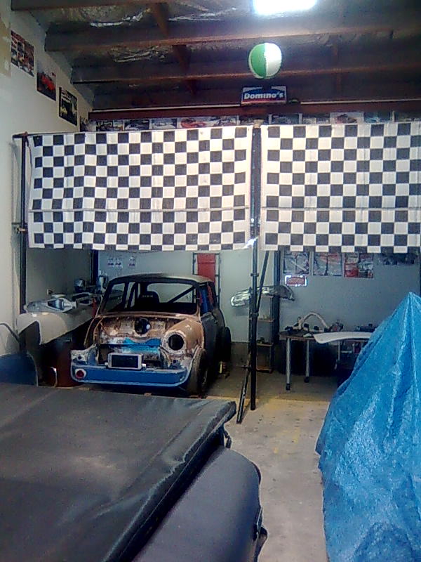

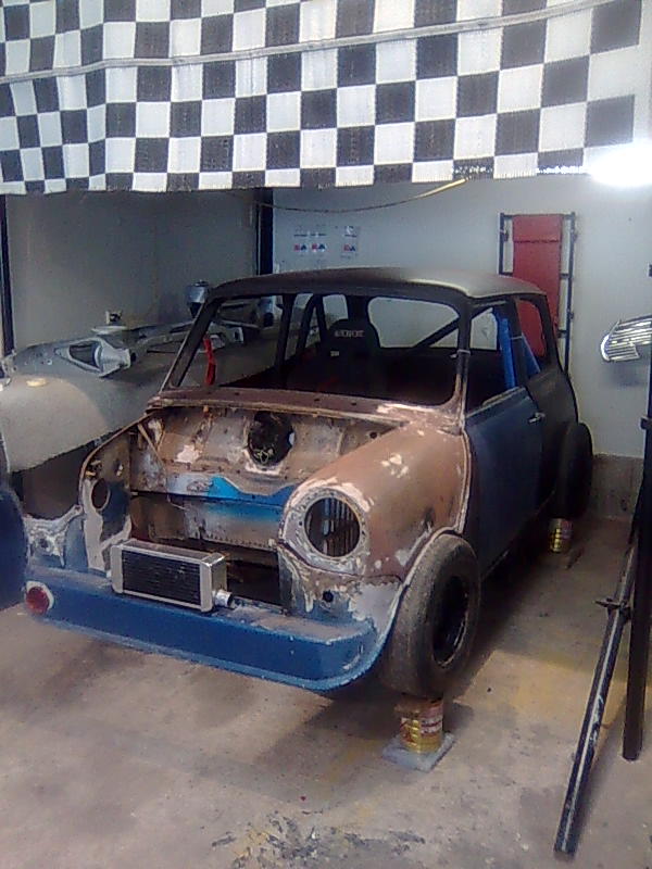

build., rear valvance fitted. inside the car preped more.. still need to weld new guards on when they arrive..

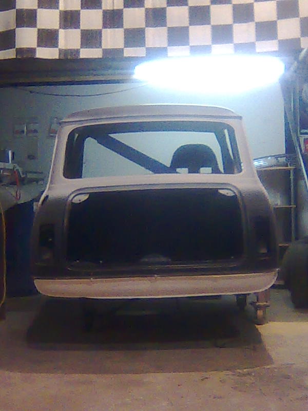

NZMED1293
45 Posts
Member #: 8924
New Zealand
rear valance fibreglass mocked up. new boot floor also wleded in there..

Are you going to get rid of that hideous front valance?
What is that sitting on?
catering bean tins by the looks *happy*
looking good too
Im glad someone asked, I was thinking exactly the same.
