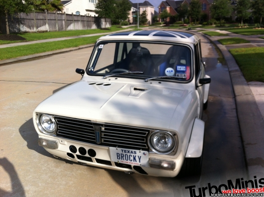

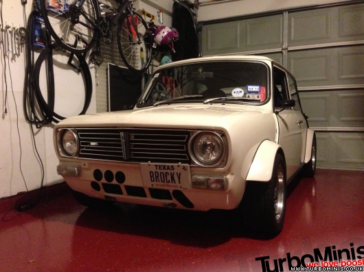

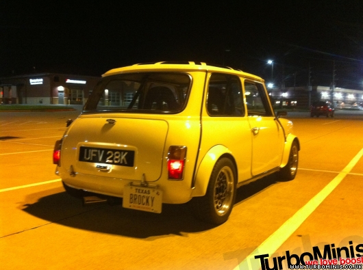

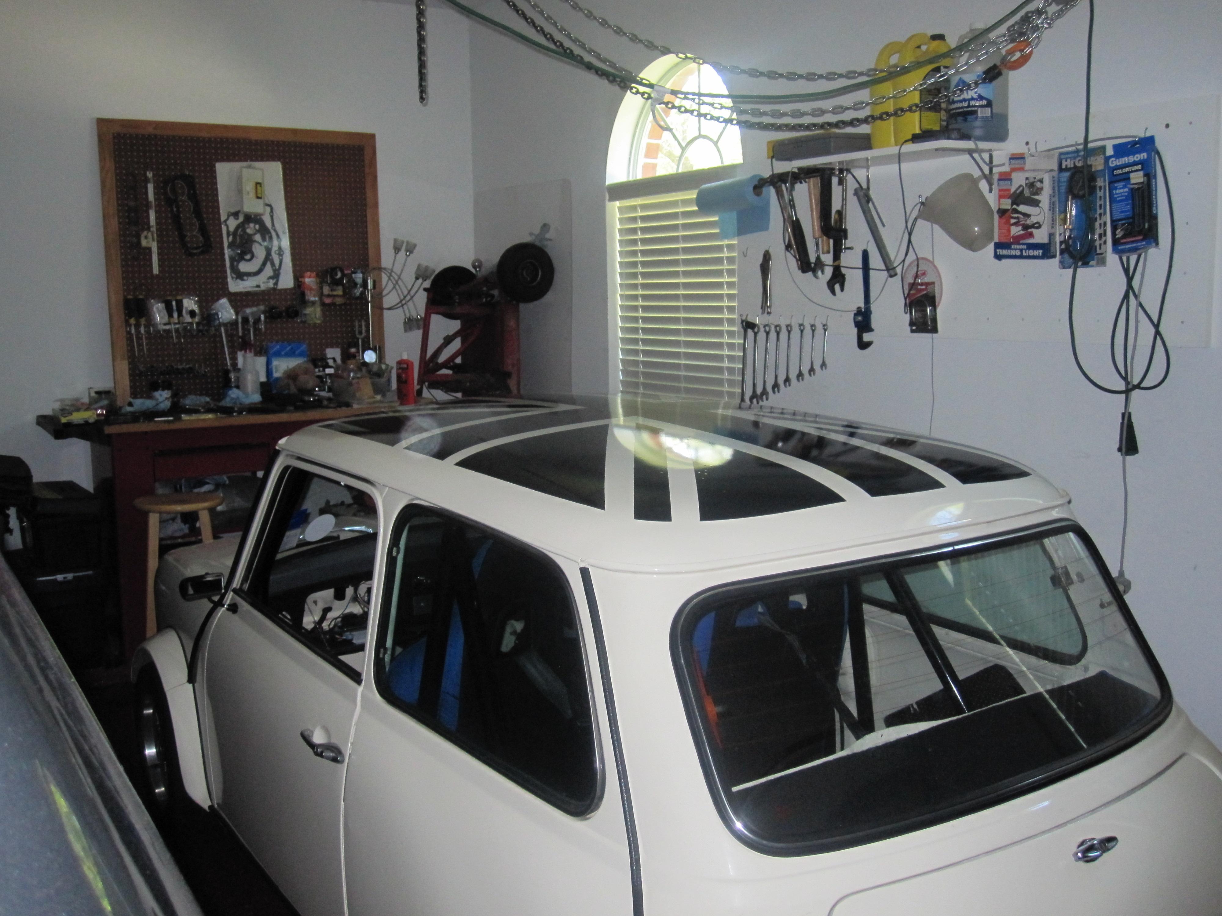

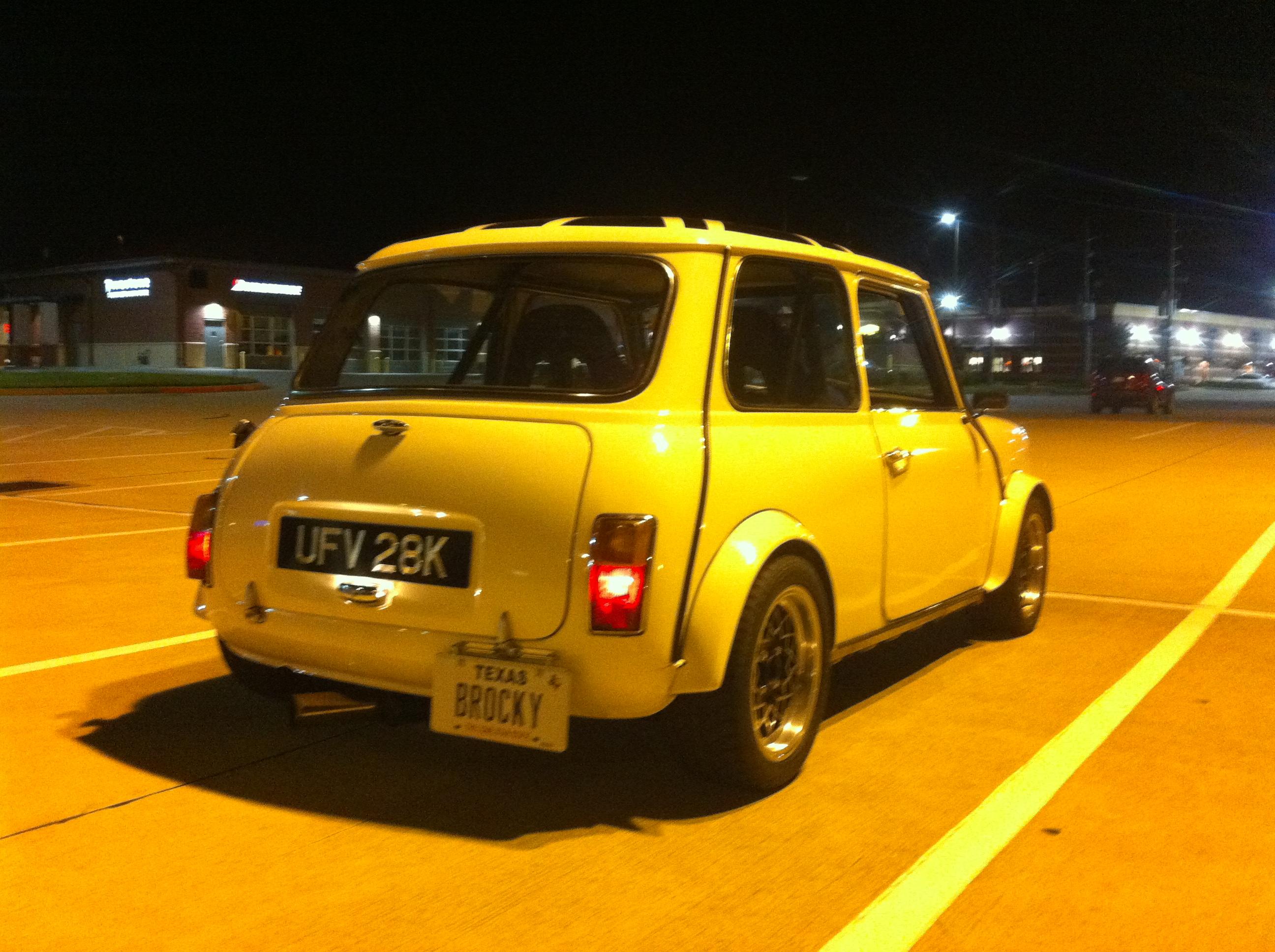

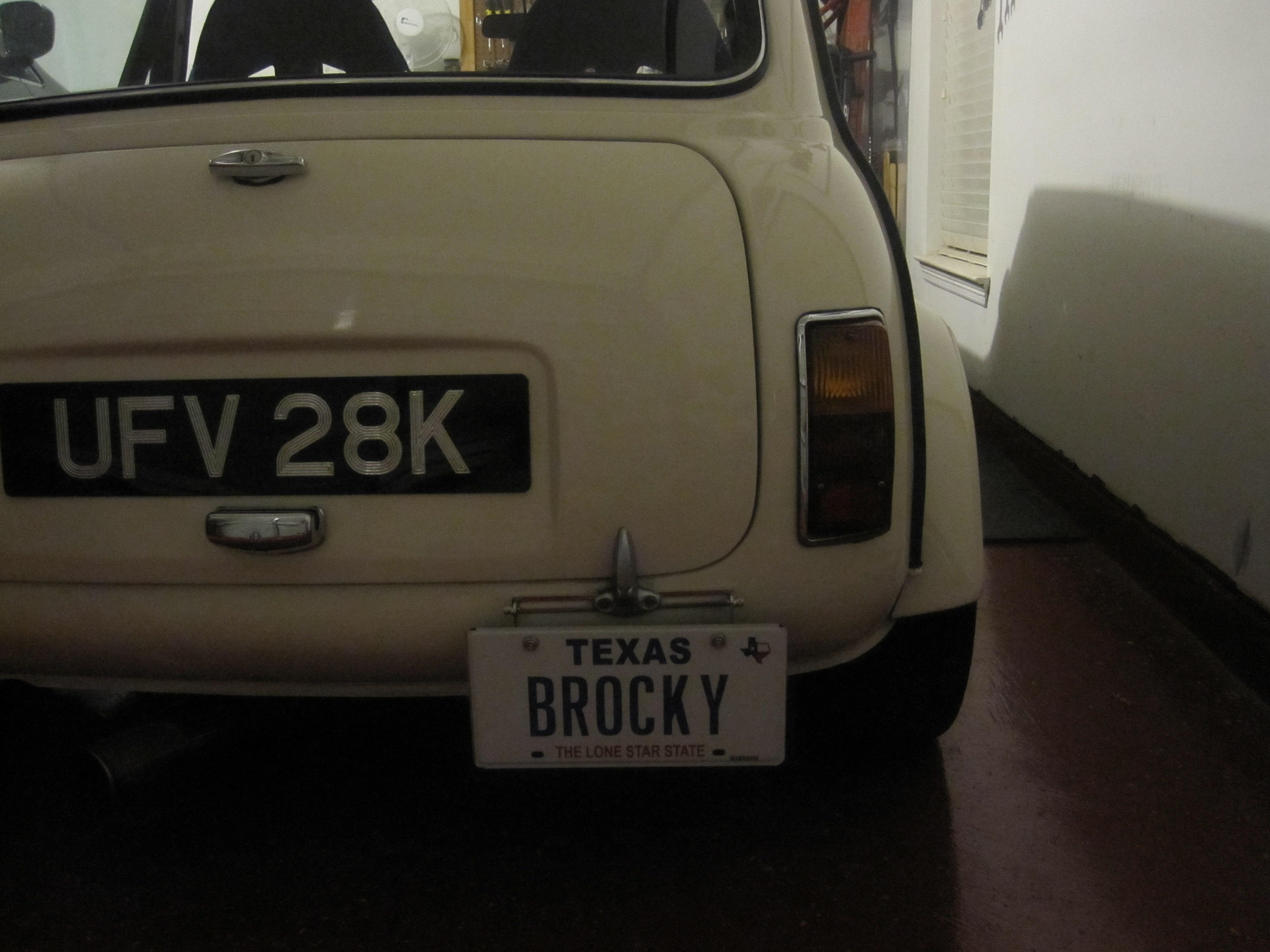

First off I managed to after much hassle to get the car actually registered and legal to drive here, so I have fitted my plates...
I didn't want to drill more holes or pull off the uk plate so lucky I found a plate bracket which I mounted under the boot hinge :)
I think it looks ok ?
I have also fitted spa mirrors and a new roof decal

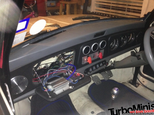

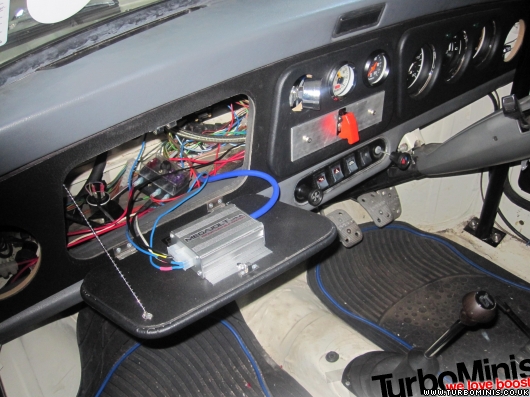

And after having had the edis and crank pulley and sensor bracket for 3 years finally bought a V4 Mega jolt
It runs sooo nice now I wish I had done this years ago...the fuel gauge poking out of the dash is temporary while I sort the fueling as I had to fit a new pump.

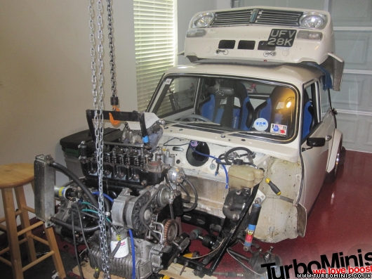

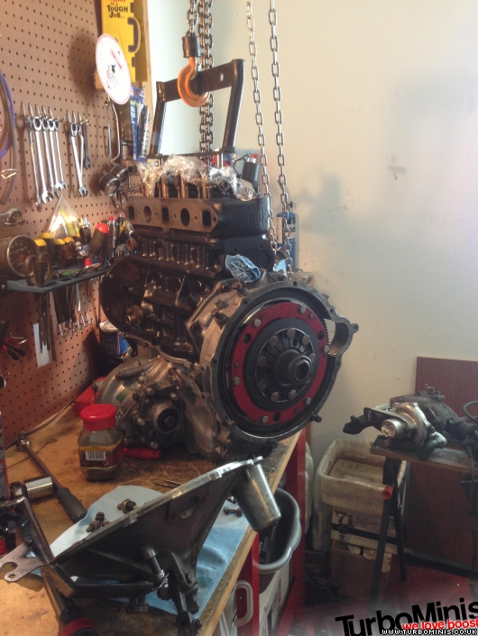

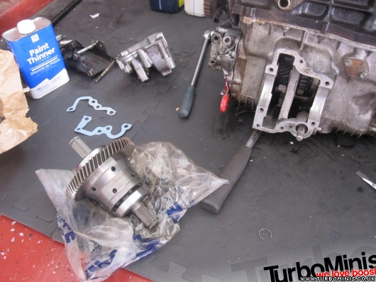

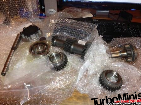

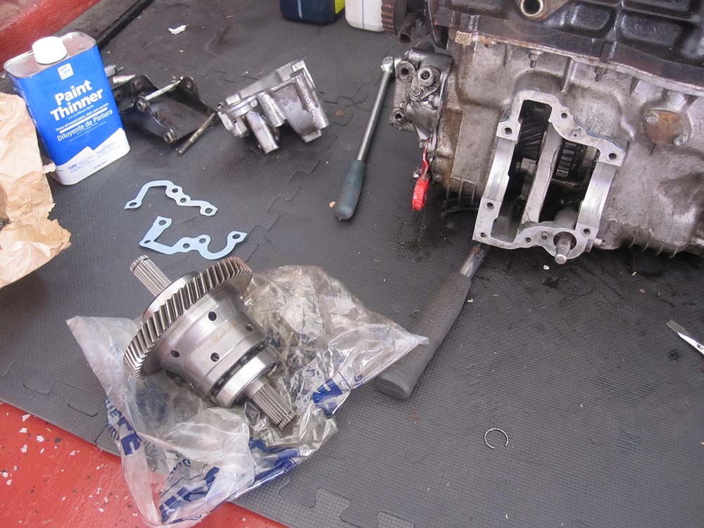

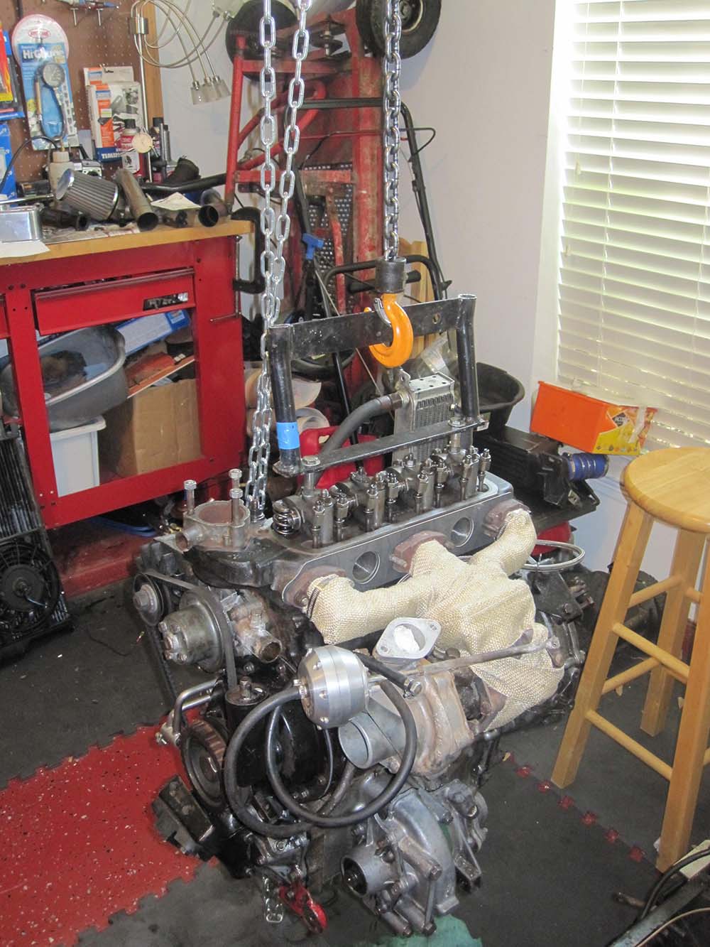

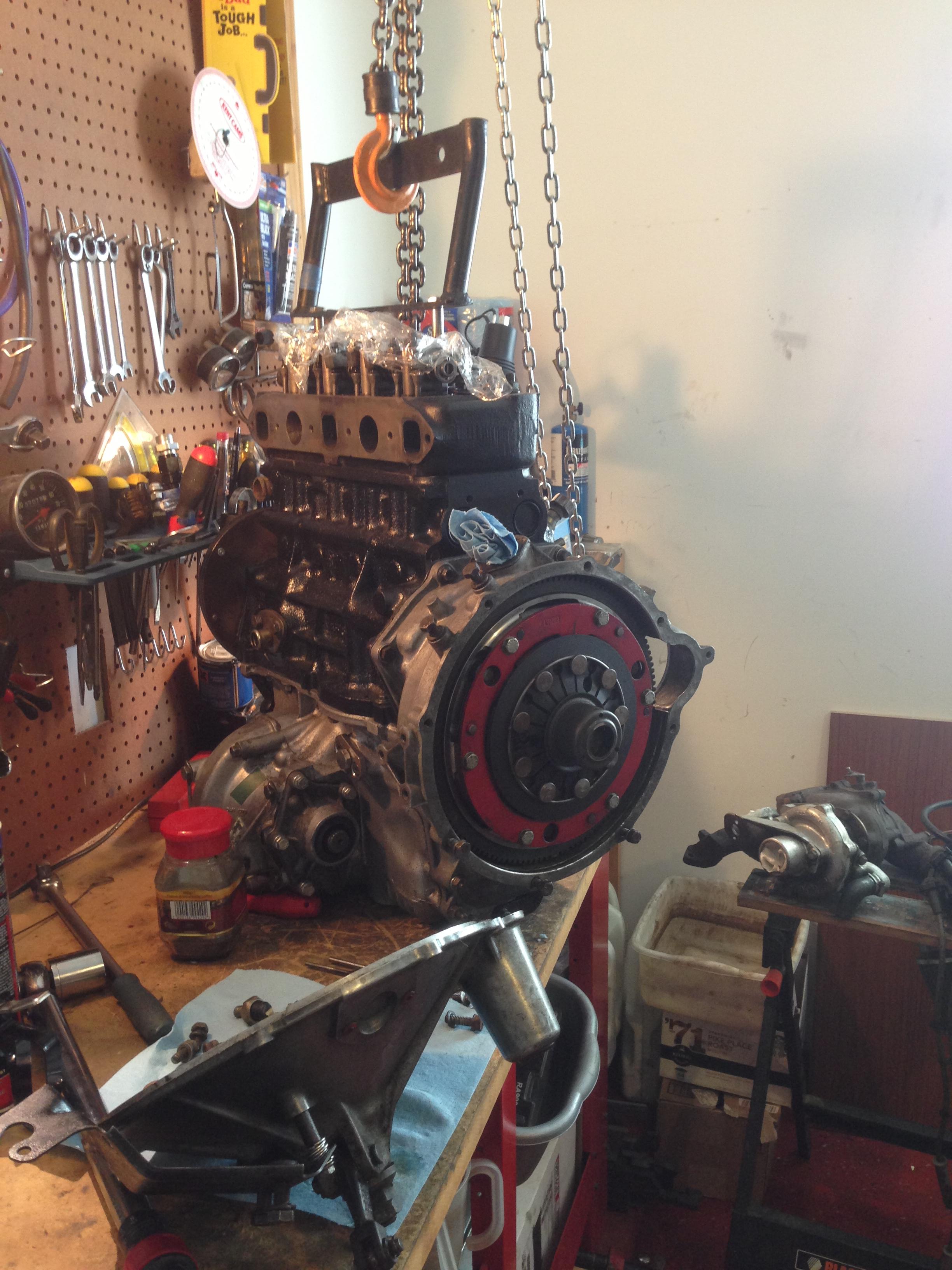

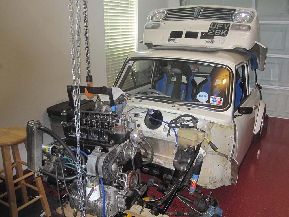

Next I pulled the engine and fitted new head gasket, fixed a few oil leaks and fitted a quaife with new Swifty bearings and a 2.9 FD.

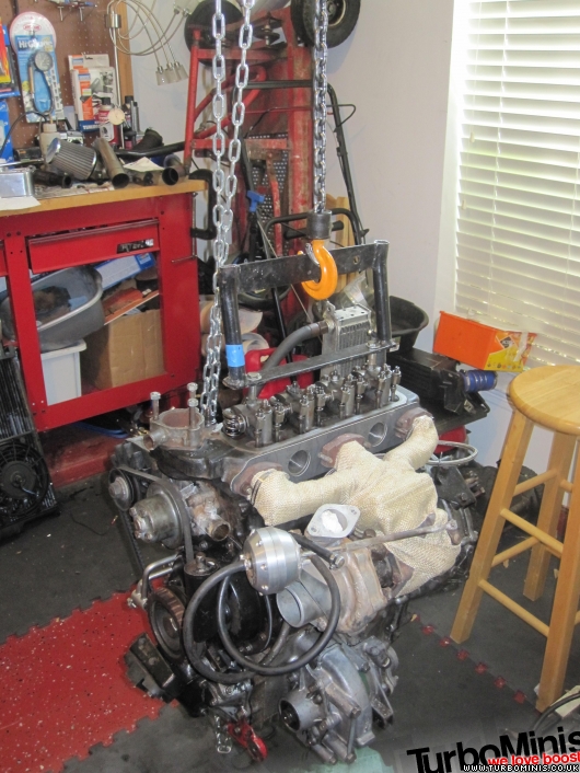

Before refitting the turbo I wrapped the manifold
and fitted the pulley and bracket.

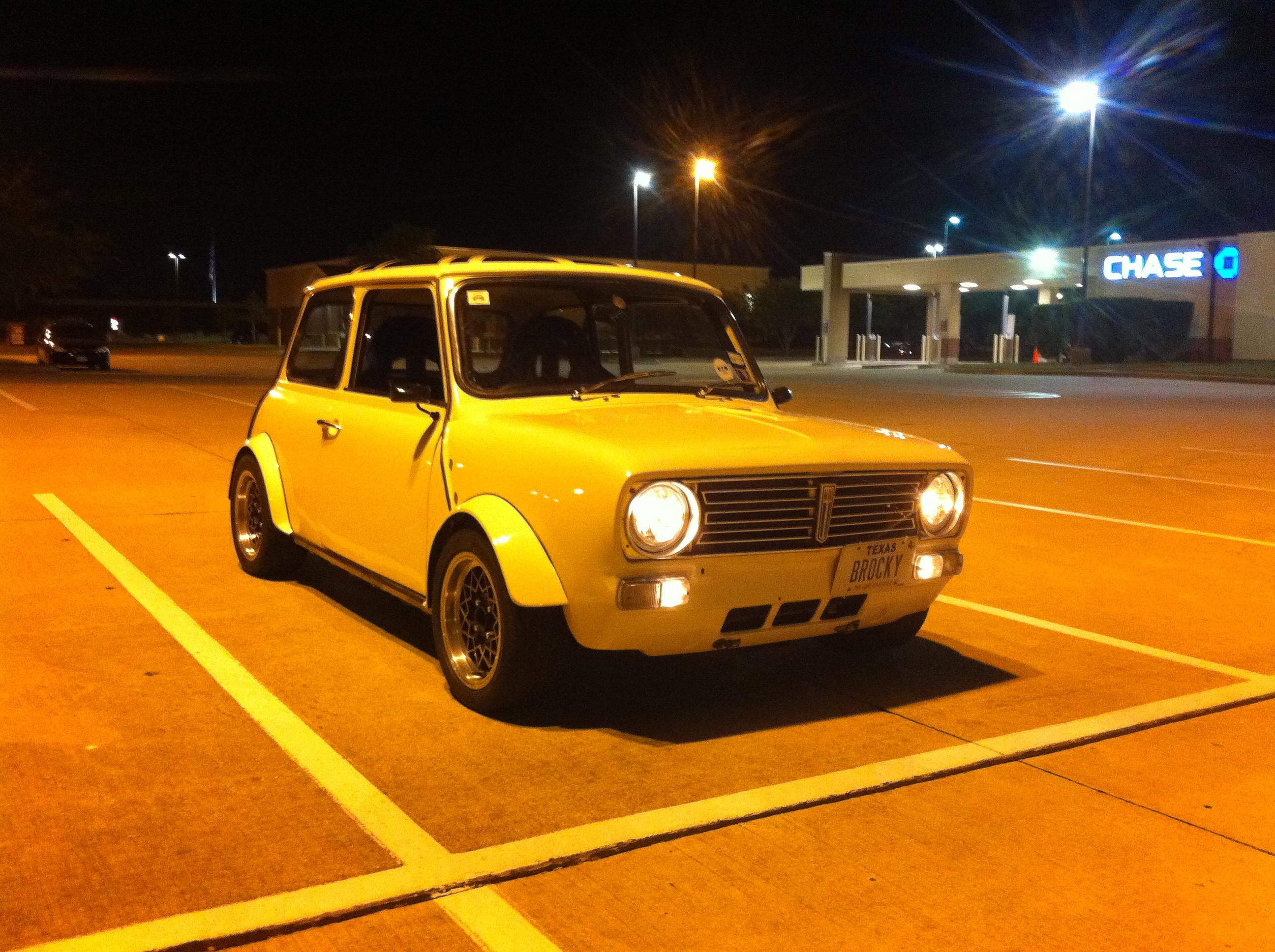

Its been a while since I took the mini out due to the hot weather here, and a fueling issue....the car was starving while flat out in top after a while.
I fitted a new bosch fuel pump and flushed the tank and system and fitted a hi flow pre filter and the beast is back with avengence !!
The air was nice and cool last night and I got up to 6000 rpm in 4th before I chickened out for fear of a ticket. Which ain't bad for 11 psi.
I'm running a 2.95 FD with standard drops on 13"'s so by my calcs that around 20mph per 1000rpm. and the new mirrors didn't fold in. but I did have to push the texas plate back down when I stopped lol and the new roof decal stayed on...

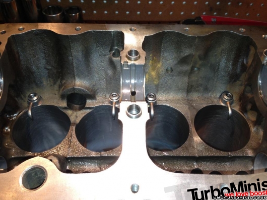

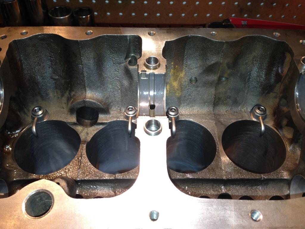

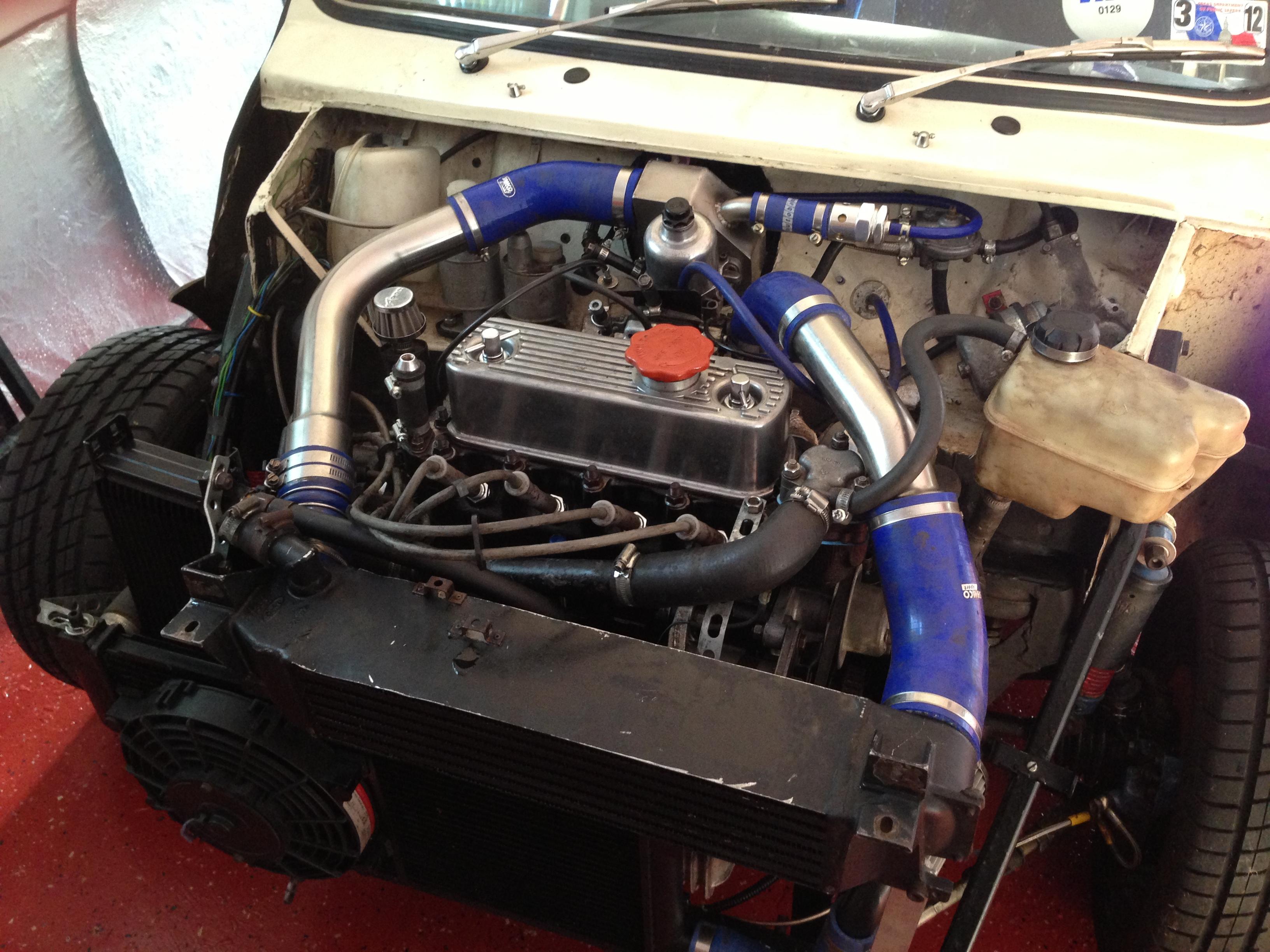

Rebuild the motor at christmas, fairly decent spec.
Total seal rings
ARP Rod bolts
11 stud
MED HC/HF Oil pump
Z4 Under piston cooling jets
Block cooling mods - ported rear entry, blocked first 3 front ports to head passage.
Benross High boost head and matched manifolds and elbow, 2" d pipe.
Rebuilt box w Clubman gear set
Quaife diff etc
Edis/mj set up
Lambda gauge fitted
Fabbed jet holder etc.
Nic stainless plenum
TomFenton trigger pulley and sensor bracket
Black washers under main bolts (relieved gearbox housing)
Using 6281 crank, turbo rods and super low milage 1275 stock turbo pistons,
Chilled cam followers and NA MG cam.

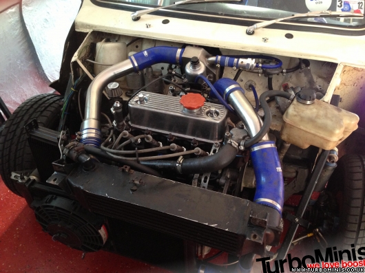

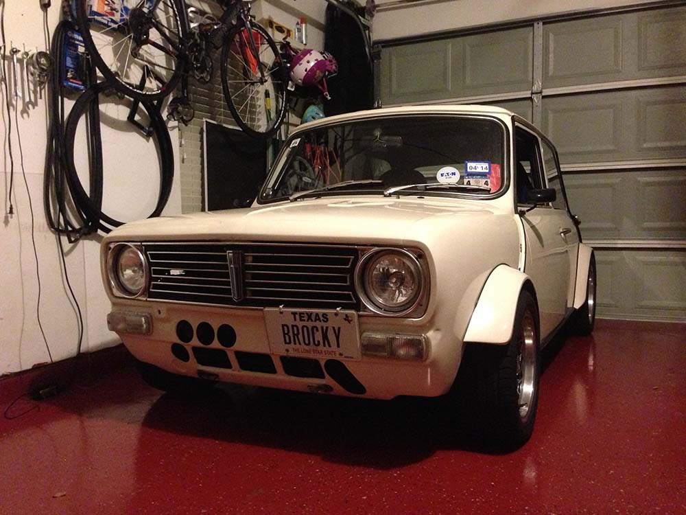

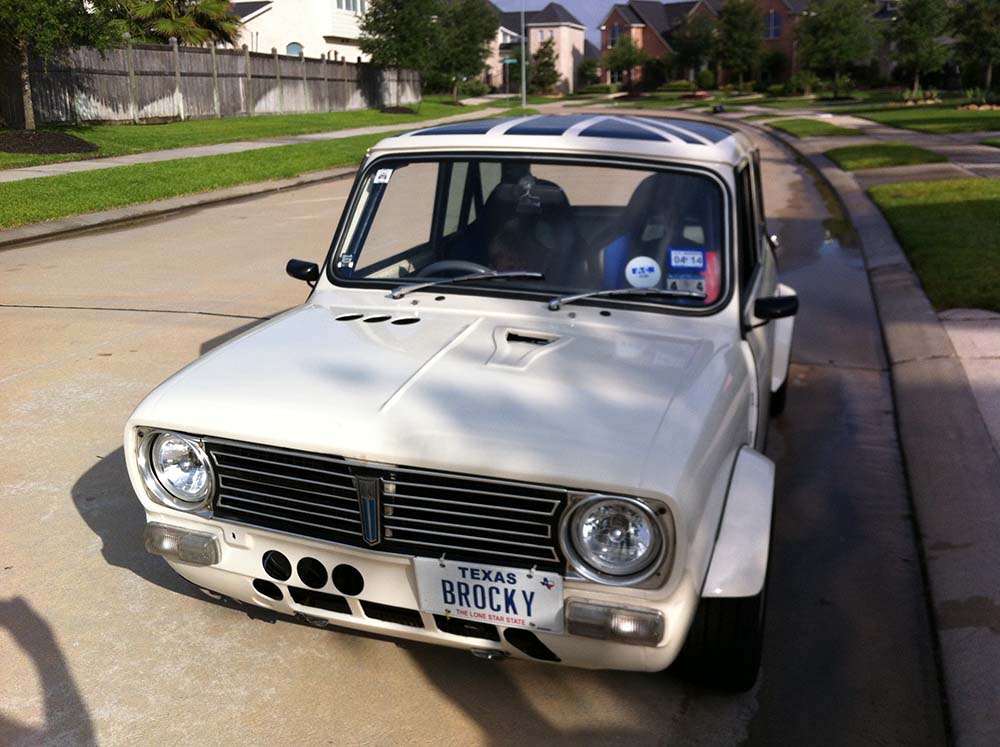

Just running in at the moment, getting hot here so had to open up the front end a little,
also put extra holes at back of bonnet to let the hot air out !

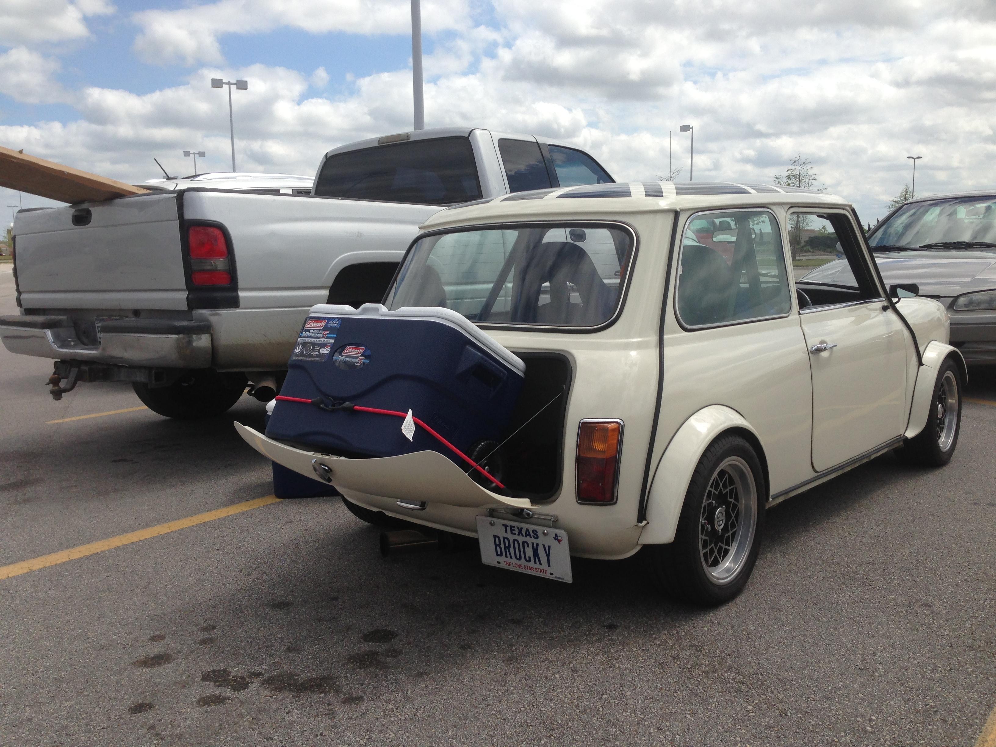

Also, who says minis arent pratical,
I managed to fit a 30 liter beer cooler in my boot, the carry handle fitted snugly under the lock panel and the wheels just rolled down the boot lid and it sat there, i only put the bungees there just in case...
Perfect fit !

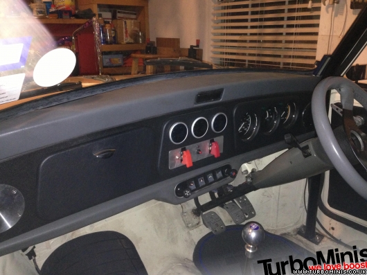

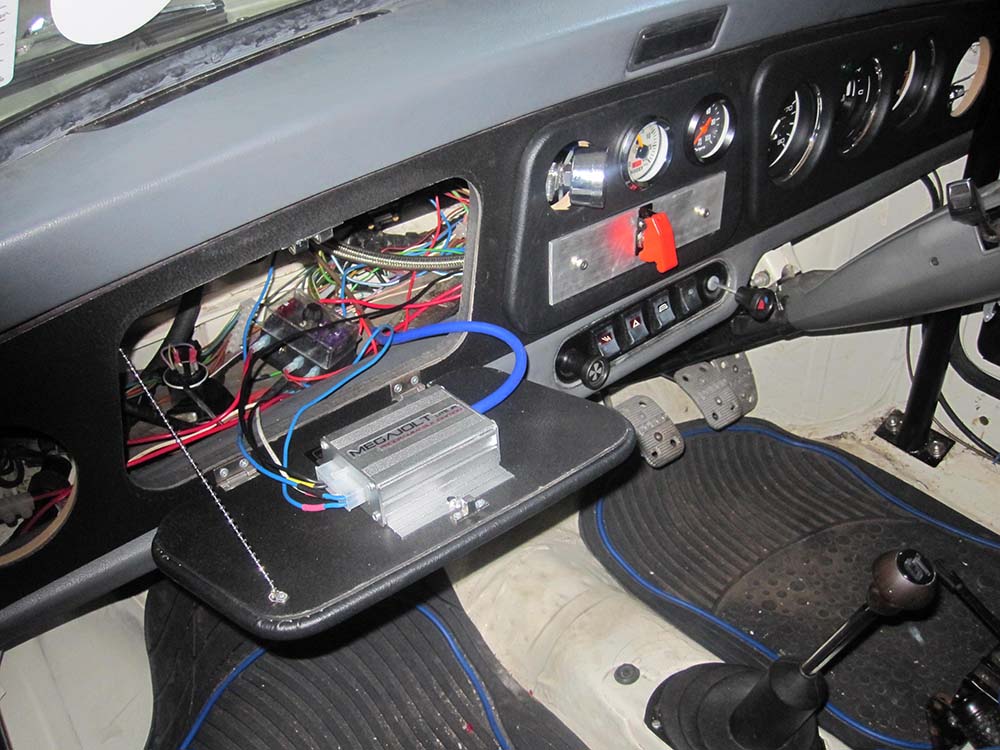

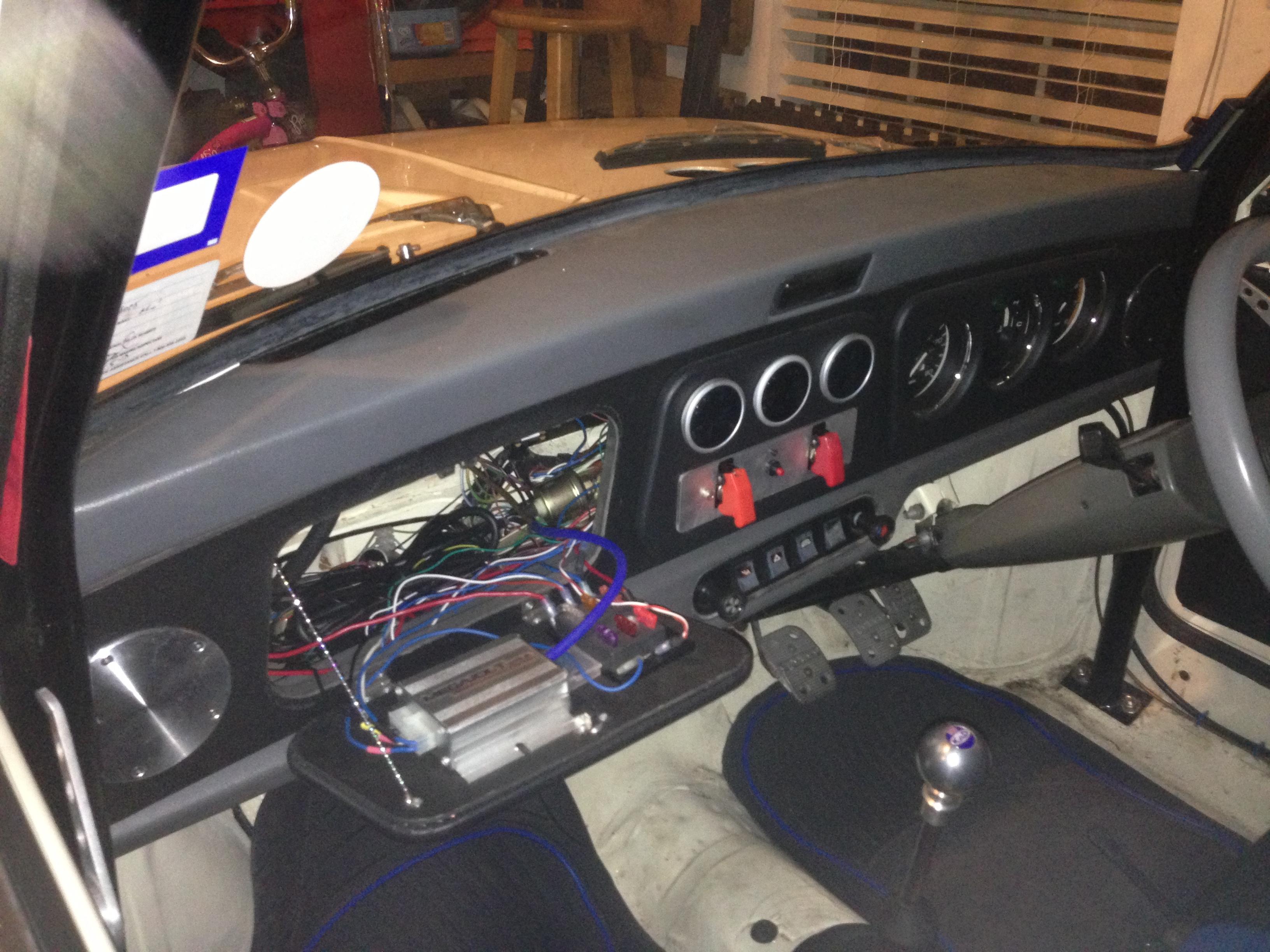

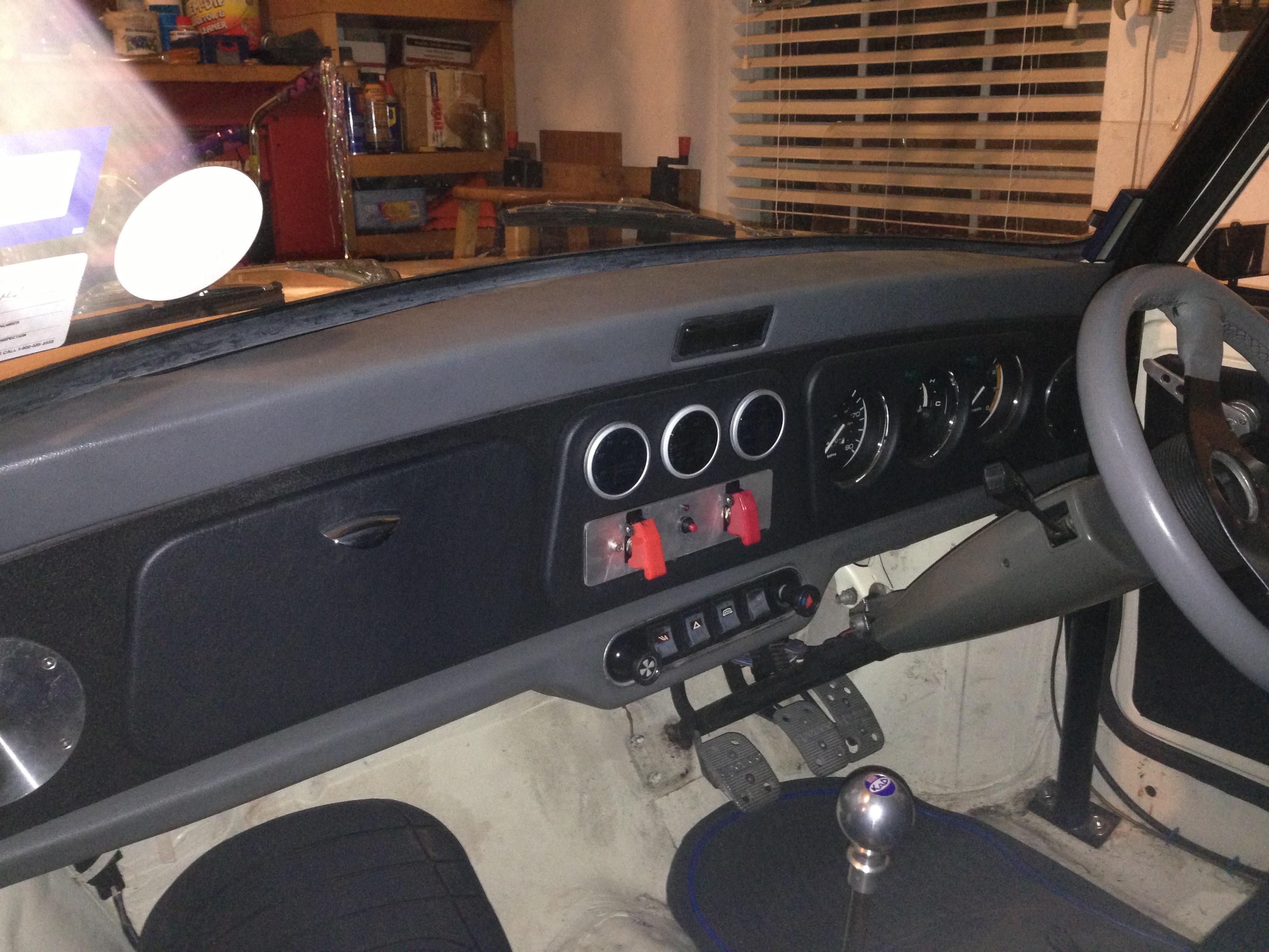

Have also refined the dash and added lambda, oil pressure and matching boost gauges.
Had to add new fuse box too... need to tidy up the wiring though...
Have added covers to the vent holes, old alloy tax disc holders, don't need them now but match the alloy furnature?? (note for the honda boyz you can buy these with "Type R" and the like embrazzened on them, lots of different colours to!). I used 25mm hex head counter sunk M3 bolts tapped through the old front plates (as back plates) on the other side of the holes, may put starter button on the drives side one.
Also got KAD quick shift, with reverse lift lever, which is nice...

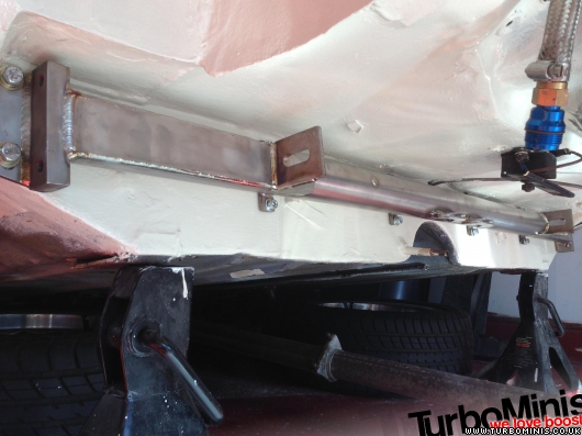

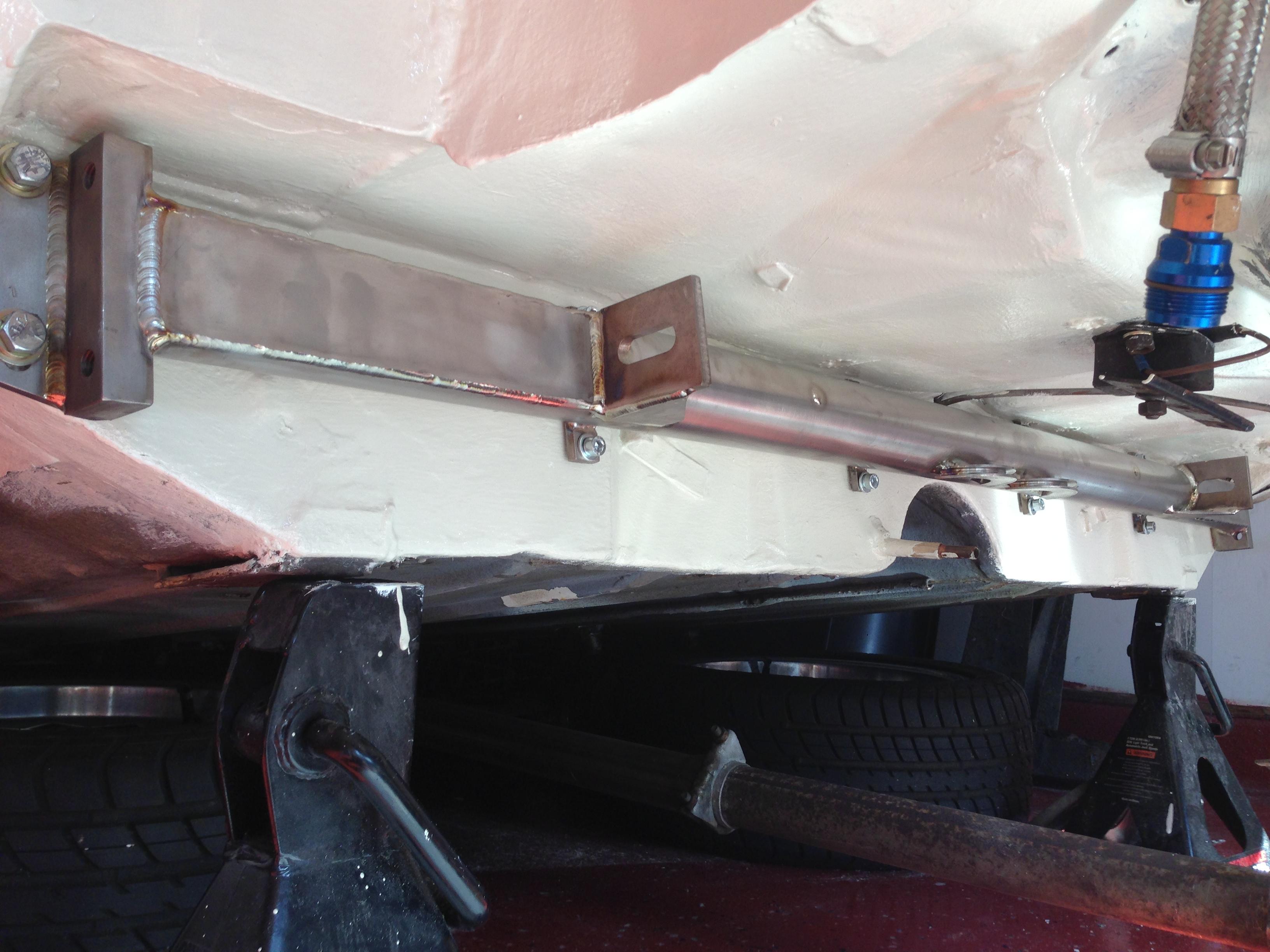

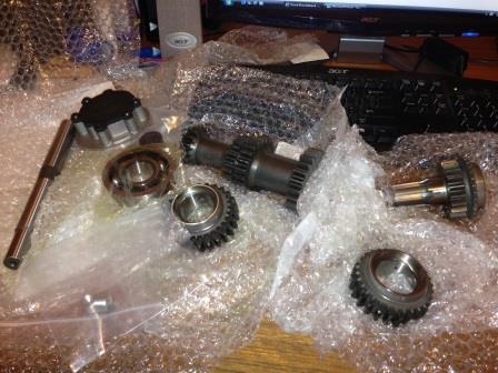

Well finally got all the hard work done in terms of fit up, pre drilling holes and wire brushing and preping for colour matched body colour paint etc....for fitment of the force racing Titanium rear beam...:) Package arrived here in the US quicker than any other order I have made from the UK lol.
Mr Austin you have excelled yourself again *smiley* the beam came with more enhancements than advertised and complete with all the nice fasteners....
Basically replaced 14 kilo subby with 3.5 kgs, which now also includes integral HB quadrants, nice touch Carl, nice surprise...
Also will be replacing spax gas shocks and hilos with alloy protech coil overs, pictures to follow, but basically alloy coilover with springs weigh in at 2/3 of previous set up, now plus minifins, I will be dropping pratically 40 lbs off the back end....*tongue*
