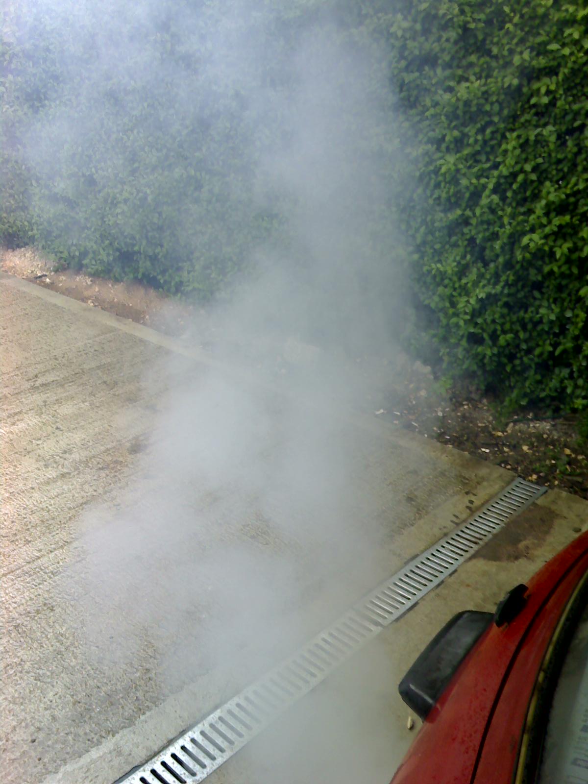

sorry for digging up an old post, was this problem solved... mine smokes at idle like described before but i have only noticed it doing it when its warm (the turbo) and it wasnt doing it a week ago when i last had it running any one any ideas

the turbo is like 300 miles old so i hope its not, but the oil return pipe seems to kink to one side prety bad, i wonder if its stoping the oil to return free enough causing high pressure in the turbo?
sort the kink out bret
if the engine is known to be ok
then when the engine is idling!!!
hot............ if it smokes
the blower seal are Goosed!
Bat

Restriction in the oil return will cause it to smoke like a train.
Common fault on Fiesta turbos for some reason.

ahh all fixed up the oil cloud out the exhaust WAS the kinked oil return pipe VERY VERY hard to replace with the engine in the car lol
i knew the turbo unit was 'brand new' cause it was shiny :)
(and had the recipt for it when i bought the engine)
any one now wanna guess the problem with the next one? lol
the cloud comes out the breather still, its getting better though is it due to it not been run in full yet?
i personaly put it down to blow by because when its reved lightly the smoke stops and when u lift of the smoke is slightly worse any one have alternative thinking?
