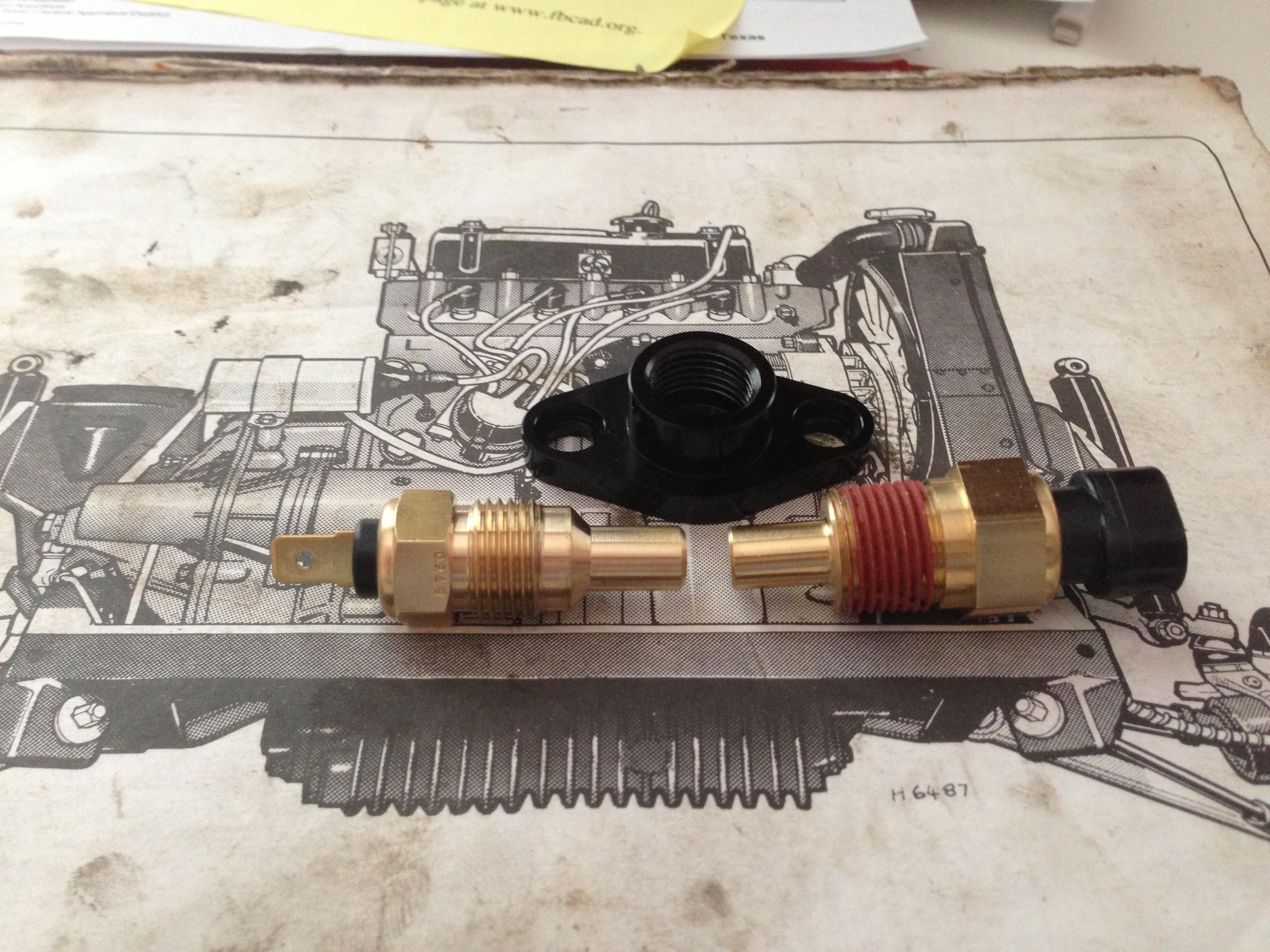

I took a picture to show the difference, the one on the right is from the GM one Autosportlabs site, and will wire straight into the MJ, the left is the early classic mini one.
Could you post up the 0-256 Degrees vs voltage chart please for the GM one ?
Thanks

KLAS
89 Posts
Member #: 2380
Hamburg, Germany
the threads per inch doesn't matter. basicly you remove the threads of the GM sensor and then you have the right diameter to cut the 5/8 thread.
