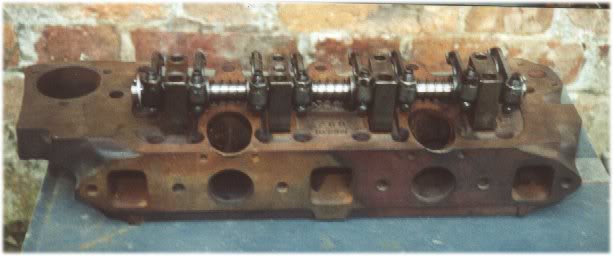

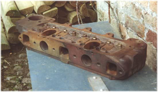

i remember seeing pictures of a head that had new ports cut down at an angle from above
inlet ports went down through where the rocker cover would have been
anyone know what im talking about?
Carl S
1927 Posts
Member #: 1761
Stalker
Probably the Weslake 8 port head Brett, IIRC.
I know exactly what you mean Brett, it was a really odd cylinder head!
nope not the westlake this baby -
edit- i actually thought the top port was bigger and split in to individual cylinders and the original inlets blocked but apparently not
Edited by Brett on 6th Jul, 2014.

That looks crazy how dose the intake mani work?
It would burn a shitload of oil *laughing*
I saw one of these in the force workshop what, 12, maybe 14 years ago... Perhaps he'll grace us with his knowledge
