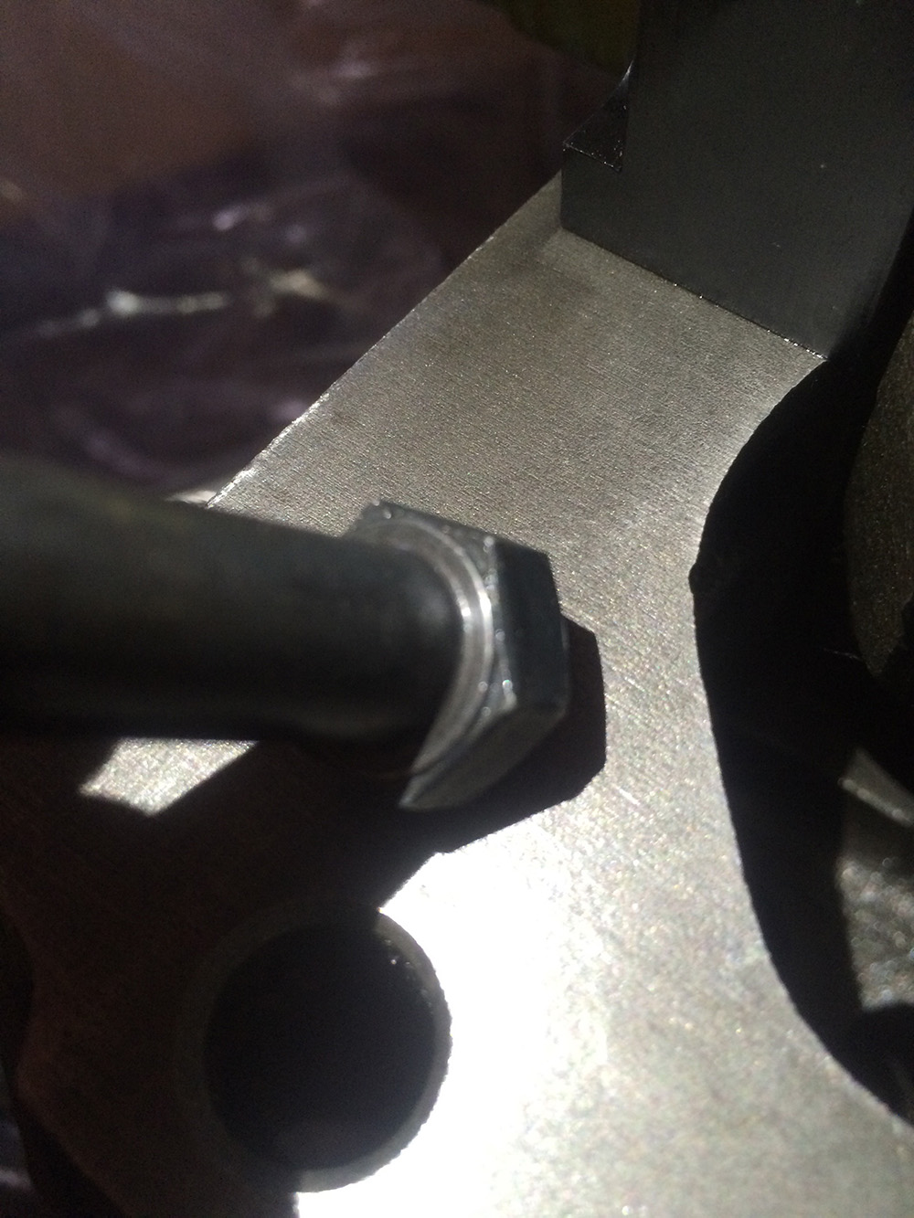

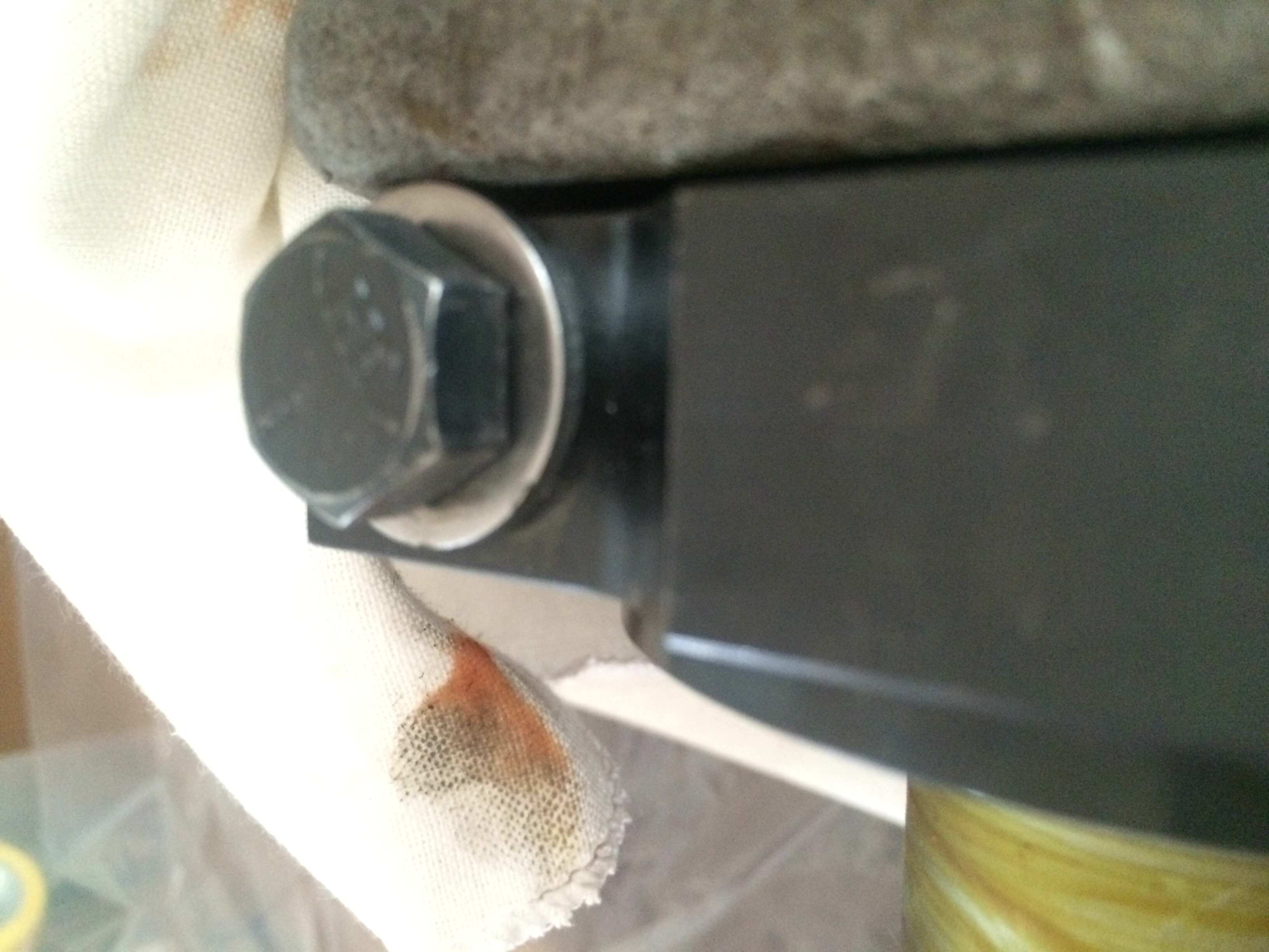

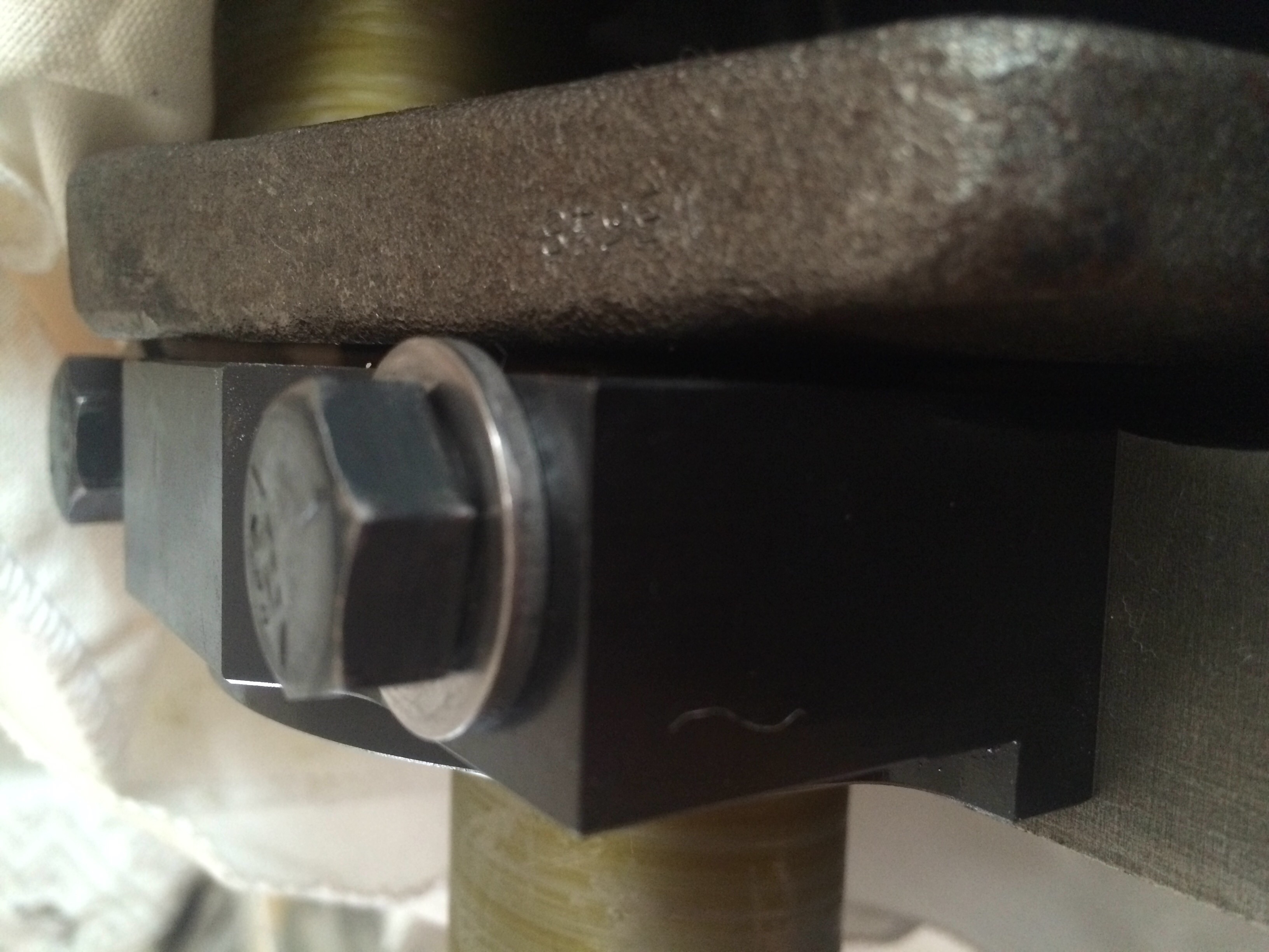

Got it back today and the overhang on the washers on both the outer main caps is so large that it makes contact with the crank (and stops it rotating)
Now I struggle to believe that the machiner missed this and if so how accurate do you think the machining is?
They are bolts instead of studs and only the 4 centre main cap bolts & washers where apparently supplied with the kit
Just now really nervous about the quality of the work as its to thousandths of an inch
Also had the block rebored, faced and crank ground +10
The washer is also pushed as far away from the crank as possible in the pictures too
All dowels lining up etc.

I would take machine the wacher to fit. Or no wachers at all.

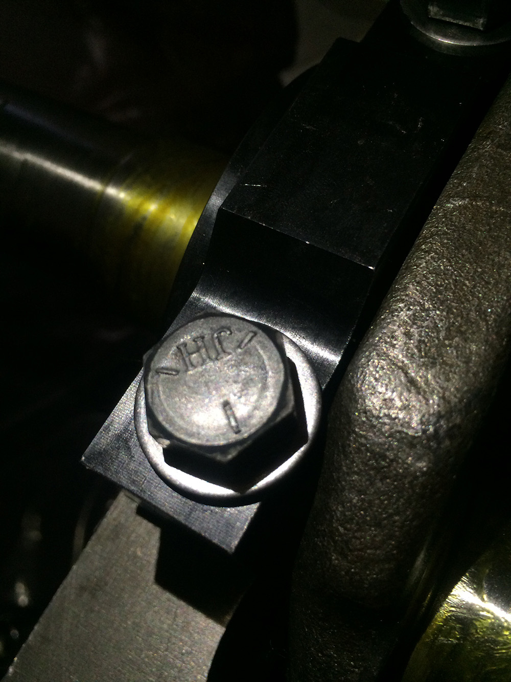

Going by the photos alone. those washers don't seem the right sort at all for the bolts used.

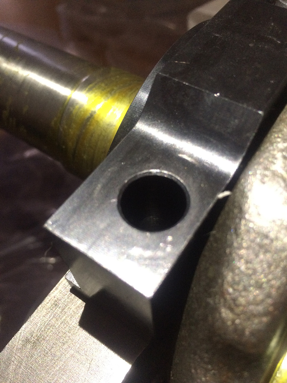

Can you photo the underside of the bolt head and the cap top face where the bolt would land (without a washer).
And the markings on the bolt head.

Firstly I wouldn't use a washer.
Secondly, are they the correct tensile strength bolts?

On 9th Feb, 2008 clubman GT said:
Hi all. Must concure with prievius posts, 8.8 is a metric grade, hence is found only in metric bolts. 3 lines is grade 5 not near good enough. 6 lines is grade 8 as per factory.
Mark
Oh god.... *frown*
Can anyone confirm this as I'm abit out of my depth here!
What should I do next

Yes those bolt are not good enough
Where did you get the caps?
I dont think theres too much to worry about tho, ditch the washers and buy an ARP stud kit. If your going to the trouble of having steel caps then might as well go all the way and fit the studs too. If you really must have bolts then just buy 12.9 cap head bolts (allen heads)
I dont really see it impacting on the machining. You cant blame the machinist for the caps being supplied with dodgy bolts and chocolate washers. You would have thought they would have said something i guess but then again you wouldn't expect to buy a set of caps and have them come with those fixings.

It is always hard when this happens. you hope the people did a good job but in the end you need to check everything and measure everything before you build the engine. Half the time you need tools that are expensive and where the handling is not trivial if you want to measure properly.
I know that does not help, but been there done that..and burned a few times
The mains are very highly stressed. You are talking 780 G in compression in the rod at a mundane 5000 rpm (in this case the direction that pulls on the bolts) and almost 2000 G at 7800. Ergo it better be bloody tight!
The basic premise of any bolted joint is that it pulls the rod/bolt to a certain tension. if that washer crushes (i.e. it is soft) the tension is gone and the joint is loose (and parts start to do the cuckoos clock thing).
I would rather have a shouldered bolt (like a build in washer). Or have the proper grade hardened washers.
(As Slater said: get a set of ARP studs. expensive but still a lot less than a main that is on the loose)
IMHO it is Weird/pretty improbable that it does not uses dowels/bushes for the cap positioning. normally the caps are a very tight fit on the dowels/bushes/registers (whack them on with the palm of your hand or a copper hammer). The bolt should pull only, the dowels should hold the position sideways very firmly (plus friction due the the pull down) .
So even though the size might be spot on after machining you still have to make sure that you get the cap back in exactly the same position after bolting the whole lot together. a cap than can move at all when positioned is imho definitly wrong.
The scuff marks on the cap suggests that it is pretty soft (first pic) as well.

1 The underside of the bolt head is intended for either a small diameter hardened washer or direct on the cap face.
2 It can't be the cap face as it has a chamfer around the bolt hole.....
3 Bolt grade is definately wrong.
4 If there are no sleeve dowels (or real dowels in the caps) and the bolts are loose in the cap holes, the line boring (if it was ever really done) is worthless.

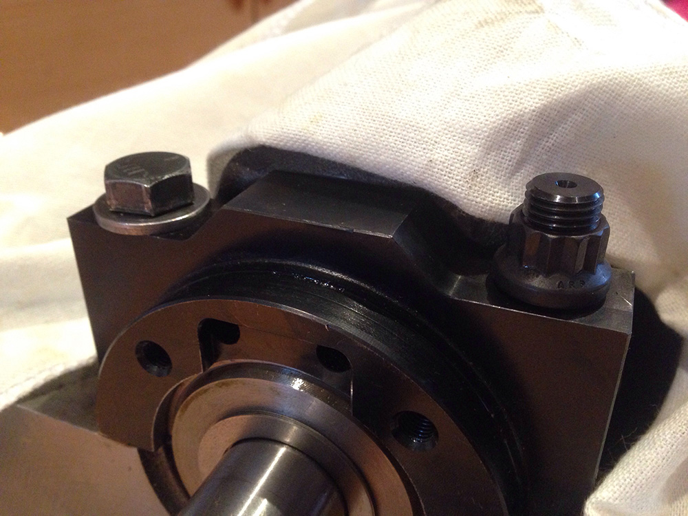

And as the bolts are the wrong ones I've been given arp studs & nuts
So I guess just see if they fit

For the bolt markings, just google it. The ones you photo'd are low grade.

Next question is , is the clearance of the stud from the top of the nut ok?
As ive got conflicting info from MED
One is an email saying
To fit the AFS stud kit the hole in the block need to be drilled deeper, so that when the cap with the nut is fitted onto the stud there is no stud protruding out of the top of the nut
But a picture on their website shows different
http://www.med-engineering.co.uk/catalogue...es/_MG_7309.JPG
Cant confirm as they close at 4 *oh well*
what a faff, hope its worth the effort!
Edited by Will on 29th May, 2015.
okay, had a bit of dealing with studs,
you will need to relive the gearbox to clear the front and rear mains studs, but TBH, that stud looks very long, doubt you'll find the clearance.
personally I would cut the studs down, as drilling & taping the block deeper will be a faf. I belive the ARP set is actually designed for inline engines....
I have used the minispares uprated cooper S stud set, much better length wise, but a bit till needs to come out of the box... also to go in the non S block you need to turn the shoulder off them to clear the dowels.
talking of Dowels... Swiftune do some nice billet ones that are thicker, for under 20 quid,
when machining/cutting the studs, keep them cool so not to temper them!
