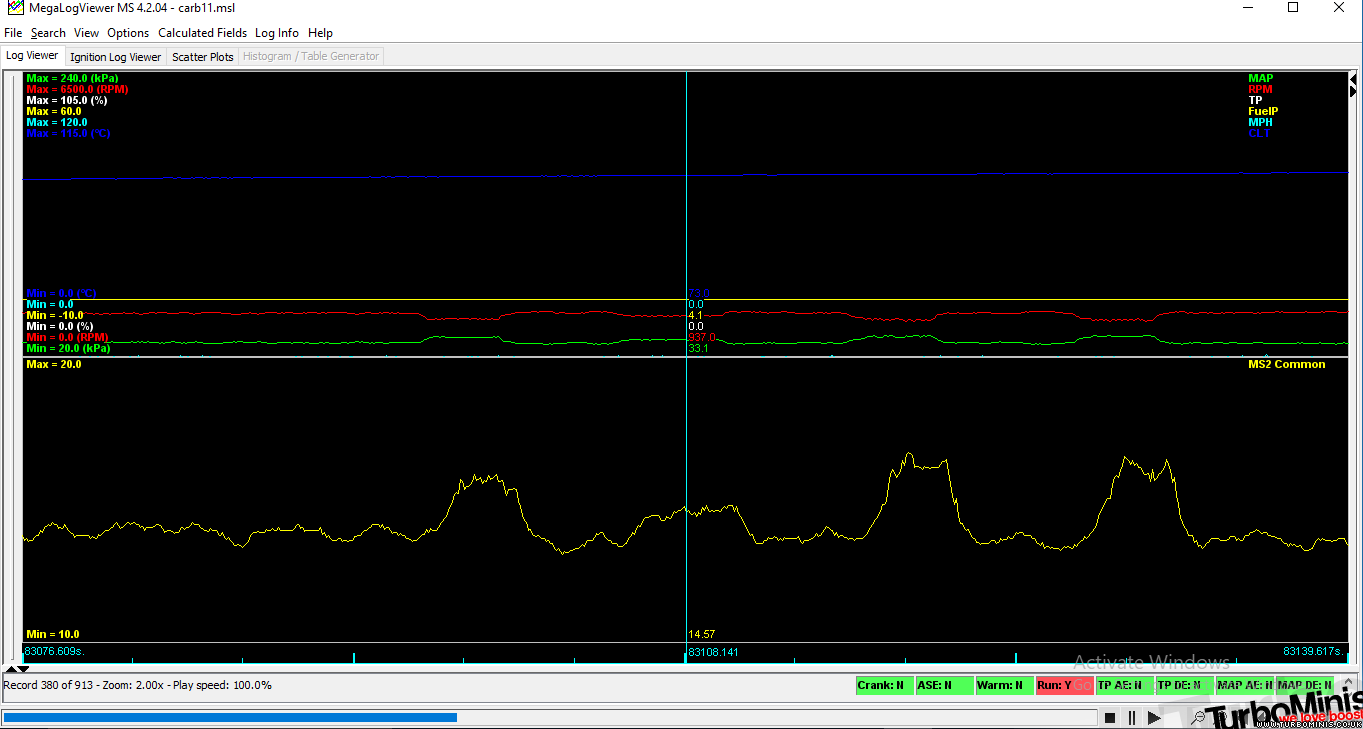

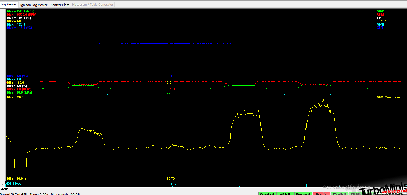

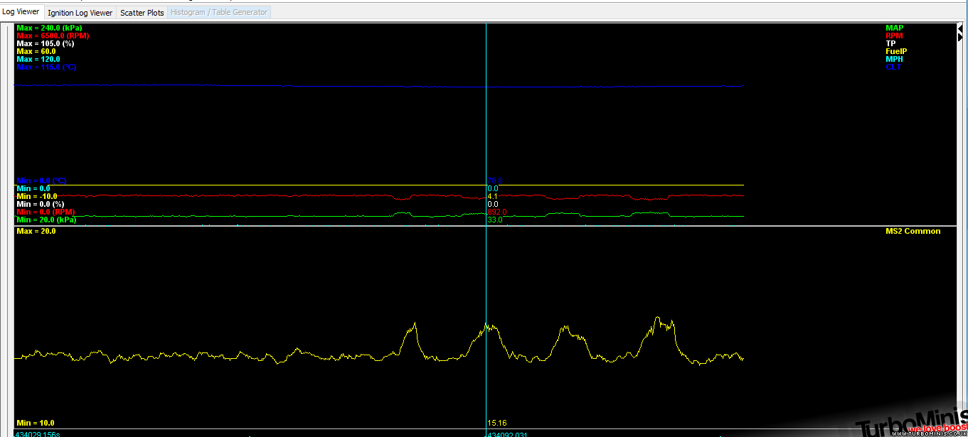

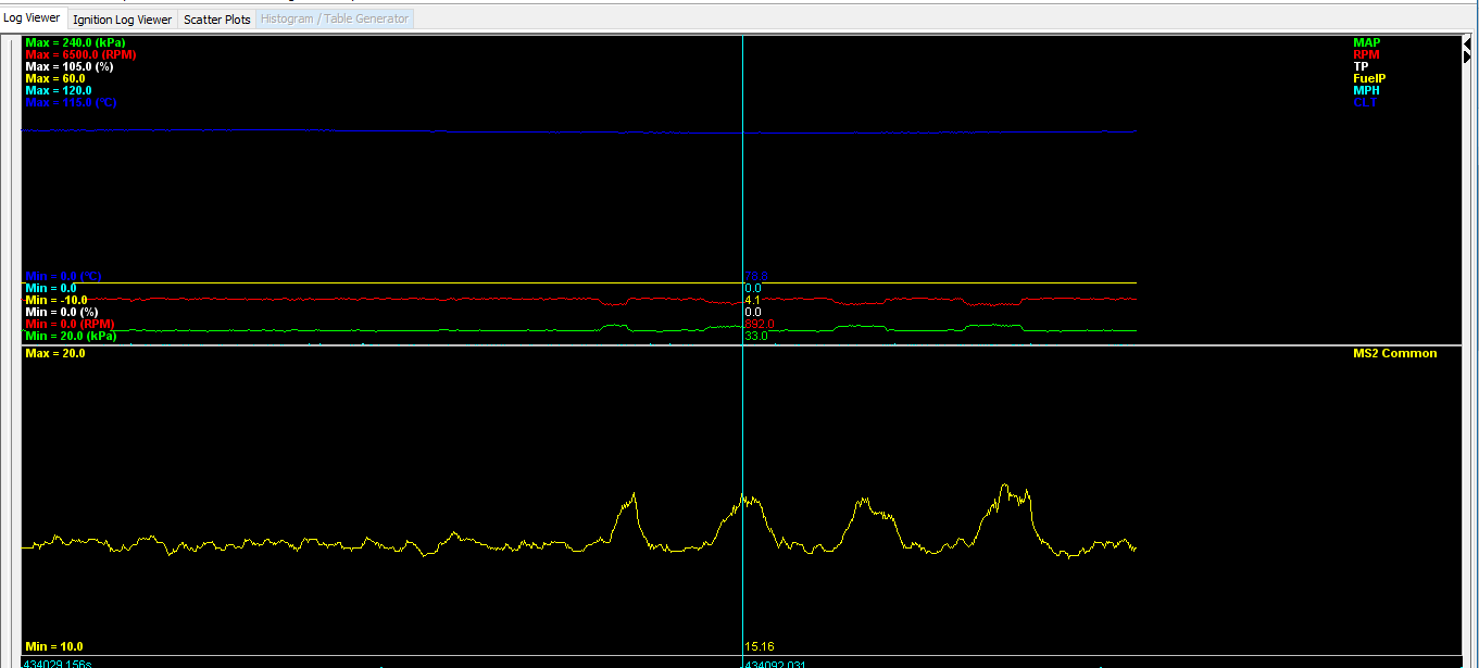

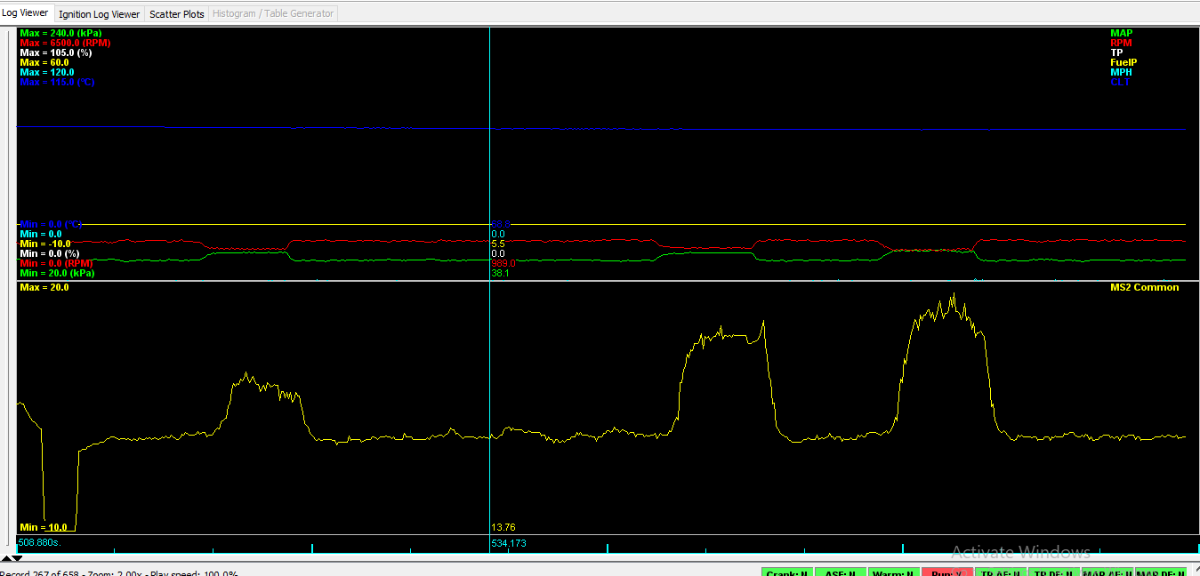

Ultimately I realised the odd note of the engine and lack of performance meant a problem, so I started pulling HT leads when I got back from my drive out and it appears Number 2 cylinder is not doing very much at all.
In the below you can see a log where I have pulled each HT lead in turn, 1 to 4 and the result: drop in Rev’s, rise in MAP and lean Common AFR each time.
That is all except where Number 2 HT lead being pulled should be. The Marker line should be centre of the 5 second interval the lead was pulled.

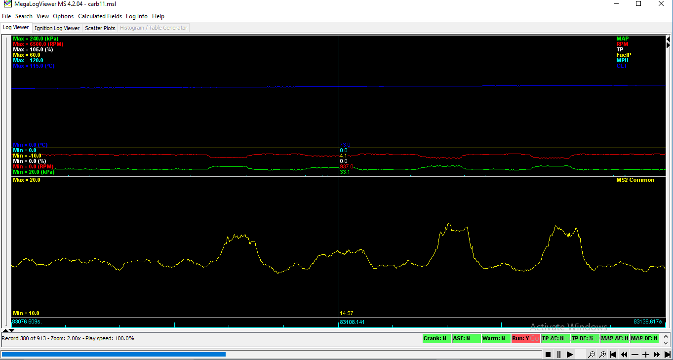

I’ve only just got it started up tonight, but logging looks much better:
Hopefully I can now get the car out for a run in the next couple of days, as long as the weather is nice to me, ready for a Dyno Session this coming Friday. *smiley*
