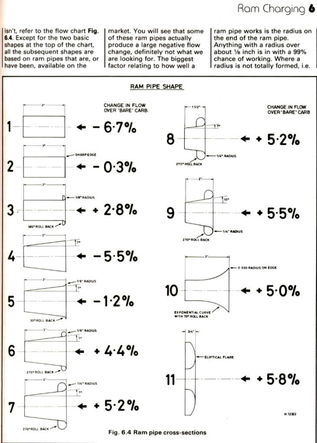

The vizard book shows a large diameter short depth elliptical flare to flow best, see image
I reckon the statement "anything with a radius over about 1/8" is in with a 99% chance of working" is a good one to employ here!

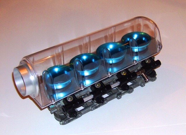

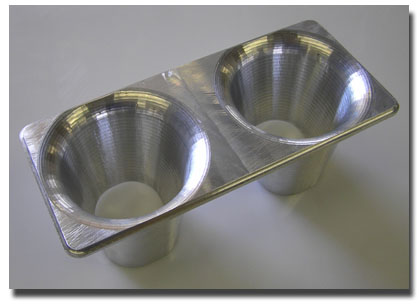

i think any of those picture would be fine Neil, i would not bother with a taper personally .just keep it simple ,with a nice lip.

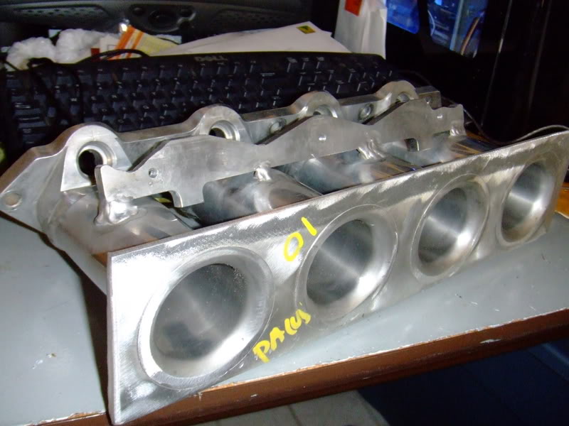

10mm flat plate witht he holes radiused with a router bit?
It worked for my original X7 aluminium cobble together:
If you can get the router to stay flat/ level...
