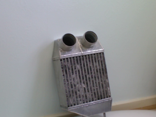

The problem with small IC piping is that at some point you will probably end up going up a size to fit the IC inand then down a size if you want the smaller pipes. Best thing is to get an intercooler, mount it and then make a decision on pipe routes and sizes.

Thats what im now in the process of doing, I have a cooler which the take offs are 2 1/4", im using a T2 which the air outlet id is 1 1/2", 2" od, and using the metro plenum, so I have a mish mash of sizes. Who on here makes the plenum with left hand pipe take offs?? have seen the pics and believe it would make my life soooo much easier! lol.
