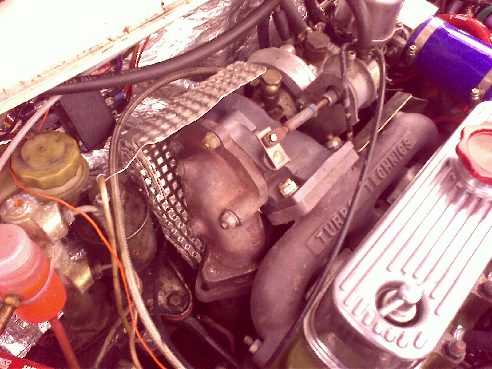

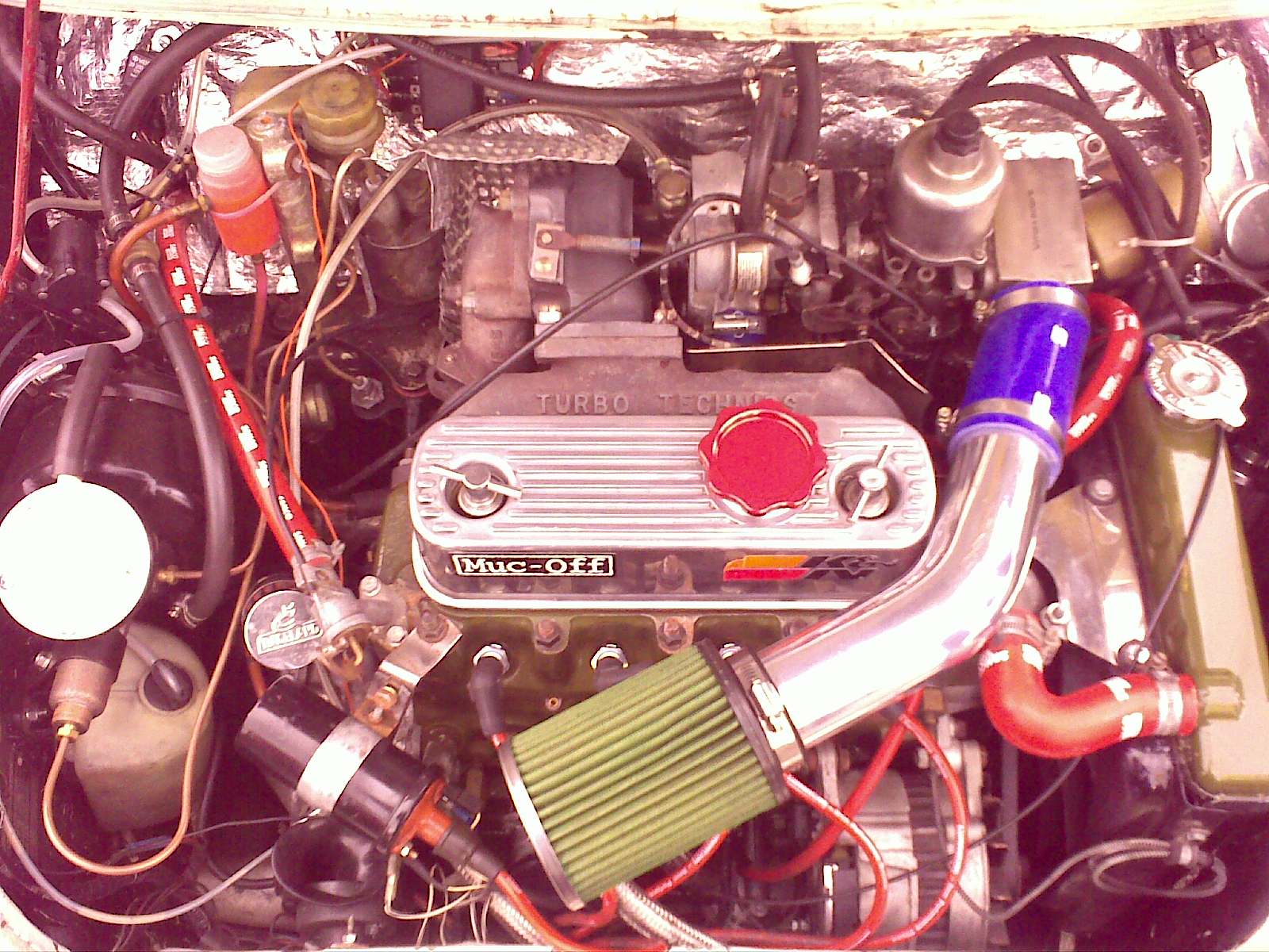

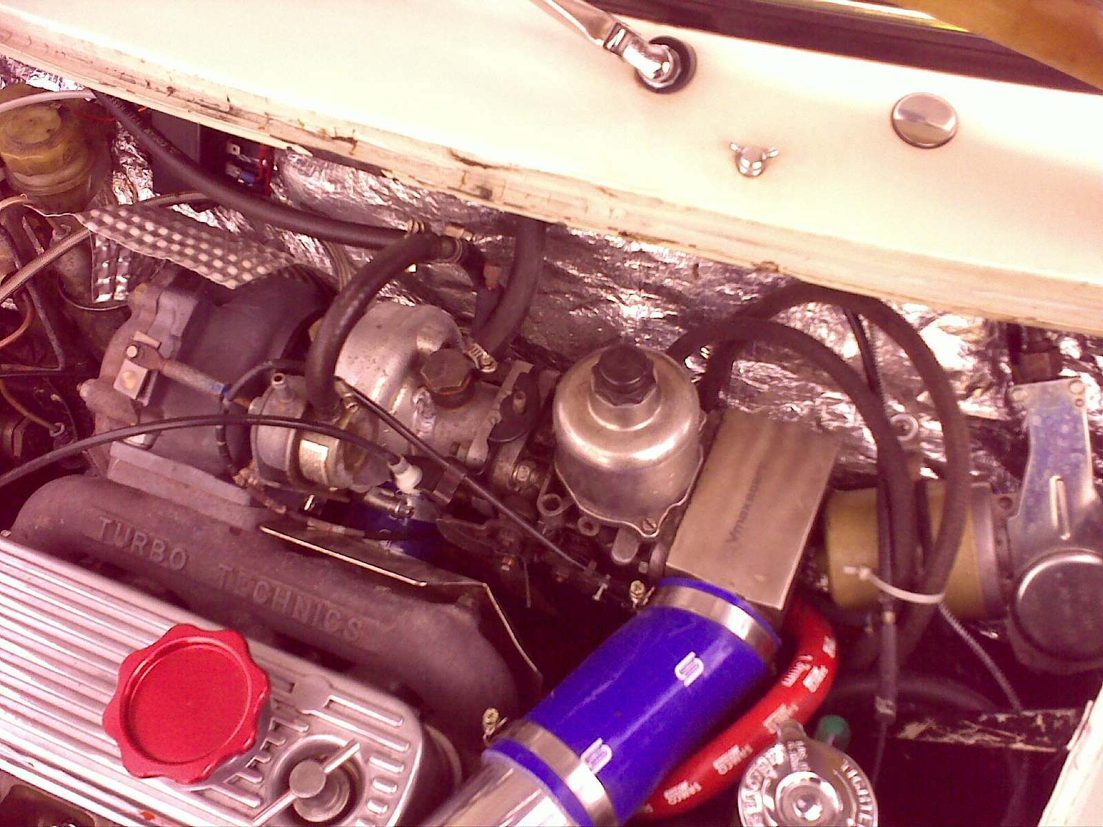

I've addeds some pics of his van and some detailed shots showing the clearances etc. I recommended he became a TM member, can't remember his name though.
Would be a relatively straight forward job by the look of the parts involved. The previous owner had fitted a NA HIF44.
Personally speaking - looks like a bloody nice job and if you do decide to sell, it'd probably make quite a bit due to its potential rarity.

thanks for the replies, i agree the inlet manifold does look restrictive but after seeing the pics maybe it'll be worth fettlin as it looks great!

I have just bought the full set up off the van that turbominivanman put pictures off, going to be running it on my 1293cc, still trying to get my head round the set up as its like nothing I've seen before!
