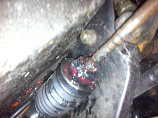

Having never replaced a steering gaiter before, I was a little surprised when the kit didn't have any grease, like the red stuff oozing out of this. My local motor factors were equally flummoxed and advised I used EP90 gear oil instead. Hoping to get it done this afternoon.

i'm not sure how you will get gear oil to stay in while you fit the gaiter! I'd use a bit of grease.
The original specification was for EP80 or EP90.
So long as you jack the car way up high on the side you are changing the gaiter, it's easy to dribble the heavy oil in (slowly). It just runs to the other end.
EDIT - BTW, red sounds like automatic tranmsmission fluid or power steering fluid - definately not right for a Mini steering rack. And it may not be compatible with normal EP oil (or grease)
Edited by Rod S on 12th Sep, 2011.
Rod, i'd suspect its that red grease that is in it (don't ask me for the technical spec though!)
Rob, you could be right, some red rubber grease left over from fitting the previous gaiters.
Usually red rubber grease is only used in small quantities on things like wheel cylinders, just for fitting the seals really.
Although someone may have packed a whole steering rack with it.
I am fairly sure that was a recon rack fitted not that long ago, I have come across lots of recon companies who use red grease on items like this, no idea why really.

Yes, I know the rack was done recently, which was why it was so weird one gaiter was completely knackered and the other in good condition. Brown grease near the steering column, red towards the outside. There was stacks of grease still there so slipped the new one straight over. No room to fit any EP90, so gave it a miss. Nice to have a simple job for once!
