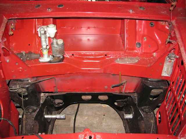

Mmmm..............plumbing:
Turbo drain has ended up a bit short, so need to sort that.
Now onto the actuator bracket.

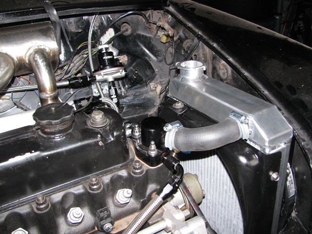

Wet day, slow workwise and a bit of progress :)
Radiator fitted, although it will have to come out again to make a bit of clerance with the wing.
Fuel pipes made up and regulator fitted.
Need to complete the heater pipework next, sort the rockers, then I can start wiring.

Haha it took a few months :(
Had to cut most of the inner wing out to get the electric fan in :(

Really?? Couldn't you of just bolted it on the other side?
It's bolted directly to the rad so that air is drawn through the rad rather than around it.

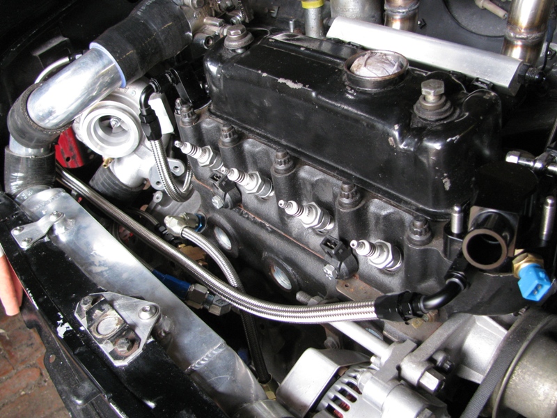

Apologies if it's been asked before but what's the sensor on the head between the spark plugs for?
PhilR
696 Posts
Member #: 10034
Birmingham
Those are knock sensors between sparkplugs 1-2 and 3-4. Will be interesting to see whether the one furthest from the timing chain gives a cleaner signal.
Yes, knock sensors.
Discussed here:
http://www.turbominis.co.uk/forums/index.p...tid=545295&fr=0
It will indeed be interesting to see what noise they pick up.

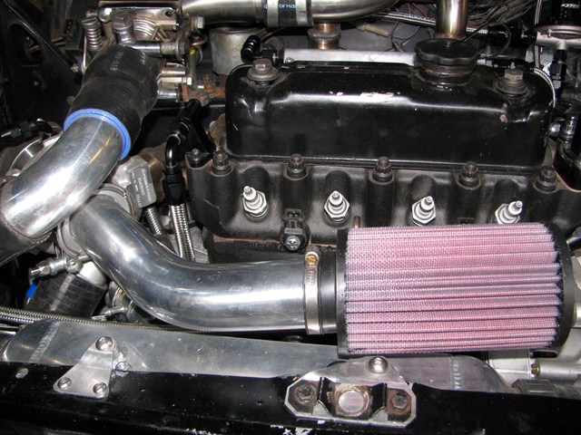

Air Inlet pipe today, amongst other little jobs.
I'll be interested to see how you get on with the knock sensors. Did the MPI's ever have one fitted?
I don't believe that MPis were fitted with knock sensors.
Setting them up is going to be quite a learning curve, although it will be configured so that they are only needed when something goes amiss.
