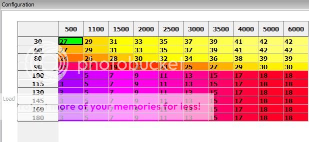

If it is rich across the range a tweak of the mixture screw migh improve matters until you get back to the roling road.
Wow! That map is a light year out especially in the purple area... Craig. Why is the timing so retarded at that point. ?
Craigie-B
1492 Posts
Member #: 9468
Wootton Bassett
I dont know *frown*
Its based on the original dizzy map from james fawcetts site.
Slark couldnt really set the car up properly as it was burning oil like there was no tomorrow when we were there so he did the best he could at the time
Its a poor curve if that is from a dizzy

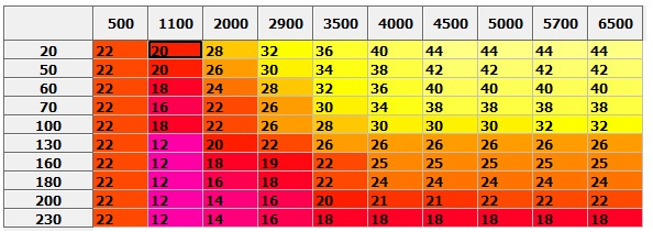

It was modified a bit from the original map:
Have a search for the vans map and put that on it
there you go!
Craigie-B
1492 Posts
Member #: 9468
Wootton Bassett
I had that on it before and it just wouldnt rev about 500 rpm flat out, as soon as I put the dizzy map back on it rev'd again :/
Is your timing right? Check your trigger wheel with a light, it should read the same as the display on the mj software.
Craigie-B
1492 Posts
Member #: 9468
Wootton Bassett
Yeah slark checked it, and said it was a couple of degrees out so changed it on the software
Did he change it the right direction?
Craigie-B
1492 Posts
Member #: 9468
Wootton Bassett
I assume so, I had already changed the map back to the dizzy map the night before we went to slarks
Be very very sure that the trigger is calibrated correctly or you can easily damage the engine.
If at 15 degrees advance at idle, it wont idle, it needs more air, not advance. If after adding more air, it is lean, it then needs more fuel.
Basic tuning.
andy that map shit me one omega I had to back it off no power drop at all after doing so.
modding the map which I will put up shortley, I basically dropped all the figures a 10 psi and under 8 to 10 degrees roughley its a a hot map if you are running compression figures at 8.7:1 or above
