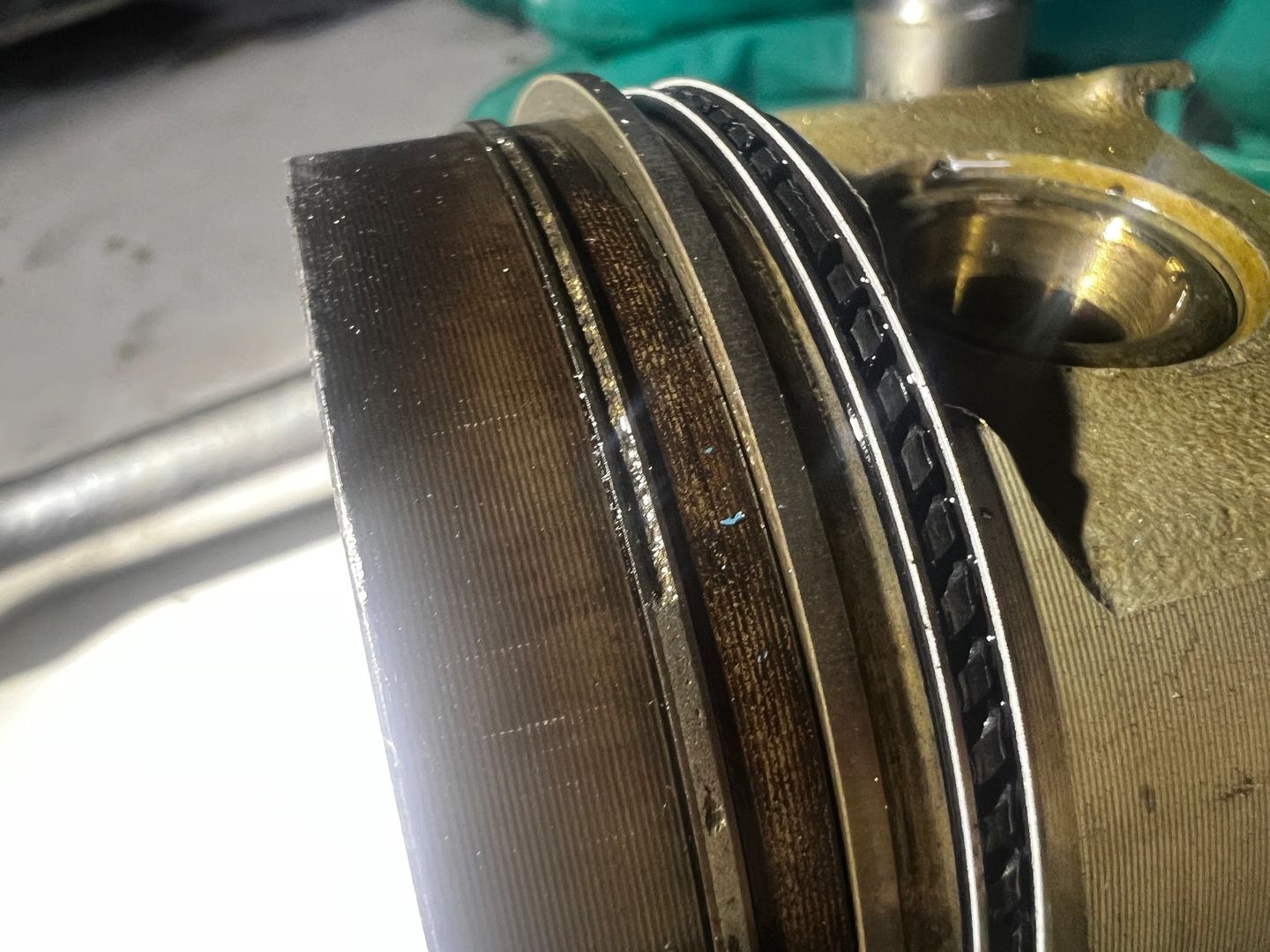

and some wear on no3. piston
1275 EFi Turbo
Steve220
257 Posts
Member #: 11017
Shropshire
Ooof a bit of detonation there!
