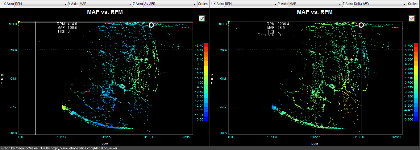

Fueling is nearly there:

Autotune is great. Get a nice stable tune, change a part or adjust the cam, then see exactly where the VE changed after a quick run. Can't wait to get mine up and running again.
There's a bit more to it than just Autotune. We need to adjust the fueling balance between the inner and outer cylinders by changing the injection timing but the Delta AFR plot tells us what needs adjusting. Autotune then brings the AV AFR inline.

nice update. thanks Paul. Are you able to change the range on the afr scales to show the variation a little more? e.g. so -2 < delta AFR < 2 is used?
1275 EFi Turbo
You know, I did not realise that you could do that. Gives a better view of where the injection timing changes need to be made.
I'll update, with more precision, once we have done a bit more tuning.

yeah sometimes you get only a few outliers so the auto scale makes everything look quite dandy, when in fact the majority is out by more than 1afr but doesn't show up that well.It's also useful to turn off the transients and rapid rpm changers.

I've found a great aid to tuning my short pulse setup. You can add custom fields to the autotune in TunerStudio. Simply write in (abs(afr1 - afr2)) > .5
so that only when you have AFRs withing (for example) 0.5, does the auto tune adjust the fueling. I've found this gives me one less parameter to try and get correct. (I don't often have the chance for someone to drive me around whilst I tune and this allows me to tune the whole map on general drives).
