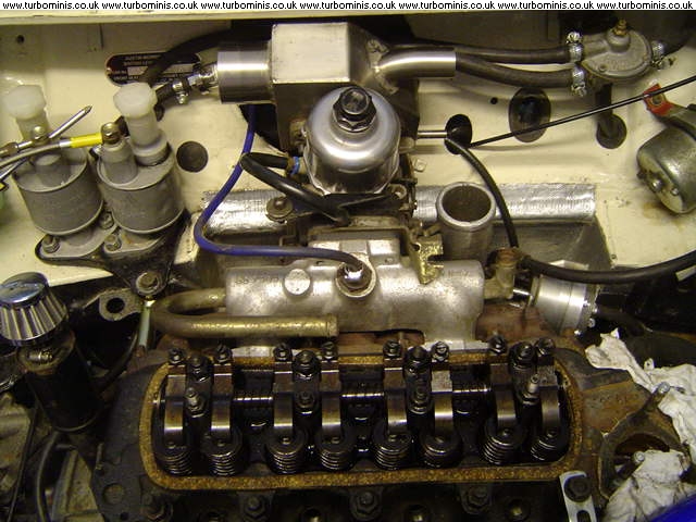

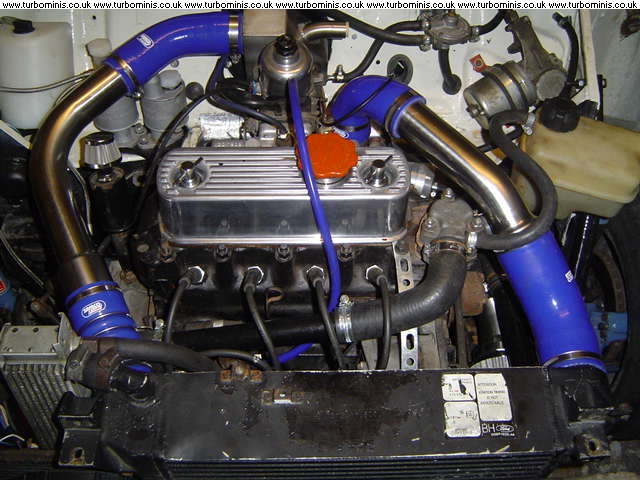

Been a bit busy in the garage this week end, finally *smiley*Another one of Nic s fantastic plenums...*smiley*
Got my hoses from merlin, and stainless pipes from pipe werx, they seem to fit quite well from my instructions over the phone*smiley*
The return pipe actually feels cold to the touch on tick over, god knows how cold it is at 70 lol, plenum gives nice smooth cool route back to carb.

Looking good mate. You've got it easy without a brake servo though! lol

Thanks man,
*smiley*
You really can hear the turbo more and it seems nicer on boost and not much lag, and you get that chicker chicker sound when you change gear.
No servo....
Yep , you really have to push the pedal to stop lol, its quite scary if you have just been driving a modern car lol.

Brocky, It's a very clean/neat setup. I like it a lot!

Thanks guys *smiley*
Must admit, its probably one of the most enjoyable jobs I've done on the car (all clean etc).
Need to get the intercooler sprayed up now.

I must admit fitting an intercooler is probably the No.1 mod that needs to be done if you are using a turbo. imo.*smiley*
