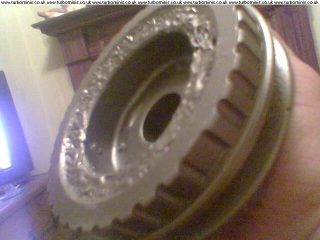

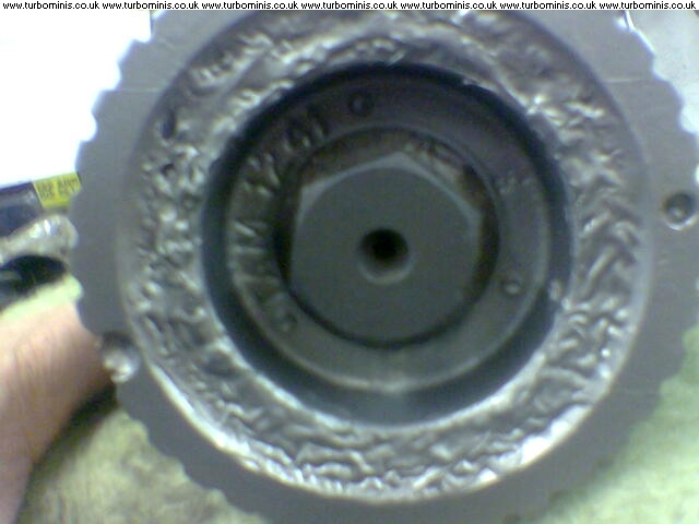

my pulley wheel that fastcarl sorted out for me! all in decent nick! the crap you can see on it in the pic is a special rubber glue i put on for safety on the rubber part of the pulley, at the end of the day these pulleys are'nt new & it cost me £4 for the special glue, i degreased it & painted it the same color as my belt drive case! ok aint it!

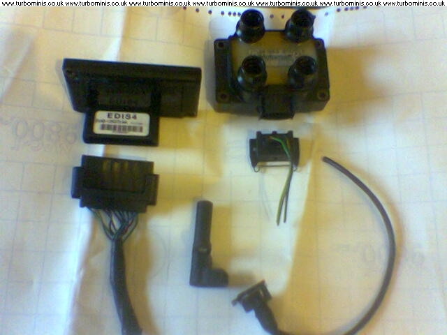

my edis components, all cleaned & hopefully they'll all work, its shit in the scrapper when its this wet & the guy wanted £20 for them, i'm gonna try to get a few sets in my bag next time
if ya have any advice about the edis stuff let me know, i've cleaned it all with a toothbrush & its gong above the boiler 2night to make sure there is no moisture in it anywhere, dont worry i did'nt wet them much i'm just doing it to be on the safe side!

Use a new crank sensor plug and a long enough piece of cable to reach the module, don't extend that bit in the picture *wink*
Plugs are about £2 so not worth the problems it'll cause.
Gavin :)
I have extended all of my plgs and leads on all the installations I have done with no problem. Some with screned cable and some without.
Where do you get the plugs for £2?

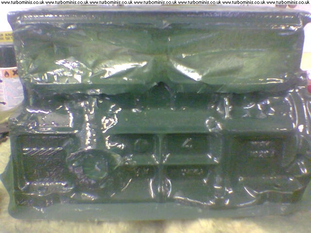

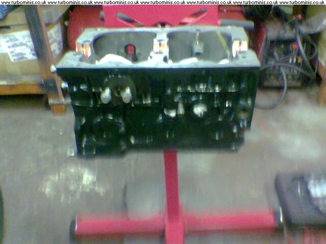

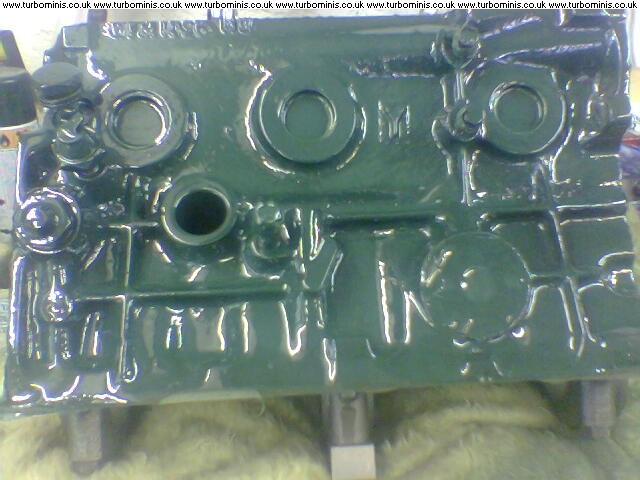

my block after me attacking it with a wire brush on the drill, plenty of panel-wipe then i painted it in dark green hammerite-smoothrite from a rattle-can!
looking better me thinks :)

Always use a screened cable on the crank sensor never join it.
As it's a low voltage signal it can easily be altered by the cable picking up interference, of which there is plenty in the engine bay!
The best type of cable to used is screened twisted pair. Earth the braided screen at one end only (EDIS end) otherwise you've just made an aerial for the interferance!

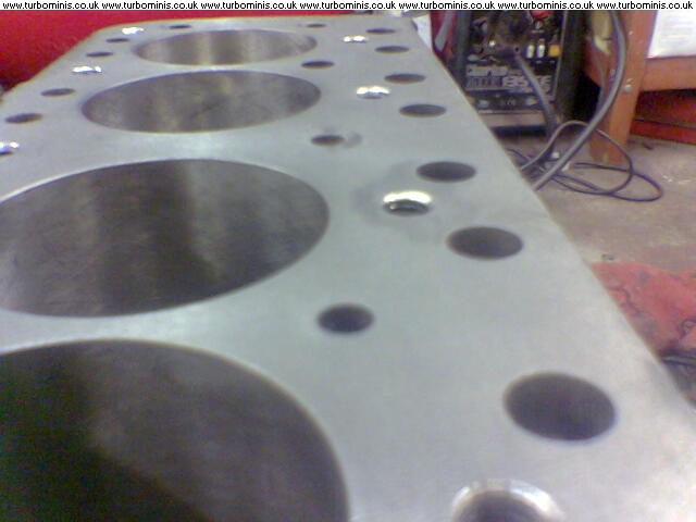

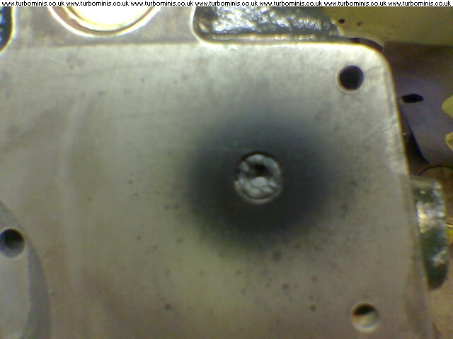

got a steel countersink bit from "good old" B&Q this morn & i've countersunk where the headstuds go by 1mm, all the studs went in & out fine & dandy after so alls well, i was nervous doing this to be honest! but simple enough, have no worries about doiing it again, this whole build is a massive learning curve on mini engines for me!
countersunk head-stud threads

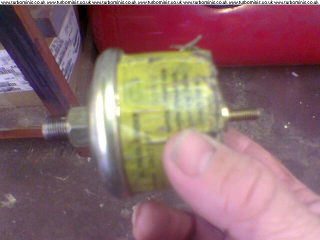

also found some gauges in the garage, i have an electric & mechanical oil pressure gauge's, i think i'll use both if i can to be honest, oil pressure is that importent really is'nt it!!!
this is the sender on the leccy gauge
the gauge itself has 2-wires for the light & 3 other wires, where do they go, i see one go'd to the sender (above) but what are the other 2 wires???

Bat
4559 Posts
Member #: 786
Bermingum
1 is to the sender
2 is to an igntion live, fused please *wink*
3 is to earth, ground, ve- whatever you like to call it.
Gavin :)

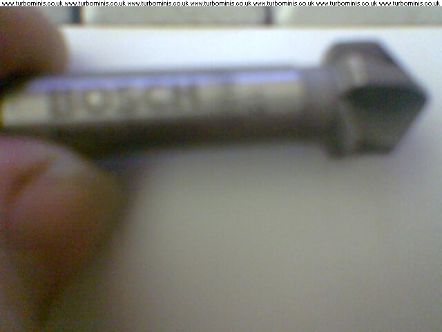

for those that dont know what a countersink bit looks like, i got this frm b&q for the "robbers price" of £9.98
but..........it cuts like butter!!! made super swift work on my block (see pics in the posts above) this will last me a long time as i dont do this sort of thing that much

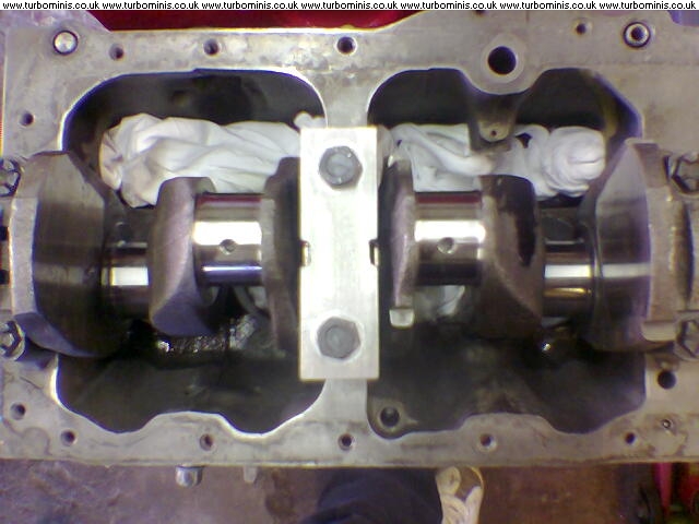

a little more luck today chaps, managed to get some tool quality steel to make a centre main trap that'll work with grooves for the thrust locating tangs! hopefully it'll be ready tomorow! *happy*
i was given the tip to lightly file a radius on the outside edges of my endcaps! apparently it reduces stress in those areas, i dont see it causing any trouble so may do so! opinions appreciated!

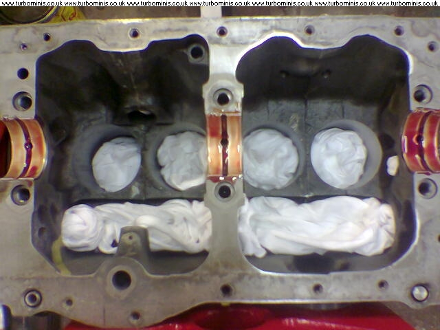

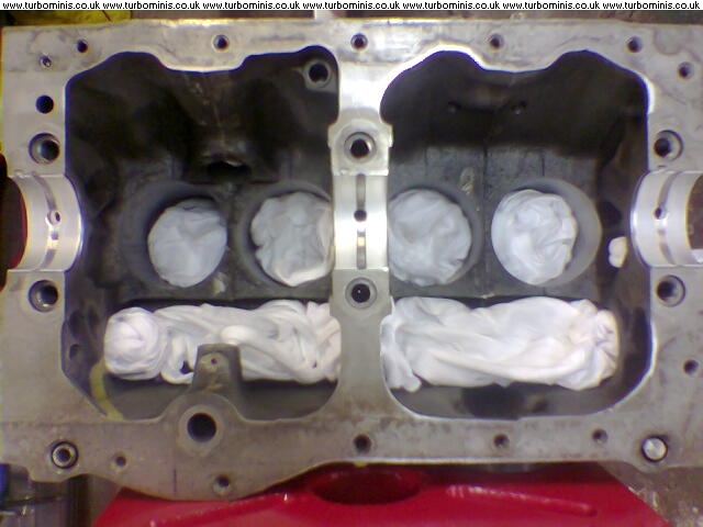

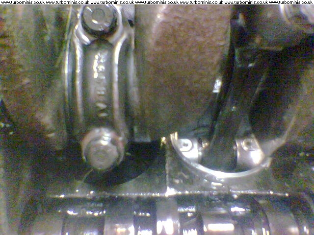

right then chaps the 998 turbo engine build has finally started!!! woo hoo! all seems to have gone super smooth on the short block so far, just have to get seals for my belt drive & set the timing, not sure what to set it at for the mg-metro cam yet but i have a few idea's, i'm stuck with no gearbox for it at the mo, well not strictly without one but i have one but dont know the cond of it, it appears good but it'll be reconditioned to be safe, i'm considering doing it myself!!! it'll get a few upgrades to it aswell like central oil pickup & uprated diff pin at a minimum!!! so here some pics of my build so far
my threaded oilway plugs! sealed in with loctite 243 locking & sealing compound, hope it does seal it up *happy*
block all prepped n cleaned
bearings gone in
lubed ready to accept the crank
a worthwhile purchace engine stand, doe'nt bolt to the mini engine too good but its working ok so far!

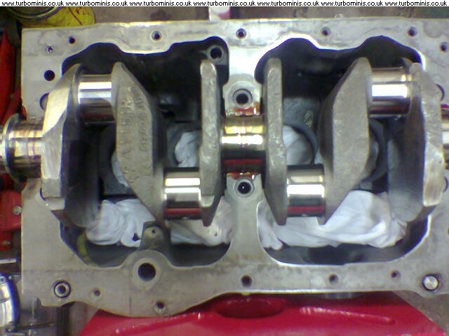

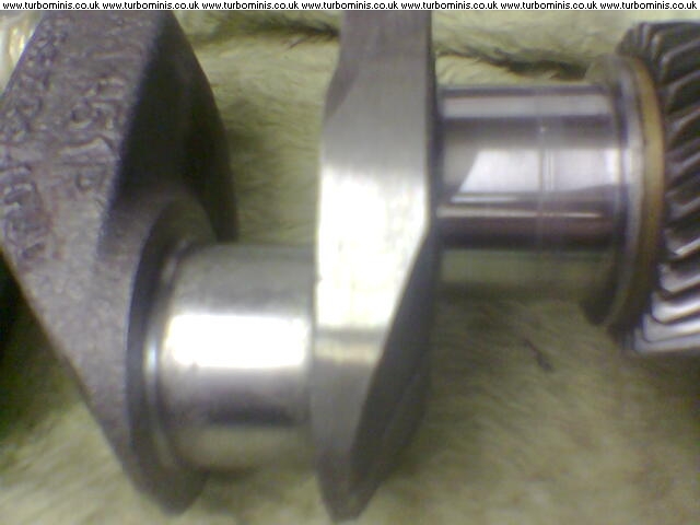

balanced crank laid in!
centre mains strap & main cap in with new thrusts

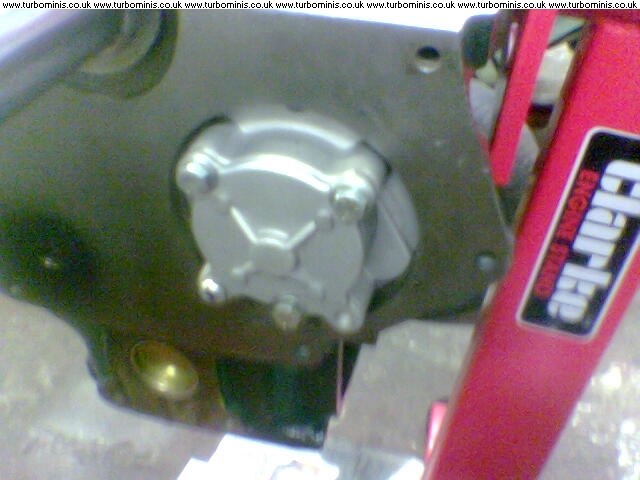

mg metro cam & steelbacked hi-capacity oil pump in, also the engine plate located on with a new gasket

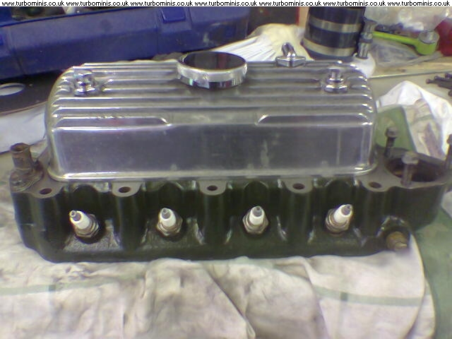

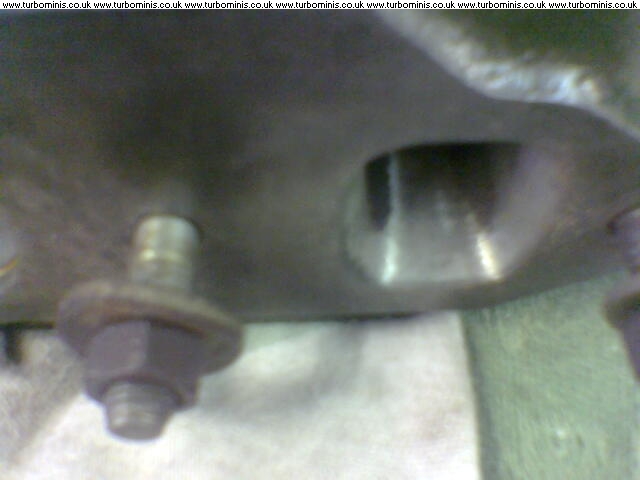

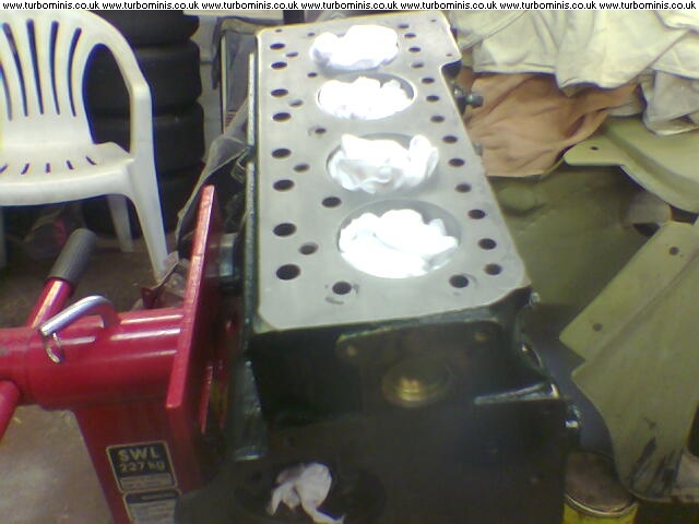

some shots of my 295 morespeed head, lets hope it does the buisness! it has standard rockers, new valves, converted to unleaded as its my daily-driver

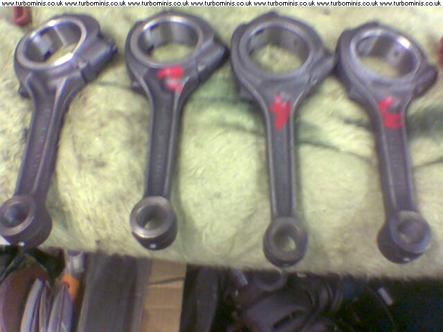

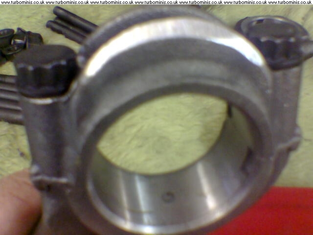

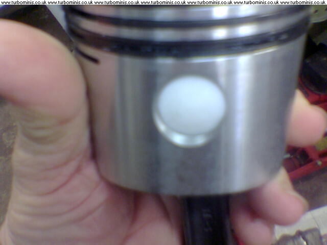

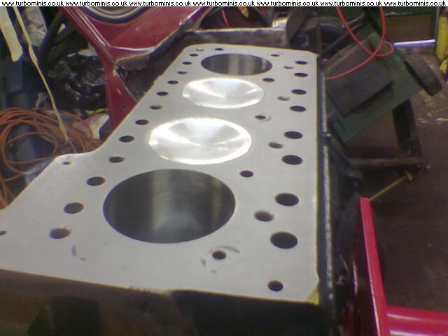

my pistons attached to the rods with buttons sent to me by will"n"ben the fast 998 turbo men! :)
engine inside shot to show the piston & other bits
pistons in, dont worry all four are there :)

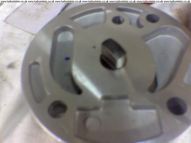

oil pump, hope this is the right one to choose!
oil pump installed with it topped up with lube!

just a little tip for all! when was cleaning my block a casting flash fell off with the lightest touch!!!! that could have held in place & fell into the engine later-on causing tears at bedtime!
be sure to check over your block on an engine build very carfully & i'm a novice saying that!!! i was really suprised to be honest! just something that should have been cleaned off when the block was made i reckon!
