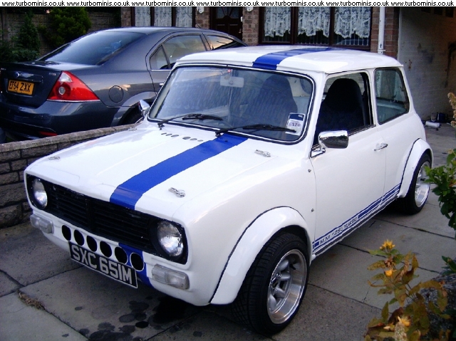

Good work, Heres a few pics from when i did mine. Did yours need this much wag??!
(I left a small lip sticking out about 5mm)

if you want thinner arches as i do then try a front one on the rear ive only offered one up but it does look like it could work. i.e n/s/f put on o/s/r.
this is just an idea and as ive got no wheels on my car i cant tell if it will work?

They dont have a name, i made them myself.

This one looks like it has had complete new arches (made out of oil drums ?)
