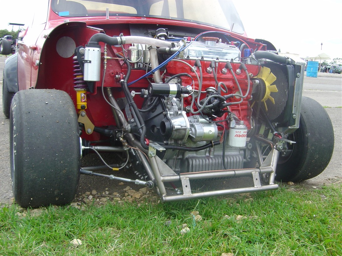

Wil, agreed, I like what Fastcarl made for John Haston, its an alloy bar with rose joint on each end with brakets welded to the bulkhead for said rosejoints. Ill see if I can dig up a picture.

I think this is the pic you mentioned
RogerM
2514 Posts
Member #: 1217
I like nice quiet girly Minis
Cheltenham, Gloucestershire
Just so many nice details on that car!
stevieturbo
3596 Posts
Member #: 655
Northern Ireland
Very nice.....oddly clipped fan though.
