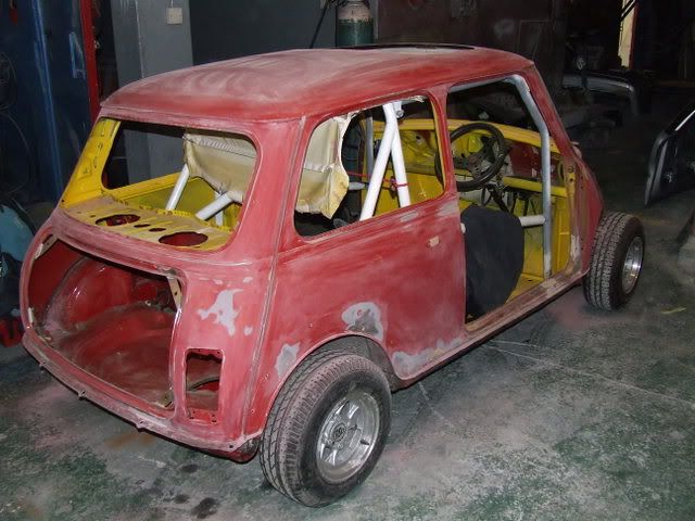

here are the first two pics taken yesterday after i started to rub down. i was given a block and a shed load of 180 pads and told to go over the whole car, i could not believe how many colours it had been ! where ever i found inperfections put a bit tape on, so off i went...i asked for an orbital but they didnt trust me not to fuck up the body work lmao !!!
these pics were about two hours into the job, i had gone most the way around with the 180, Paul then came around and found a million further little imperfections and got out his filler, i was a lil confused that he did not take it back to bare metal where he was applying filler, but he seems to really know his shit and the quality of the work coming out of the booth was flawless. anyho he filled it and told me to rub it down with 80 grit, well did that and with great excitement told him i was done......he just laughed and handed me a box of 350 grit discs and said (right the whole shell in this now please) i was gutted !! well 0900 - 1700 and when i left last night the car was ready for primer, i masked off all the windows and got rid of all the dust. the car is in the oven as i type and i am waiting for a phone call to go back today to rub back the primer :( however he said i get to use the orbital today :)

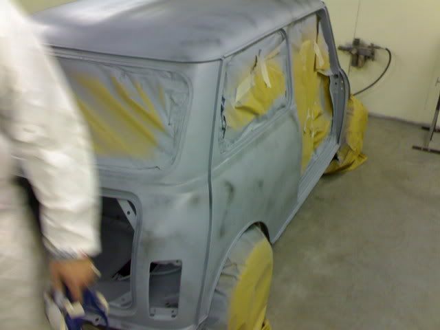

well the car was super late getting into the booth, patterson ford had f***d up a shipment of cars so Paul was banging em through to get em rite prior to dispatch am tommorow !!!!!!
I rolled her into the booth and closed up the final door then the majic began. three coats of hardened primer on the outside, and a quick flash over in the boot. then once dried (which was like minutes as the room is set to 80 deg ! Paul sprayed this black stuff over, and before i could hit him he explaned it was a guide coat, going on to say "The hard part starts here":( am at work for a couple of weeks so he will plod on 4 a while. then he will paint the full car white then straight on with the yellow before it dries, let it harden then he will do me white roof after. and finally a load of clear coat to finish cant effing wait !!!! here are the pics

the black paint he applies is to highlight any small scratches marks so you can flat them off

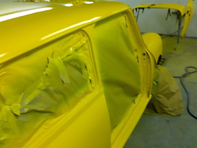

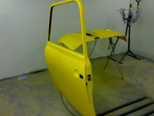

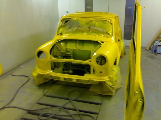

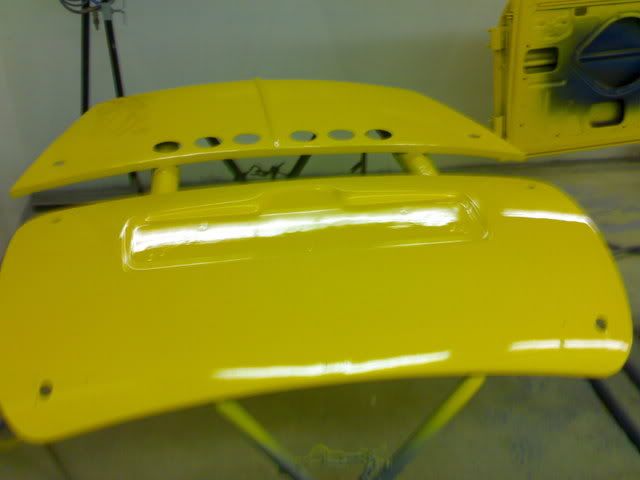

well i went in today to see what the crack was, and paul had boxed on with the job the shots taken were 5min after paint going on. the roof needs keyed back and the diamond white put on, all in all it should look sweet. Pick her up Tuesday after she has baked and hardened, then i get to put the shiny shit back on !!

should mention the yellow looks different in real life there was still shit loads of particles in the air, and me shite camera phone strikes again ! will take some digi's on Tuesday once i get the shiny bits on in the sun *wink*
