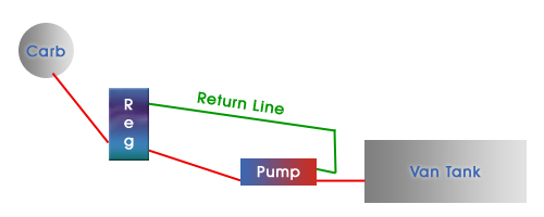

i have a van and i have the external pump. external pumps are better in my opinion than spi or mpi tanks (as you know they dont fit in a van) but the return should go to the tank. returning to the back of the pump does work but is not the best idea. |

do you have any pics of how you ran your fuel lines?

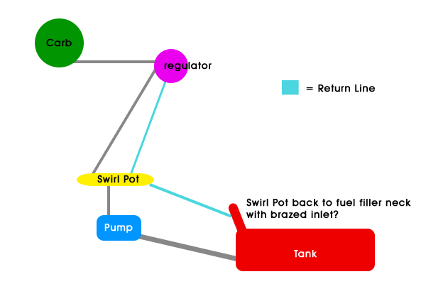

You may also want to think about the pick up pipe too, when low on fuel and cornering hard it will be drawing in air instead of fuel. I'm going to use a fuel swirl pot.
sorry would you mind explaining on the tank where the pick up pipe is and where/how you'd fit the fuel swirl pot... im a bit of a newbie when it comes to fuelling... any pics of these van setups would be awesome! Edited by thomen on 20th Sep, 2007. |

and bat! sorry just wondering so youd run something like this?

many years ago mine returned via a "T" to the back of the pump. it worked perfectly! on top of this my metro turbo pump was mounted at the top of the inner wing!

so is the general concensus to add a return line to the tank around the base of the fuel filler neck.. when i got my tank recod i think they cut the filter out... and would i need to run a swirl pot also?

you must have a filter before the pump! |

ok so it'd go tank->filter->pump->regulator->return to tank (braze fitting around filler neck)
1303 Posts Member #: 30 Post Whore Epsom, Surrey |
20th Sep, 2007 at 02:55:00pm
you dont need a swirl pot and yes you need a metro turbo fuel pump. The metty pump can be found in the breakers yard on rover SD1's or use any injection type pump with hose type connections |
