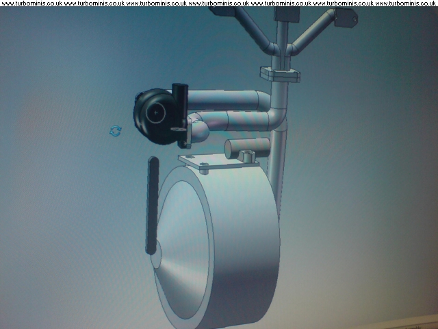

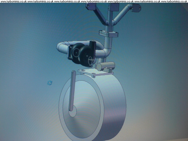

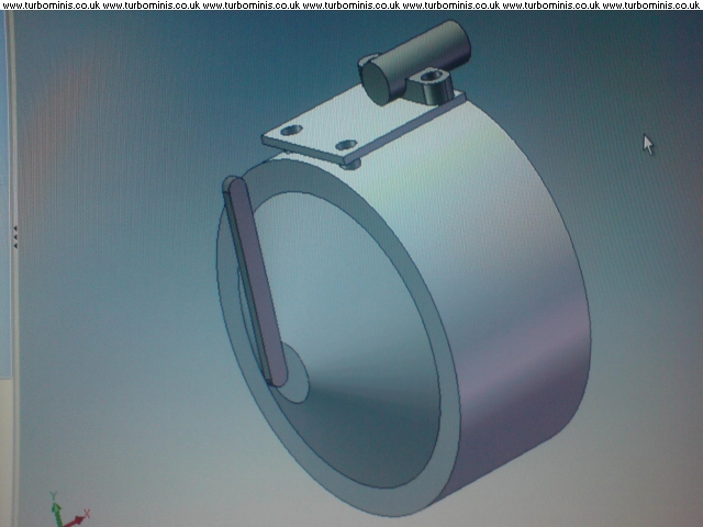

chappers
124 Posts
Member #: 1428
Cleveleys
Right i literally had a dream about the problem last night, yes i even dream about minis!!! LOL
Iam going to use the preverto clutch arm and slave cylinder, but make a plate that holds the slave and bolts to the exising holes on the transfer case, but moves the slave furether away from the arm thus clearing the manifold and downpipe, and just cut sleeve and weld the rod from the clutch arm.
Will draw it up on Solidworks and post up the result.
998 turbo in progress.... DONE..........KNACKERED LOL
chappers
124 Posts
Member #: 1428
Cleveleys
Please excuse the crudity of the model, but you get the jist.
i'll just step the slave cylinder back enough to clear manifolds. not as extreme as Janspeed's 80's conversion.
