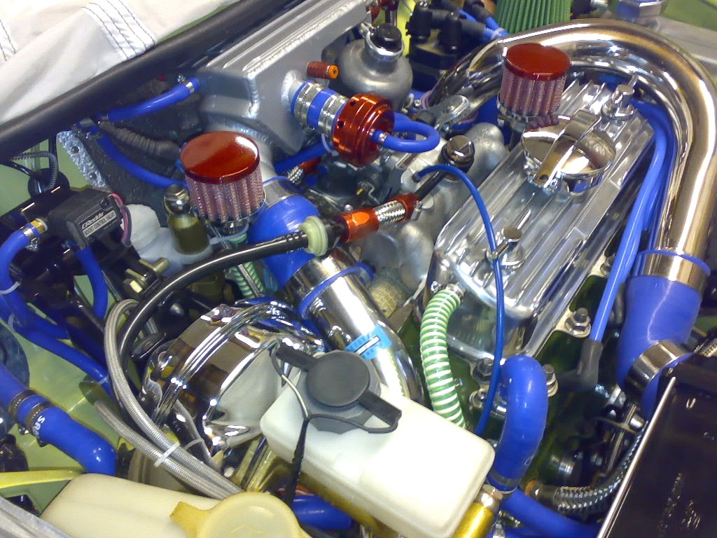

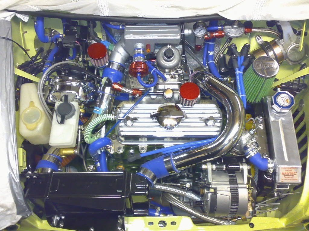

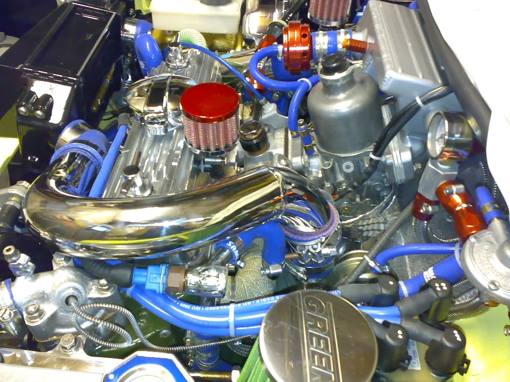

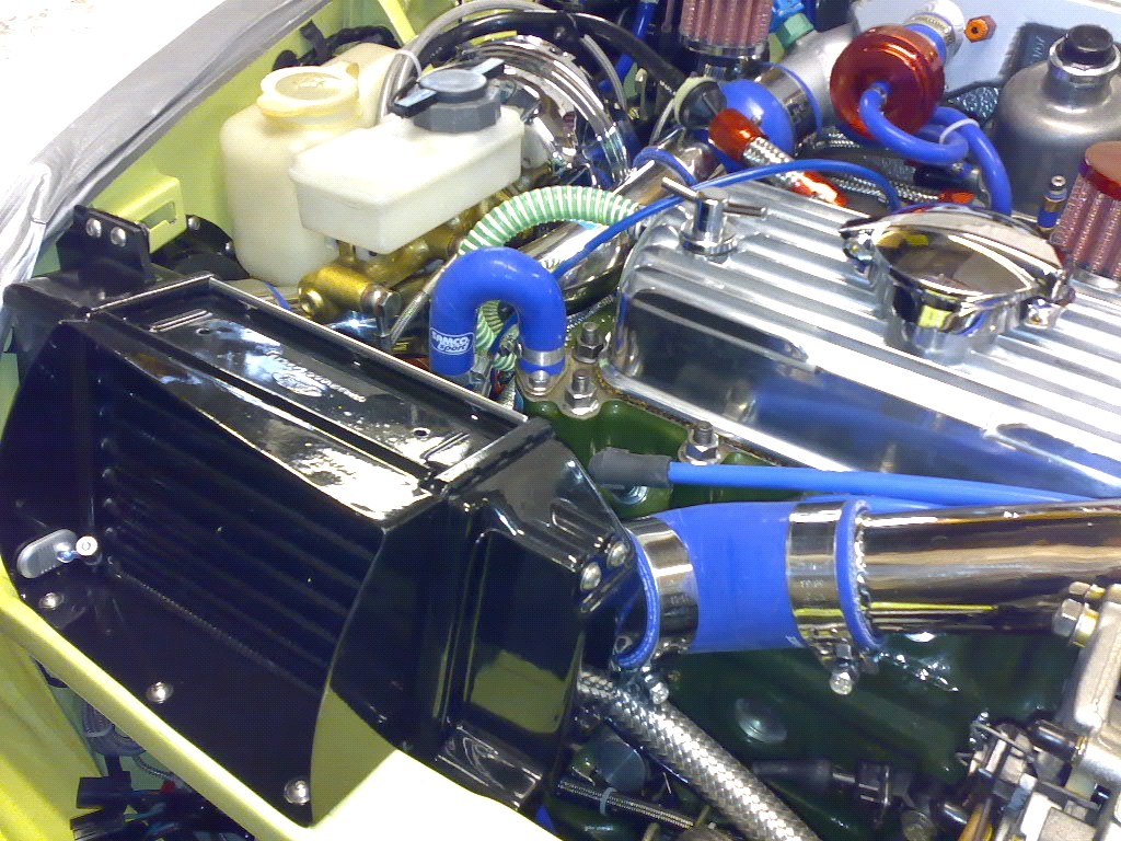

Heres mine.
Kind of.
Nick
4828 Posts
Member #: 154
Midlands
really really old one of my old car.
just make sure you try and keep the bends as smooth as possible.
